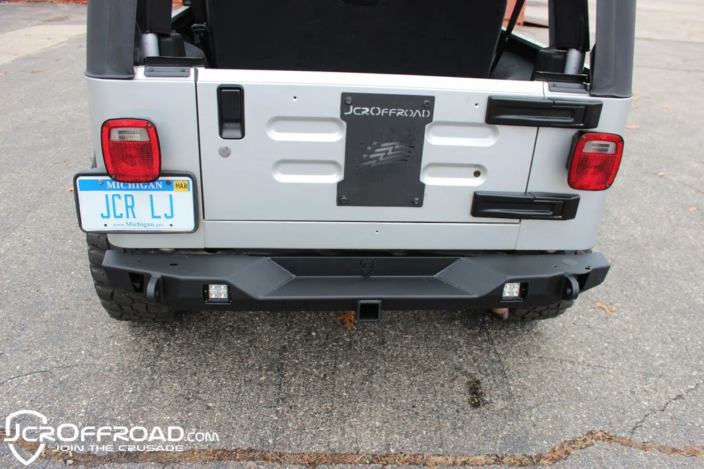

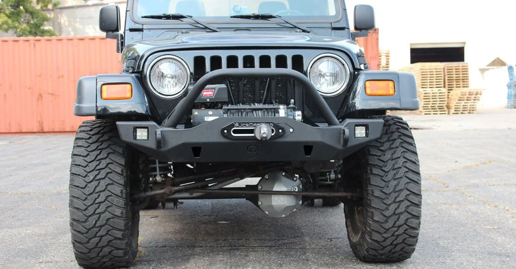

Anyone done it? I really like these JCR ones, The crusader mid width for front
and the Crusader Rear

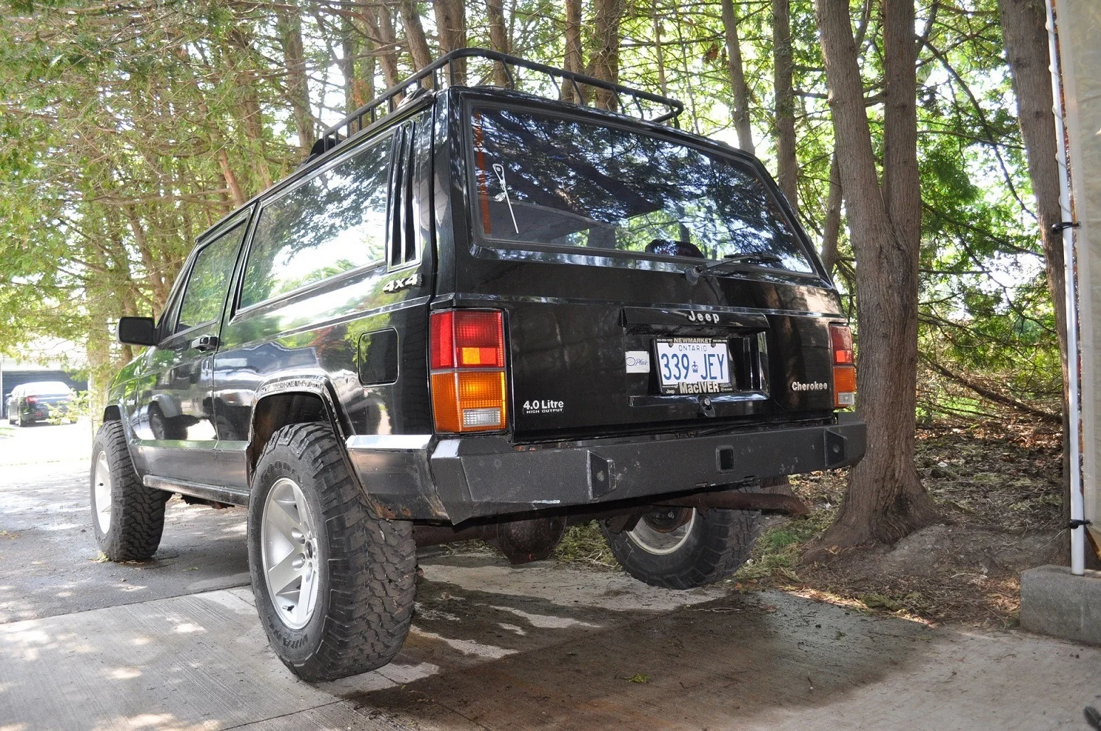

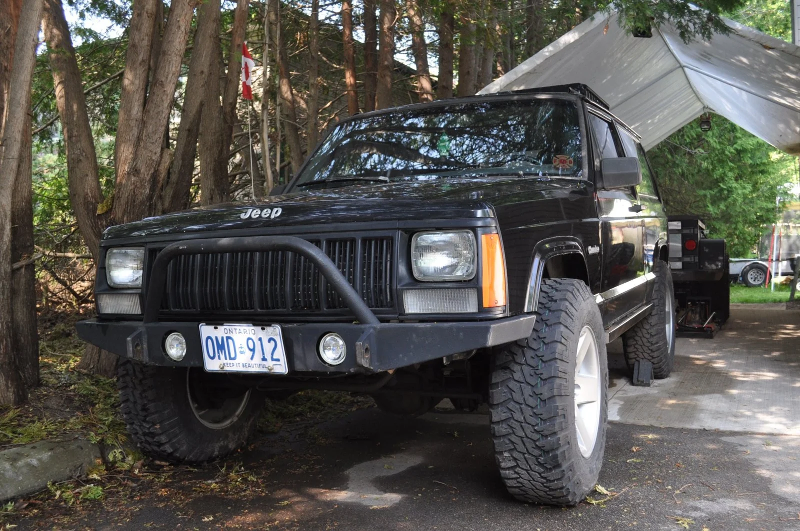

I have JCR bumpers on my XJ. I bought them from a guy who had them shipped "flat" to Canada. Being shipped flat was a big savings. He said they were very easy to bend and weld together. He just clamped them to a bench then clamped a pair of vice grips to them and manhandled them into shape.
They have some nice designs (simple in this case) and I was happy to get them from him. If you're into XJ's here they are. I have some adjustments to make to the rear one but you can get the idea. I also have to fabricate some metal flares and do a few other things to how my XJ is seen attached but it's coming along.

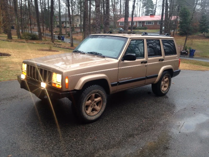

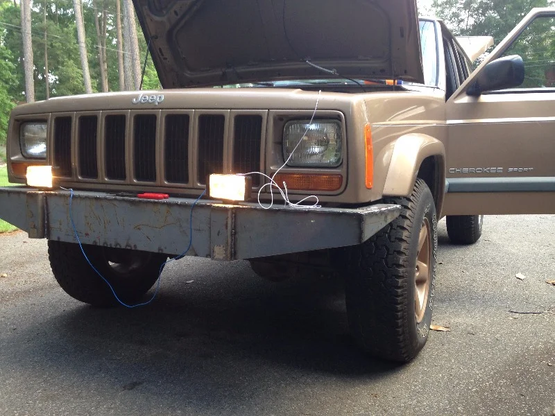

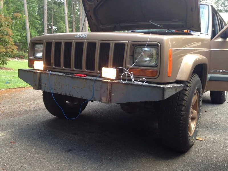

I built the front bumper for my old XJ, nothing fancy, I found a real basic plan online for a winch bumper and went off of that. I just made the two main mounts, bolted them to the Jeep and built the rest of it on the Jeep. It looked pretty good and all I paid for was the fog lights and the paint, it was all 3/16 scrap steel. I'll post more pictures when I find them.
Reactions: Chayton and Mike_H
