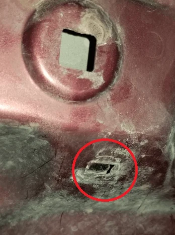

Our Jeep never had one, so not even sure how the clip is supposed to mount. I bought a replacement spring steel clip that broke when trying to put it into the hole that I thought it should go in. Anyone have a picture of how the clip mounts/works? How about the later models? They use a little plastic clip? can that be used on early TJ's?

So the ebay link said it should fit, but our hood does not have the rectangular hole for this style of clip so buyer beware.
I decided to design my own and during my search online of how the original clip mounts, I came across this one in Thingiverse that uses the original hole for the spring clip:
https://www.thingiverse.com/thing:2852748
Printed one up:
Added a 4mm rivnut:
Job done, it works perfectly:

Isn't that square hole the one that holds the prop?
The later models that use the square hole has two square holes. You have to put it in the right one. The (Ebay) clip worked fine on my 06.
