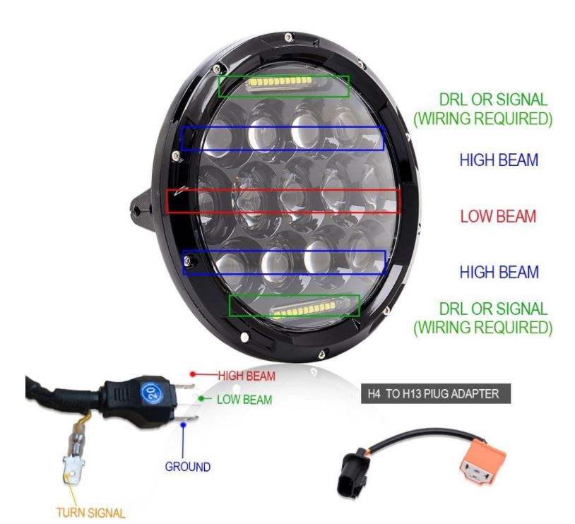

I installed these new headlights last year and didn't bother hooking up the DRL's right away. Now I'm getting around to doing it and have a question as I know next to NOTHING about wiring..... Can I just run the wires to the fuse box behind the glove compartment and use a fuse tap into the parking lights? Or, is there a fuse that is on when the Jeep is running I could tap into?
Any suggestions, comments, etc. extremely helpful! Thanks guys!!
Yes you can use a fuse tap but you need to meter which power is switched. Just did mine on the weekend.

I have the same headlights, or similar. I used the "spare" switched hot wire behind the glove box to hook up my DRL's.
I installed a fuse holder and ran a wire under the dash and through the fire wall. I believe it is a blue wire, but you can check the FSM to make sure.

My jeep is at the shop getting the lift put in so I can't check, but regardless of what fuse anyone tells you, put a meter on it to confirm that the power you are drawing from is actually switched with the ignition. Very straightforward. You'll need that and a fuse tap.
