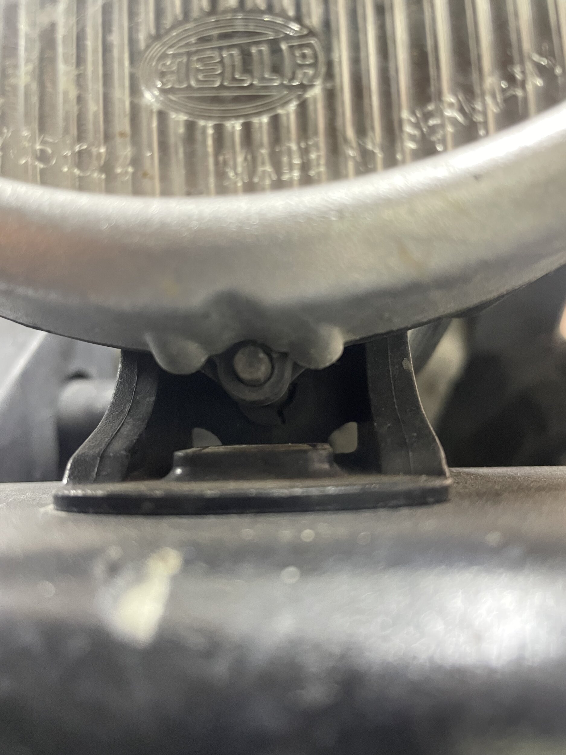

I’ve got Oem fog lights, which I’m trying to adjust. Is there a tool I don’t know about to loosen this?
Never saw a TJ fog light bracket like that before.
But that’s a security torx. It requires a torx bit with little hole in its center to avoid the pin in the center of the socket.

That’s what I thought but security torx have 6 points and this has 5.
Learn something everyday. I guess they do make 5 point as well. Will need to pick up one to fit. Thanks.

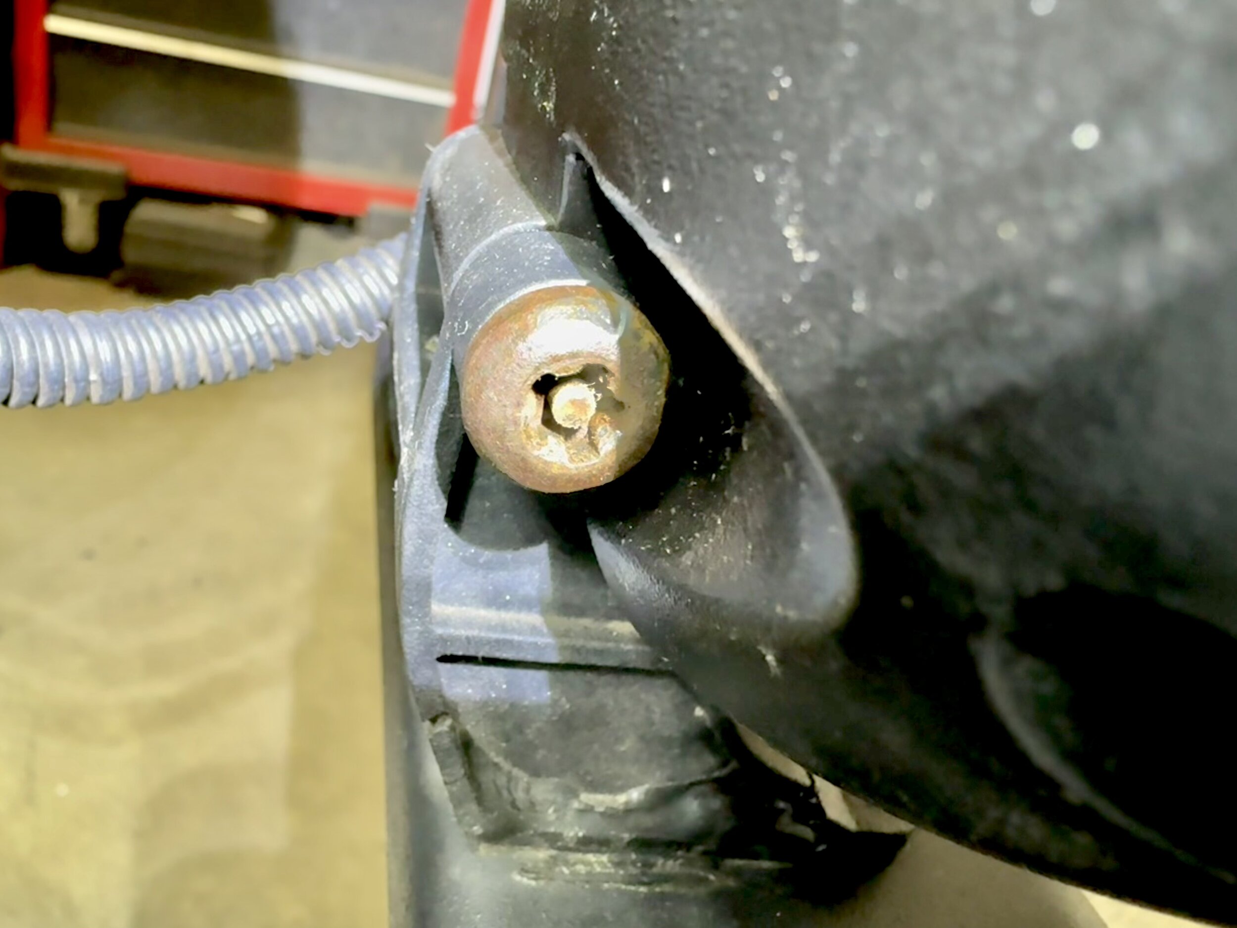

I was just wondering this same thing for my fogs. Did not know there was a 5-point security torx.
took a proper picture of the screw location for future reference on the 2005. its not an obvious noticeable adjustment screw.
