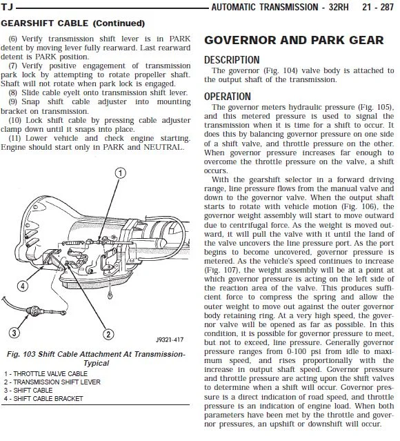

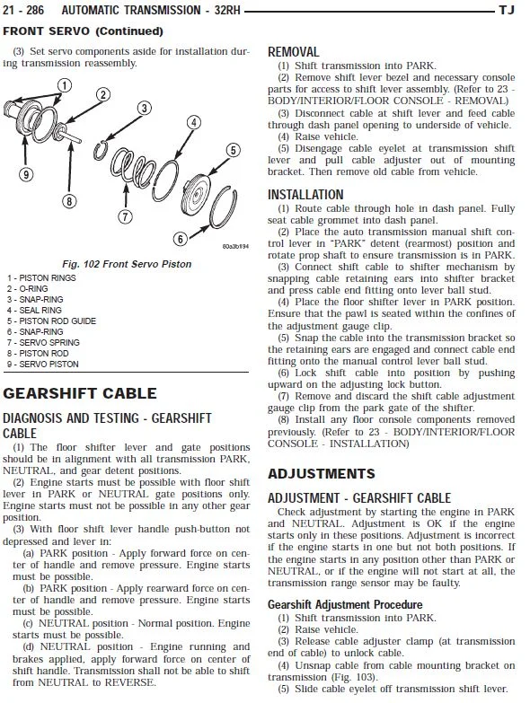

Hello, I'm attempting to remove my 32Rh auto transmission to replace both the flexplate and torque converter.
The last hurdle is the shift linkage. How do I remove it?
Isn’t this exactly what I explained yesterday? Apologies if that was to someone else.
Reactions: H_E_H
Reactions: H_E_H
@ hear - yes, you did explain it, but it's just not making sense to me. The link to your thread helps a lot, though. Those pics really help. I've removed the bolts and nuts and am attempting to take off the brackets now. (light is charging) Thanks for the reply. Greatly appreciated
@ Jerry - yes, I've referenced those pages before but the information just doesn't click for me. I need more visuals or a video of sorts. Thanks, though!
