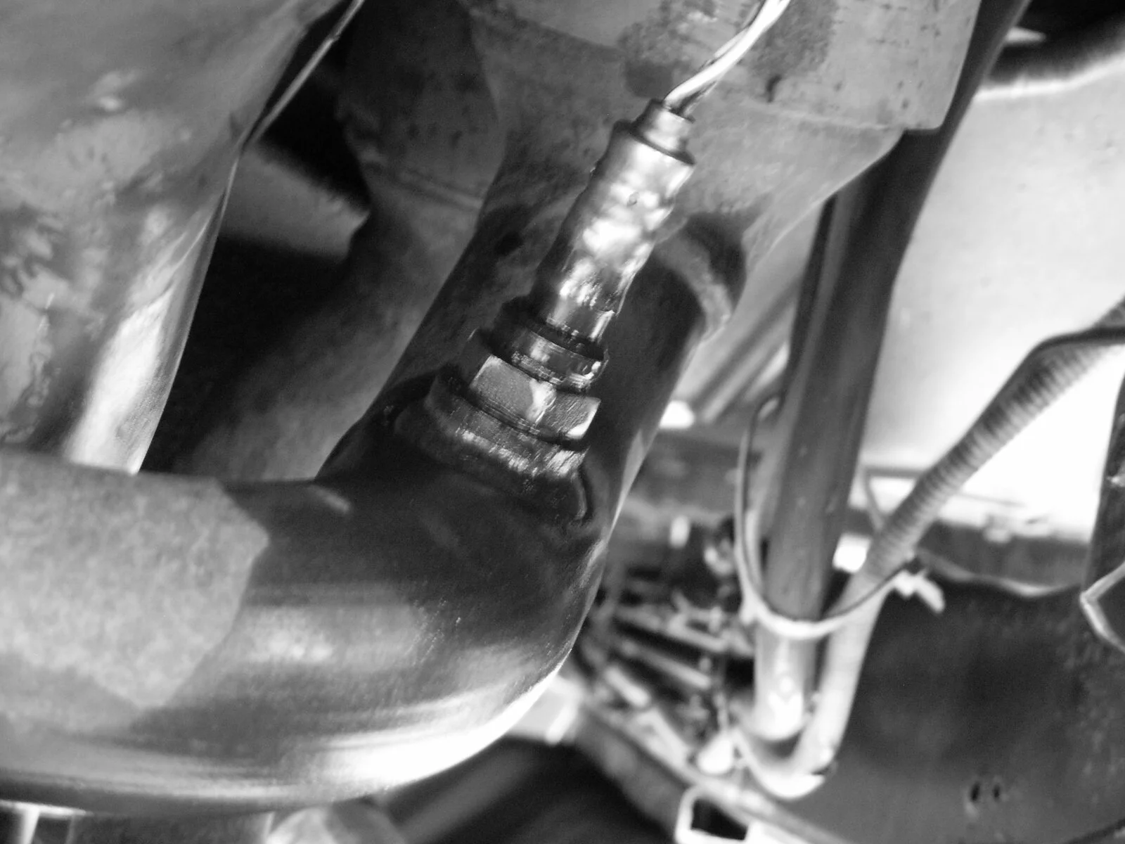

I just did this job and can hopefully help. I used the Tekton socket as shown in another post this thread (3rd pic in from left). Several days before attempting to loosed I soaked the base of the sensor with Kroil. I have found Kroil to be superior to all others as it creeps into the threads via capillary action. I managed to loosen three of the four sensors and squirted a little more Kroil on the threads as I snugged them back tight as I was still waiting on two sensors to come in. Bank 1-Sensor 2 downstream front manifold was tight and several attempts to break loose were unsuccessful. I could have muscled through but really didn't want to screw anything up so I applied more Kroil, tried loosening and repeated over several days. Finally, after about the third or fourth day I broke it free. Squirted more Kroil on the threads and loosened and tightened in order to distribute the Kroil all around the threads. Mind you, I used a 3/8" ratchet with no cheater bar and used a lot of patience. Oh yeah, I yelled every profanity I know and came up with some new ones in the process. Here is a pic. of the bastard.
