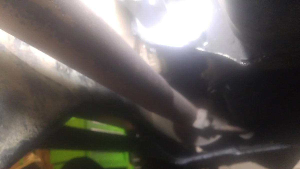

can anyone tell me how many o2 sensors I have and where they are?...2000 non California …..I can only find 2....right before the cat and right after...and o'reillys is giving me part #ntk 23506...I thought it was ntk or ngk 23122 for the upstream

it was manufactured in sept. of 99...I don't know about the pre cats, from the ex. manifold to ex. tip there is only cat and muffler with o2 sensors before and after cat
oops forgot pic
I just got off ngk website,,,it doesn't show 23151 anywhere for my year.... it says 23122 for b1 s1 non cali ...federal emission

Take a photo of the downpipe. Are there two pre-cats or one?
Until you answer that, no one can help you. I don't mean to be rude, but that's going to tell us if you have 4 O2 sensors or 2.
I feel a little dumb, but what do you mean by downpipe...nearer to the exhaust manifold?
