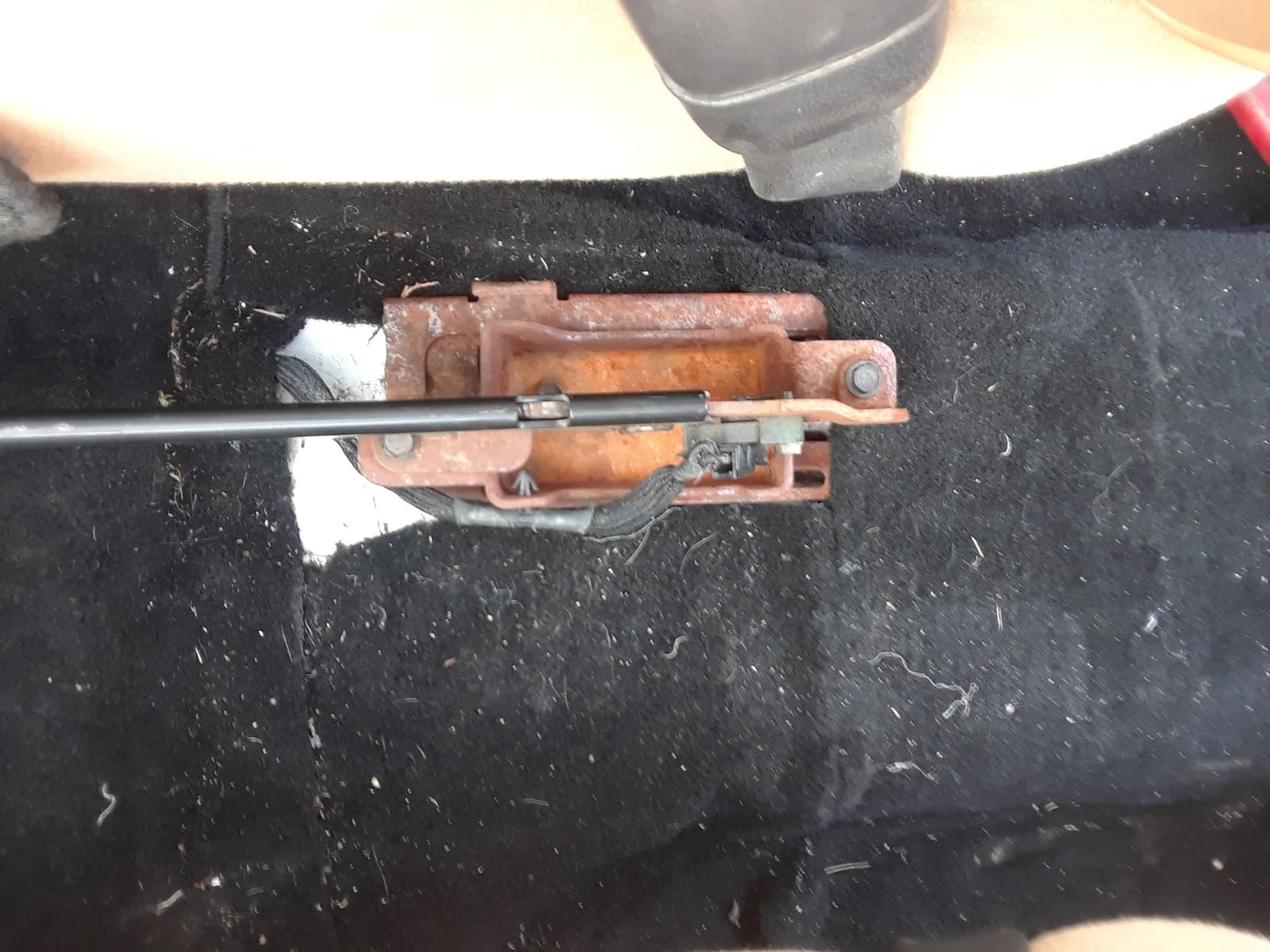

My 97 3speed auto got caught up in a fixed/not fixed cycle with Eagle Transmission.
I'll spare the rant only to say they had my jeep off and on for 2 months this summer and it's got rained on until I was able to cover it but this developed as a result..
Do I hand sand the rust off, then apply primer?
I have no experience in rust removal
The easiest way would be to remove it entirely, media blast it (or find someone locally who will), then paint it with something like POR15 or similar, then put it back on. That's what I would do at least.
You could also wire wheel it, but to get the rust underneath, you need to take it off. And if you're going through the trouble to take it off, may as well just have it media blasted IMHO.

You can spray it with Rustoleum Rust Reformer and then give a coating of clear. That rust reformer really works but it needs paint to seal it. It won’t do any good,though, if you don’t cover all sides and get it in the nooks and crannies.

You could hit it with a rust converter then paint as/if you like.

I personally would remove it, soak it in a bath of either EvapoRust or a home solution w vinegar and salt (forget the ratio, but can be found online) and then prime + paint it. After its mounted, I’d probably lighty hit it w CRC corrosion inhibitor or a light coat of Fluid Film, applied w a rag. Do you have a center console that covers it, or is this completely exposed? Im guessing the latter.

My experience with Rustoleum products has been good. Years ago I built a utility trailer from an old truck frame and steel tubing. I brushed on a Rustoleum product called "Rusted Metal Primer". It sealed/neutralized the rust and filled in some of the small surface imperfections. I topped it with another Rustoleum product. I sold the trailer to a friend, but, years later, the paint still looked good.
The primer I used only required wire brushing any loose scale for prep, no sanding.

If that gets hidden I don't think I'd worry about it at all, just lube it up with some oil to keep it working.
If it stays visible it probably should have been painted from day one. Even though it probably came from the factory unpainted, it couldn't have looked too good that way even before the rust.

No offense or disrespect intended, but I'm pretty sure the rustbelt boys are rolling their eyes at this. I mean, I get it. Rust has to start somewhere. But I think you could spray this down with some oil and it'd be fine. From where I'm from (upstate New York), that wouldn't even qualify as rust. More like "discoloration"... ;)

I believe the term you're looking for is "patina". :beer-toast1:

POR-15 is perfect for that.

No Offense KC. If you really want to fix it...or at least the way I'd do it, do this. Remove it from the vehicle, sandblast it (I have a cabinet) prime, the paint. That particular bracket is raw steel from the factory though, so its not deemed mission critical. Rust isn't like chicken pox...it isn't going to spread from that bracket to your tub. Now...if you happen to scratch the paint through to raw metal in the process of removing said bracket and it gets wet again...You tub will start to rust. The scratch gives the steel exposure to oxygen (oxidation).

I gotta be straight up and mention, being from the salted, miserably cold state of NJ, I too thought the same thing you posted in your first line. And agree 100%, some type of oil, lanolin or petro besed, would be fine. I’m just a bit ocd and would probably clean and paint coat it too, before the oil -lol
