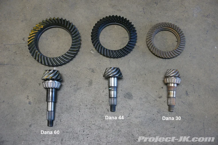

On the JK forums, however, going over 4.88 is often considered risky, and many members post pics of broken gearsets. I thought JK gears are significantly larger than TJ gearsets? Or is it that more JK guys go above 35s on stock axles?
So what affects gear reliability most? Is it the tooth count or size of the R&P (would a 5.13s in a Dana 30 = 5.38 in a Dana 44), or something else entirely?
JK R&P size comparison:
I'm also trying to find info online on tooth count differences, if anyone has that info please do share!
I think the width of the teeth has a lot to do with the strength. More teeth on the same diameter gear (higher ratio) means each tooth is narrower; fewer teeth on the gear (lower ratio) means the teeth are wider (and stronger due to their larger width).

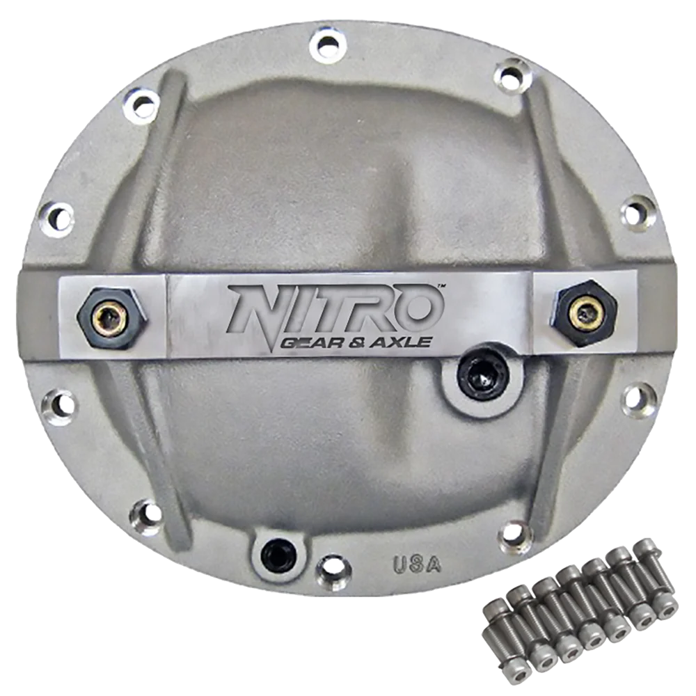

Another often repeated claim is that a heavy-duty diff cover can "stiffen" the housing and help prevent gear deflection. Anyone have direct experience with this?

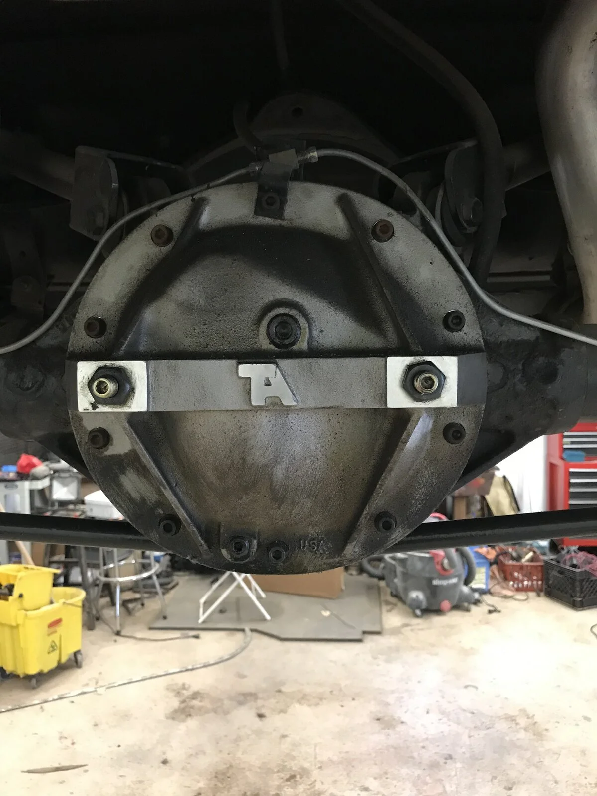

not a jeep dif but are you referring to something like this- note the left and right "bolts" that aiding to reducing carrier deflection at the bearing caps
Never seen that before. The claims I heard were around an aftermarket cover like ARB, a thicker cast iron diff cover.
conceptually i understand the design that I have on my chevelle could help with the carrier support. Just a stiffer cover I think would work with the idea that all sides of the opening are boxed & robust material vs one side being thin tin. How much it makes a difference🤷‍♂️, i will defer to someone with breakage experience.

Well they do make a dana 35 with the -girdle support-which is the key search word to see these.
