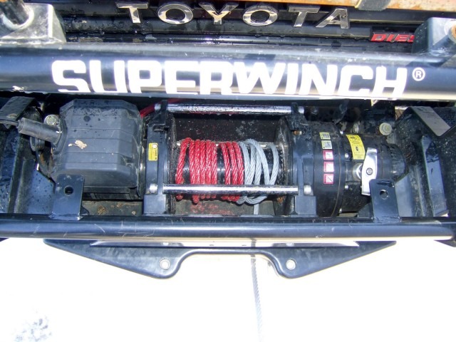

Premise Two: Pull out all your rope except for 10 wraps.
Let’s assume you have a 9,000-pound winch mounted to your vehicle. That does not mean that the winch will always pull 9,000 pounds, but instead that it is capable of pulling that much under certain circumstances. A 9,000-pound winch is rated to pull that much with a single layer of rope on the spool. As you add layers you effectively increase the diameter of the spool and decrease its pulling power. An average 9,000-pound winch holding 100 feet of rope will have at least three or four layers of rope on the spool when dressed. Each layer reduces the pulling power of the winch by approximately 11 to 13 percent. So at the end of an 80-foot pull, your winch’s power is reduced by half. By pulling out all the rope to expose the spool surface you have all the power intended by the winch design. Make very sure you leave 10 wraps on the spool since this is what takes the load of the rope on the spool, not the attachment fastener (bolt, Allen key, screw, etc). Most manufacturers suggest leaving five to seven wraps; I use 10 to be safe.
In addition to the power issue, when the rope forms a second layer of wraps the rope will try to cleave its way through the ropes below it. The physics of pulleys explains that when force is exerted on a pulley the force is concentrated at the center of the pulley, in a winch’s case the center of the spool. Imagine you take one of those tubes of cookie dough and wrap a wire around it. If you anchor one end and pull on the other the wire will cut straight through your dough; this principle is the same on a winch, but the rope will slide, cut, kink, burr or melt its way through anything under it. The result is not just one burr, kink, melted spot (synthetic rope), but many more depending on the position of the rope and the number of layers. So again, pull out your rope to the last ten wraps. If you are forced to lay rope on top of itself then you must make sure the wraps are very tight and the layers are solid. Re-dressing your rope after the pull is not as much of an issue. You can get it in anyway you like when it is under minimal or zero load because the next time you use it the rope will be pulled back out to the best starting point.

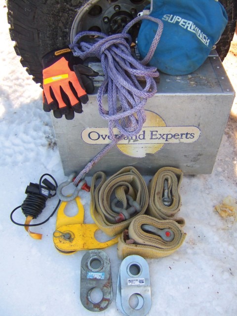

Winch kit
In order to even contemplate using a winch, you will need several accessories. A fairly well-supplied winching bag includes the following: proper gloves; three D-shackles (9,500-pound working load or WL); three 3-inch straps (20,000-pound WL), three 5/16-inch pulley blocks (19,250 pounds WL) and one 50-foot 5/16-inch synthetic rope extension (13,700lbs WL). I prefer to use synthetic rope, which is stronger per unit measurement and lighter to carry. Synthetic rope does not burr or rust. It has less mass, and therefore holds less energy when it parts—less energy equals less damage. However, synthetic rope insulates the spool of the winch, compared to metal which conducts heat way from the spool. Winches that have the brake in the spool, or are designed to dissipate heat at the spool, can heat up dramatically with synthetic rope. The heat will compromise the winch and the rope at the same time. Ask your winch manufacturer about this, and also consult the synthetic rope manufacturer.

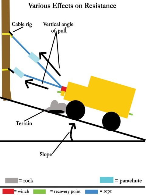

Several independent factors combine to determine the difficulty of any winch recovery:
General vehicle resistance
Tire pressure and construction, and general friction in the drivetrain can add up to a good amount of added resistance. How much? On a theoretically perfectly flat, hard road with a perfectly frictionless drive train and frictionless tires, etc, the vehicle will need just a minute amount of force to overcome its potential energy. But on 33-inch mud-terrain tires at 15 psi, added to the resistance of bearings, seals, rotating differentials, etc., it starts to add up.
Resistance of terrain
The substrate under the vehicle has a great effect on resistance in any recovery. All things being equal (tire pressure, slope, etc.) flat, firm ground has the least effect; deep mud or snow has the greatest. A 5,000-pound Land Rover D90 on firm, flat ground can be pushed by a human because there is not much resistance; the person need move perhaps only seven percent of the total weight, or about 350 pounds. However, plop the vehicle in a mud hole and we could be looking at 2,500 pounds or more. As a general rule, figure you need to pull seven percent of the weight of the vehicle on firm ground, 50 percent or more in deep mud or snow.
Resistance of slope
Slopes obviously add resistance to the load on a winch. The steeper the slope, the more of the mass of the vehicle the winch will need to move. A vehicle of 5,000 pounds on a 35-degree slope creates a resistance of approximately 3,000 pounds due to the slope alone. As another general guide: A zero-degree slope has little effect on the resistance, which is determined instead by the vehicle’s inherent resistance and the substrate. On a 45-degree slope (also called a 100-percent slope, as it rises one unit of measurement for every unit forward) you’ll be pulling about 75 percent of the weight of the vehicle, and by 60 degrees you’ll be pulling the entire weight.
Winching angle
Ideally the winch rope should leave the fairlead at a 90-degree angle to the spool. This is known as a straight-line pull. As that angle changes and the line is no longer coming straight off the spool, you will encounter problems. First, power is lost due to the angle itself. Second the diameter of the spool is effectively increased, so more power is lost. Finally, you risk bunching up your rope to one side of the spool. The result is increased spool diameter (reduced pulling power), and an increased likelihood of cleaving the rope under your incoming wraps. The loss in power from the angle is less of an issue than the bunching effect.

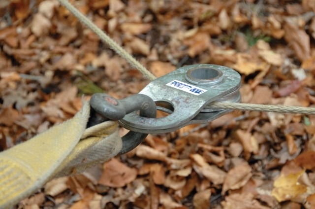

Endless debate rages in the 4WD world regarding pulleys and the advantage they give to recovery situations. I hope the following helps clear up misconceptions.
It’s been noted repeatedly that a pulley does not offer any mechanical advantage unless it moves with the load being shifted. For example, if you try to lift a weight by hand by running a rope from the weight through a pulley on an overhead beam and back down to you, then pulling on the rope, you gain no advantage whatsoever. Likewise, if you run your winch rope from the winch through a pulley attached to a tree, then straight back to a fixed anchor near your vehicle—say another tree—you have gained no advantage. In fact, if your vehicle is putting 5,000 pounds of strain on the winch, running the rope through a pulley and back to a fixed anchor very nearly doubles the strain on the tree and pulley while doing you no good. That’s because the tree and pulley experience 5,000 pounds of pull from the winch as well as, in effect, 5,000 pounds of pull from the fixed anchor. Actually, by doing this you’ll decrease your mechanical advantage by a factor determined by the diameter of the pulley, the inherent friction in the pulley, and the actual angle between the rope on either side of the pulley.
Let’s look at this more closely. As the angle between the “two” ropes, meaning the rope on one side of the pulley compared to the other side (yes I know its one rope, but it makes it easier to explain this way) goes from zero (i.e. straight through pulley) to 180 degrees (a u-turn around pulley), the strain on the tree (along with the tree saver, D-shackle, and pulley) increases. At 90 degrees redirection angle the force on the tree is almost 40 percent more than the total load, or around 7,000 pounds from the example above, while at 180 degrees it’s 100 percent more.
In all the above cases the load on winch itself will only be as much as the strain on the line, 5,000 pounds. But you have not increased your pulling power at all. However, a redirected pull to a fixed anchor still has its uses: More rope off the spool means more power, and the rope adds up on the spool slower (1/2 the rate) than if you were anchored to your own bumper. This “slower add up” allows for a longer pull (twice as long) with less line on the spool—i.e. more power for longer.
Now lets rig it differently. If you run a rope from your winch to a pulley and back to your vehicle, and the two lines are as close as possible to parallel, now you have increased your mechanical advantage. The reason is that both the winch side anchor and the bumper side anchor are moving and shortening. They are both doing work or applying force. This makes the load on “each” rope half as much. You do not get a precise 2:1 advantage, but you very get close if the ropes are parallel. So your winch now has two times the potential pull power. Yet your pulley/strap/D-shackle on the tree will not be subject to additional force. The pulley on the tree becomes the “moving pulley” and this, in this example; gives a 2:1 mechanical advantage. The speed of pull will be reduced by half.
You also gain a 2:1 advantage if you attach a pulley to the bumper of a stuck vehicle, then run a winch rope from a recovery vehicle through the pulley and back to the bumper of the winching vehicle. If you add another pulley to the winching vehicle, and run the rope through that and back to the stuck vehicle, you have gained a 3:1 advantage. In this situation, counting the number of lines between the stuck vehicle and the winching vehicle will give you the mechanical advantage.
Here’s an easy way to remember all this: Just count the number of lines that get shorter with the movement of the vehicle being pulled, and you’ll have your mechanical advantage.

Winch kit
Resistance of slope
Winching angle

As a spotter I prefer a winch with a very open spool, so I can see if kinking, over-layering, or bunching occurs. An open top also allows me to get my hands onto the winch to sort out a messy dressing, crosses, wedges or pinches. If the pull is a long one, at some point there will be too much rope on the spool. Avoid this if possible. If you are still stuck, the winching must be stopped, the vehicle must be stabilized (move preventer or chocks, etc), and the tension taken off so the spotter can pull out rope and reset the rig with fewer layers on the spool. The best way to do this is to add a pulley sub-rig to your main rig, and re-anchor to another spot some distance away. The new anchor point is far enough away to “un-layer” the spool. Attach the hook/thimble as you would any other anchor point. Reassess lines of attack, add another parachute rig, step away, take up slack, check the rig, and continue winching.
When you see the rope bunching or layering you will need to redress the winch. Take off the slack (stabilize vehicle, etc.) and signal hands in. Disengage the winch to free spool and pull out the offending portion of rope. Let the rope fall in a pile on the ground away from your feet. Do not let anyone grab, coil or walk off distance to keep the rope neat, there is no need. Just lay it onto itself; as long as you take it back up in reverse order there will be no tangles or knots. Once the mess is clear, engage the winch to winch in and step back two times the stopping distance. Remember to keep constant tension on the rope—especially with metal, since it likes to spring off the spool due to metal memory. Lean your body back against the rope in your hands. Give the signal to winch in, feed the rope, hand over hand without letting it slide in your gloved hands, into the winch in a neat even wrap layer. You need to zigzag the rope as you hand it in so the spool is neat and uniform. If you are finished winching and are just replacing all the rope, you do not have to be too neat since that line will be coming off the next time you use it. However, it is nice to have a neat redress to keep a minimum of the rope’s surface area exposed, since metal rope will rust, and synthetic rope will degrade in UV.
