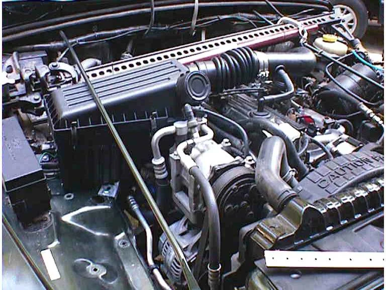

I am returning AC to a 2002 4.0 sport that the previous owner removed. I can't seem to find any reference to how the compressor mounts to the block on the lower driver's side. Is there a bracket?
The compressor mounts to the passenger side, above the alternator.
Thanks Tworley my lines run across the block down to the driver's side - My 98 sport looked like that picture
Ah...interesting. I thought the compressor was on the other side starting in 03. Learn something new everyday.

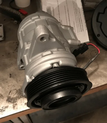

There are a few different mount styles, I have a brand new compressor that I could sell you for a discount if it ends up being the style that you need. I bought it from rock auto, then realized it was the wrong style after the return window closed:
