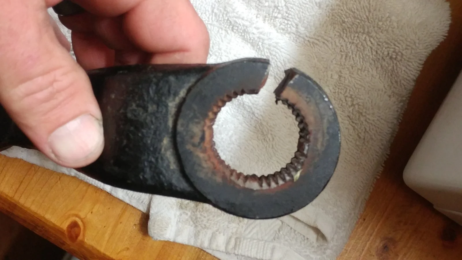

Ever broke a pitman arm?
We did on "top of the world" Moab. Not fun waiting for a replacement... nor was it fun for those aiding in the ordeal. But it made the day more adventurous... and, in the end it turned out okay and a great learning experience. Now I carry a spare.
Wow... now I'm really taking this thread the wrong way. :censored:
