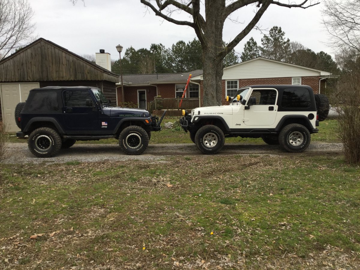

Here they are . The white one is the2003, the Blue 2006.
The ladder behind I’d my dad in laws ...let’s hope he doesn’t fall off of it....again. Dislocated both shoulders this past summer.
He’s an awesome guy....really is.
Well , let’s try again on a pic.
Well , let’s try again on a pic.View attachment 141957
