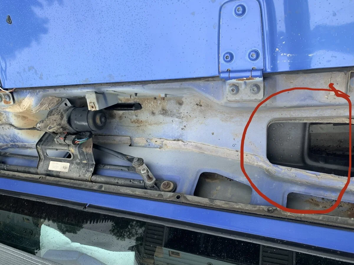

I took apart the cowl and began to inspect it and quickly found what I thought might be the issue. The double sided tape used to secure the black plastic sections to the bottom side of the cowl had finally given way to 23 years of sun and elements. This was allowing water to flow right into an open hole leading directly into my HVAC box, resulting in a short in my blower motor resistor and subsequently melting its harness into unrecognizable plastic art.

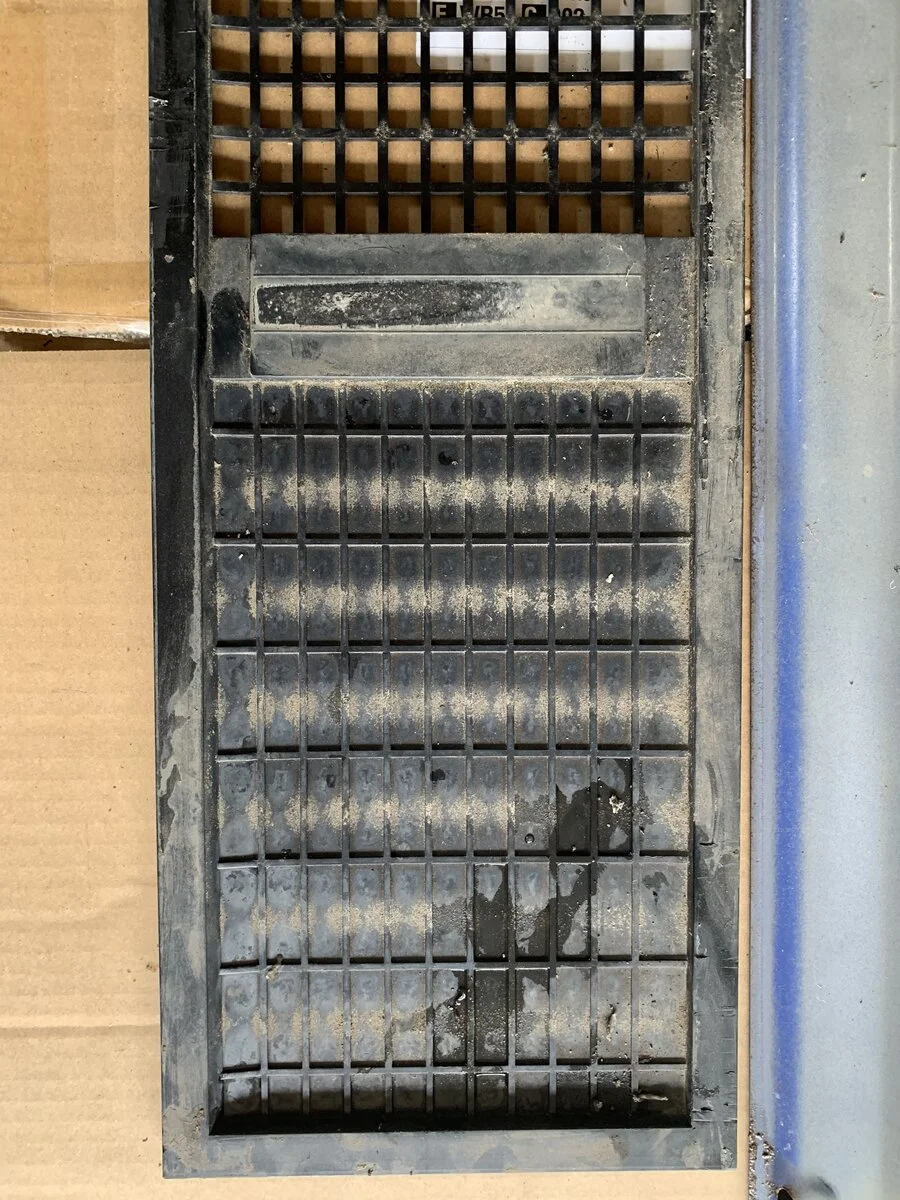

Taking the cowl into my shop I began to slowly and carefully pry all of the plastic guards away from the cowl, leaving a lot of still STRONG double sided tape behind on both the plastic and the underside of the cowwl.

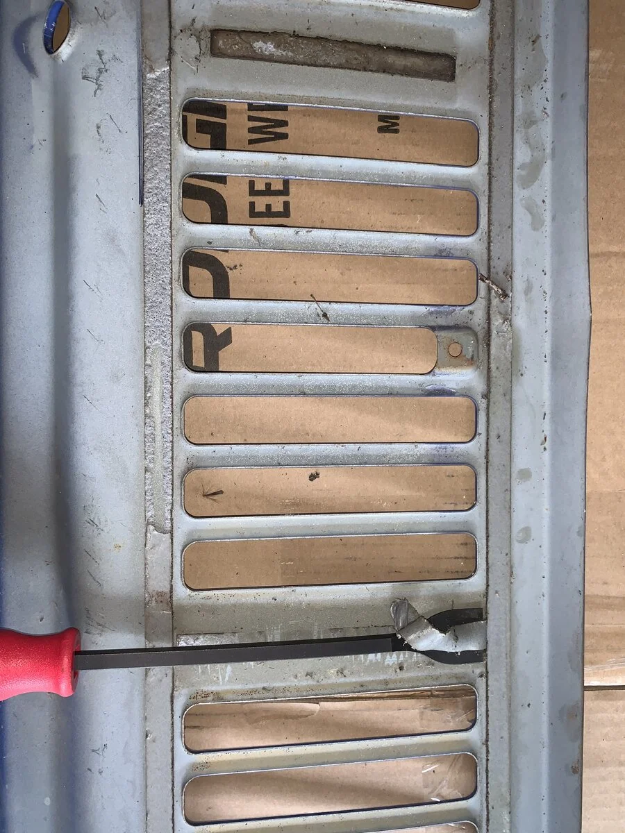

I used a sharp edge scraper as shown in pic to remove the residual tape from the cowl. If you can work the blade underneath a section and push forward it may come off in one strip like mine did. I used a razor blade scraper to remove the tape from the plastic, being careful not to gouge The plastic. Once all of the tape was removed I cleaned the surfaces with acetone. I chose Gorilla 1” Double Sided raps to replace it, which in retrospect, 1/2” tape would’ve been easier because I had to trim mine. Once all contact areas on the cowl were taped I re-installed the plastic guards, being sure to provide the force needed to bond the two surfaces. I reinstalled the cowl and waited for a few heavy rainstorms to report that this fix had eliminated my passenger floor board puddle issue. It also fixed the moisture inside my hvac box causing my blower motor resistor and harness failure which was a nice bonus.

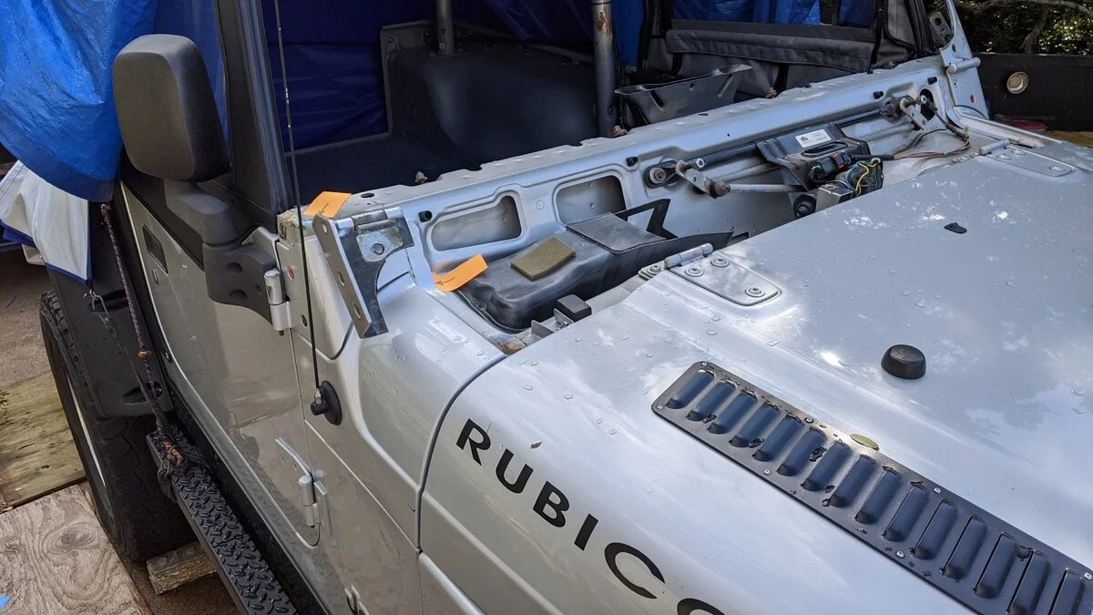

Took me a while to find some pics 'cause my computer was being a complete ass-jack (Microsoft suuuuux). These pics are from a recent post where I responded to another "passenger side leak" question and the post-it-note arrows point to places I sealed.
The part you need is the black plastic box that is just to the right (driver's) of the lower, right post-it note, with the rectangular piece of foam rubber on the top of it. It is held in place by 4 or 5 (can't remember right now) screws that hold it down to the body panel that sits under the cowl. Without it, you will certainly have big-time water intrusion issues.
