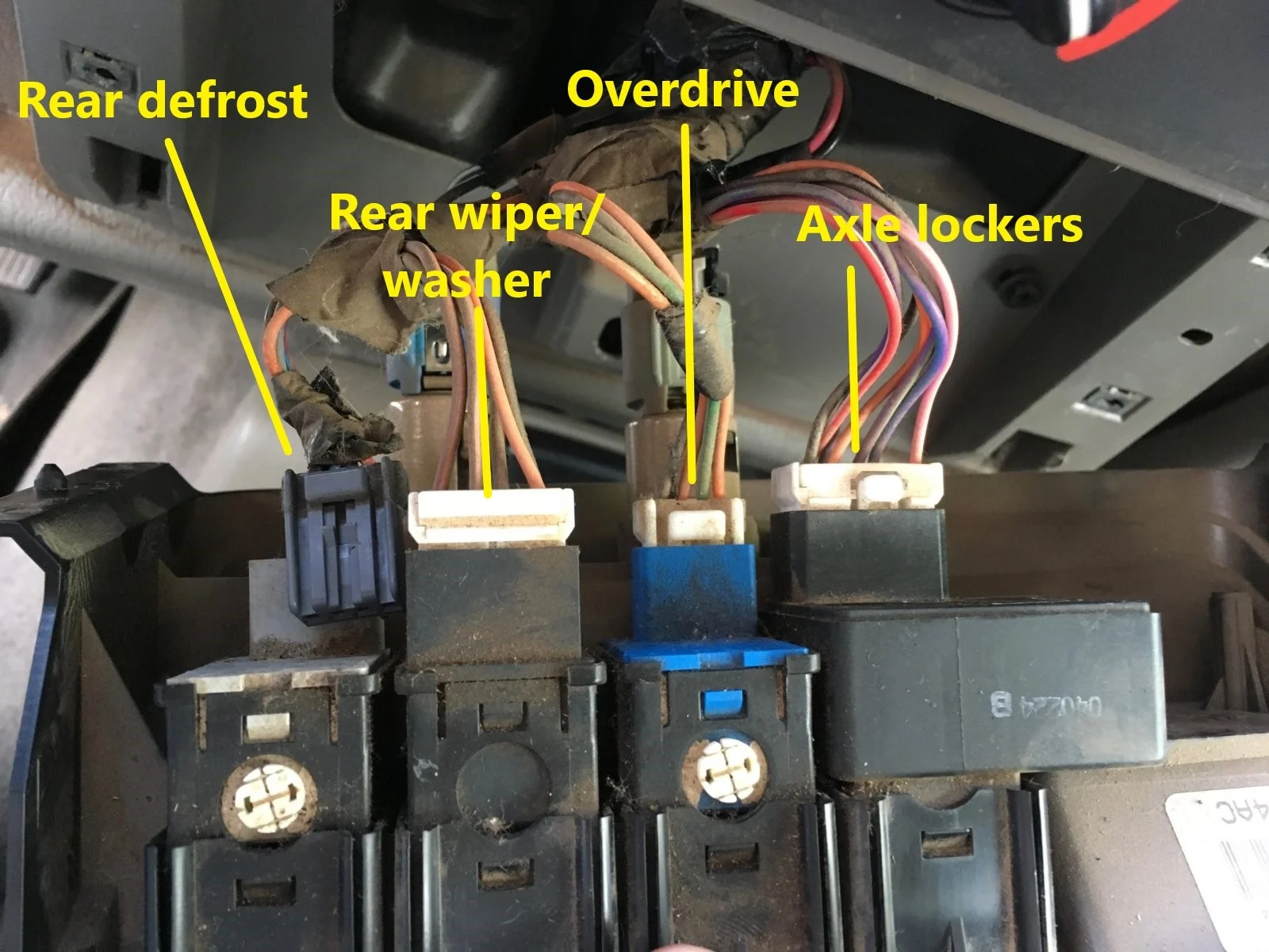

How to Factory Wire Your TJ for a Hardtop Part 1 97-02 (Dash Harness)

I ended up basically making a splice kit instead of replacing both harnesses. Since I only took out the wires that I needed, it didn’t matter if the donor had the O/D switch - wouldn’t be using it anyways.
You could read the voltages on the pins after you get the pin out, is out there somewhere. But it might be easier to put the top and connect the harness and check.
