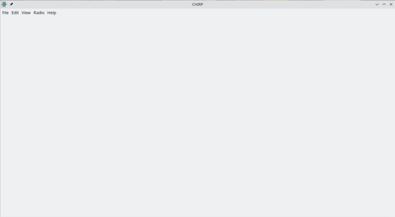

  2. Start Chirp

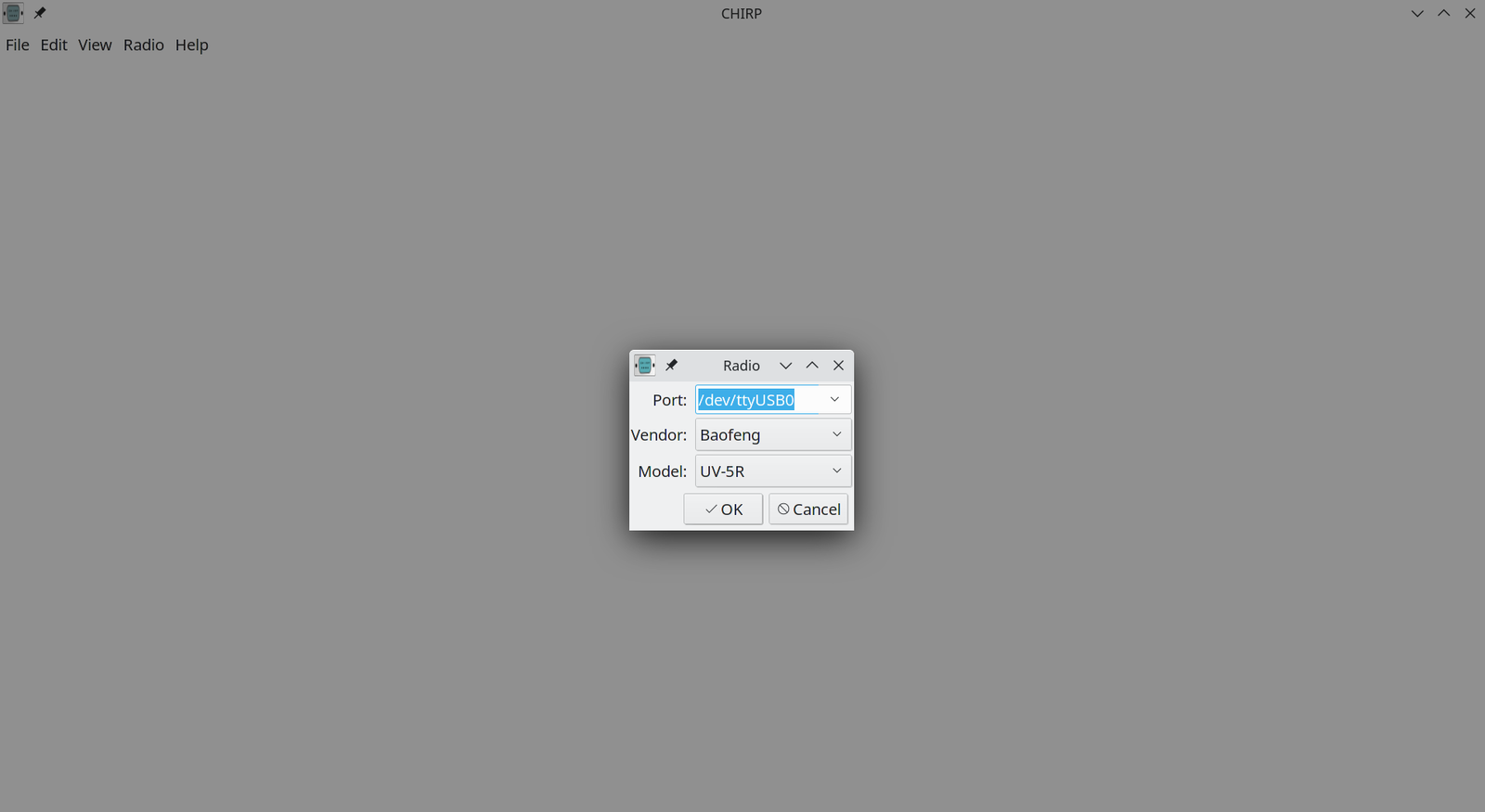

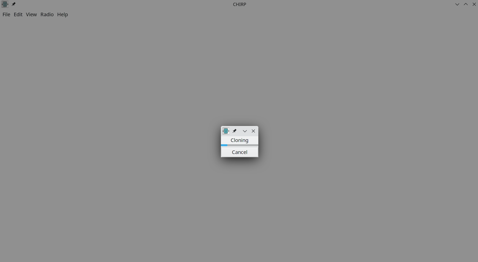

  4. Now you get to choose which Radio and Model you have, which is the easy part. The harder part is determining which Port your device is connected to. For Linux/MacOS/OSX you should see something like mine (/dev/tty*), on Windows you should see COM followed by a digit. To avoid going too technical, just try a couple - if your radio is on one it should connect within the first few tries.

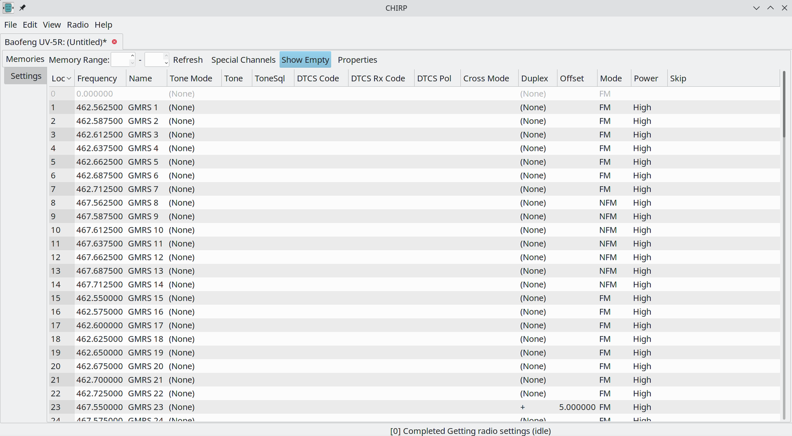

    Once it connects, you'll see it "cloning", followed by the channel listing (and for many radios, a settings tab).
    • Note that this screen may look different if you have a different radio.
  5. If this is your first time cloning the radio settings, I would recommend you save these off somewhere in case you want to return your radio to factory settings. Doing so is like most other applications: "File" > "Save As".
  6. From here you simply put in the settings you want for your channels. You can even name them, which makes later recollection easier (at least for people like me that use radios as a tool, not so much as a hobby where I think about frequencies and such).

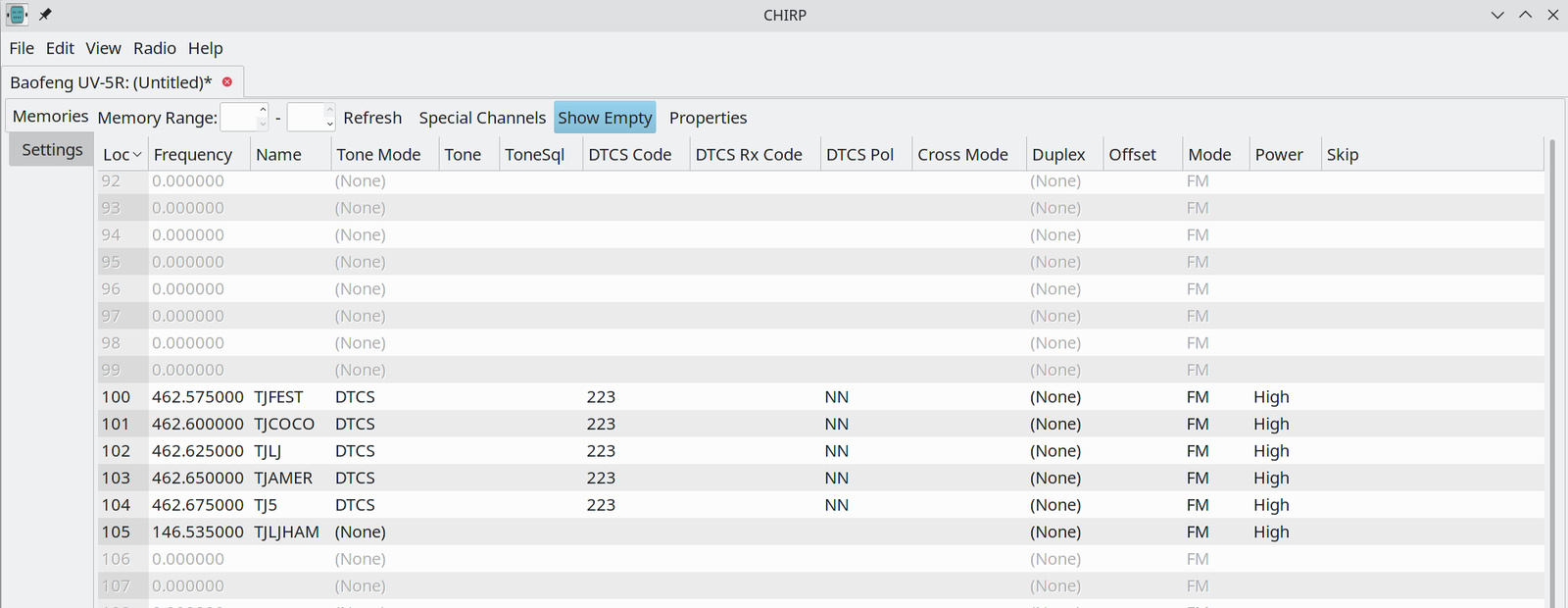

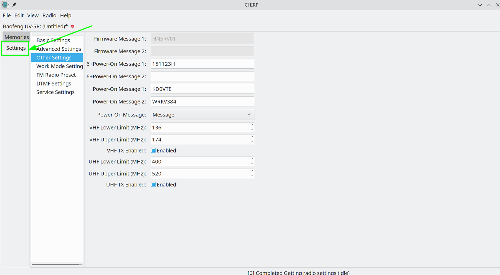

    • Channel Programming
    • Settings Programming

  • In the Settings Programming you can choose the "Display Mode", I set one to "Frequency" and the other to "Name" so I can know by name what channel I am on.

Yeah, I have two different settings for my GMRS channels. One usage is just the GMRS channels by number - so I can monitor a channel. In the screenshot later with my TJ Fest setup I have them customized to use a privacy code (these go by a few different names, just as an FYI). That doesn't mean no one can hear me when I transmit, but my radio will tune out any traffic on that channel that isn't also using that same code when they transmit.
So in short, yes - you can monitor the whole channel with all codes on the main GMRS channel. If you want to, you could turn on dual band monitoring on these radios (and many others) where you'd hear all traffic from the main channel without a privacy code but transmit on one with the code.
I don't know the details of what makes a radio GMRS legal or not beyond being aware of FCC Part 90 and comments that the UV-5R is really spurious in its emissions. I believe they now have a specific radio that is FCC Certified (UV-5G and UV-5X), which should work nearly identical to the UV-5R - but with a fixed antenna and only working on GMRS frequencies (from the factory).
