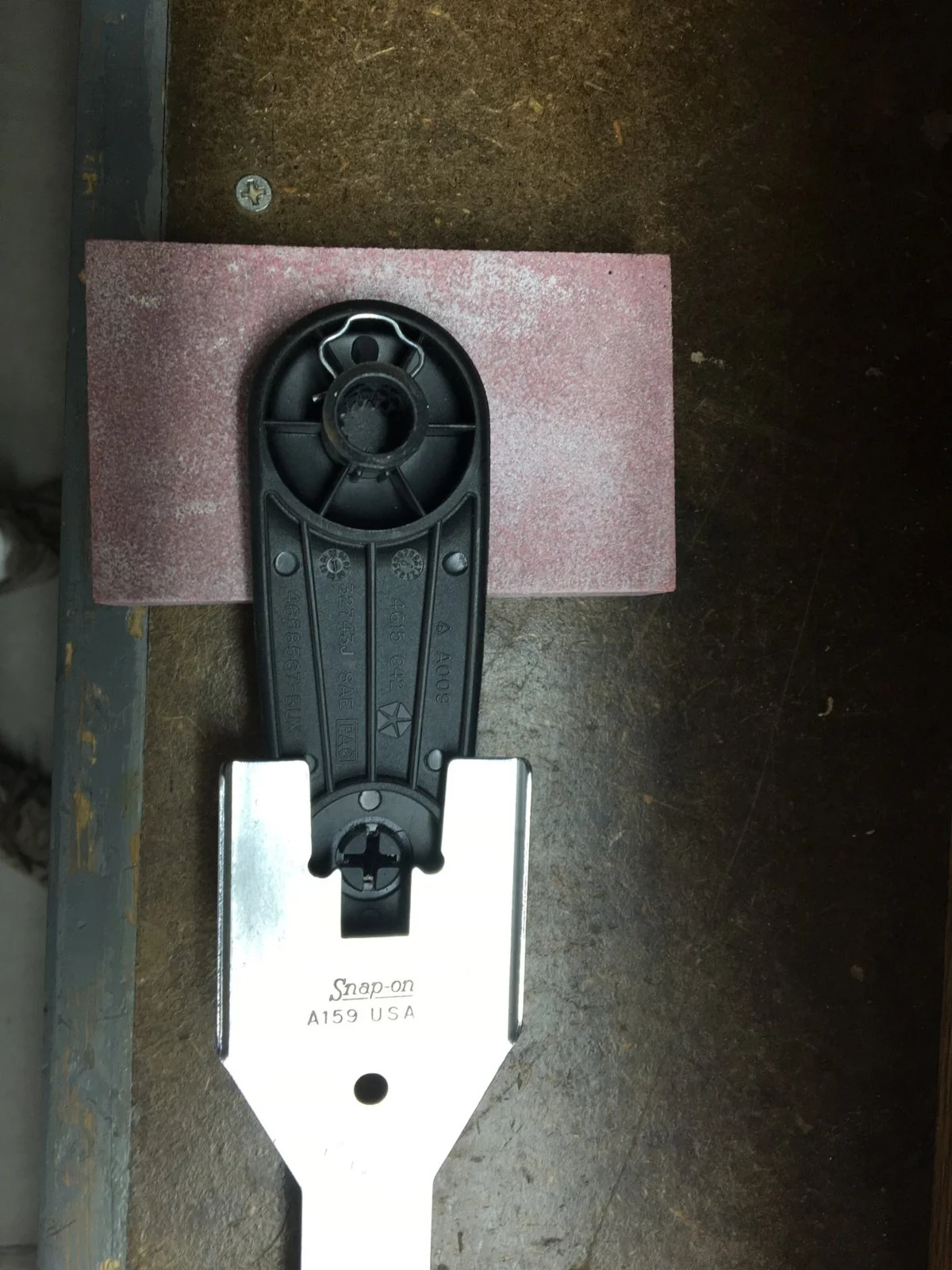

There is a clip on the back of the window crank that requires a special tool. Yes, there are other ways but the tool makes it so easy.
The picture shows the tool and what the backside of the window crank looks like. The clip is partial unseated in this picture. The clip can be installed either way but usually the factory has the open end opposite of the knob. I think...
Just go to any auto parts store and pick up a "window crank removal tool", they are inexpensive for the aggravation they save. They work on older GM vehicles as well if they have manual windows.
Reactions: DA RUNT and UpperMI
BTW: You don't need Snap On. That tool was issued to me a long time ago. Also, watch for the clip to go flying into a hiding place.
