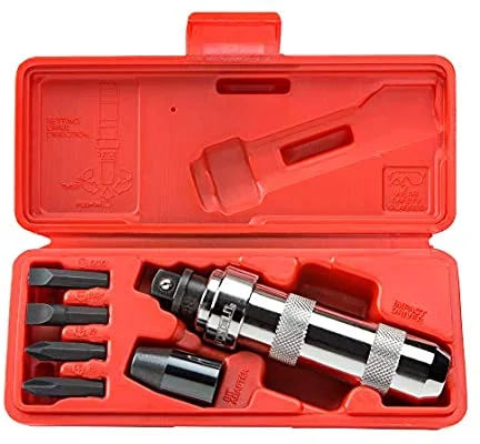

Have you tried a hand impact with the appropriate sized torx bit?

No i can honestly say i havent tried this hand impact driver...tried an makita impact driver/drill driver/socket set with and without extensions (crc/blow torch included)...uhhh wrangler installer...please haha
my Milwaukee impact wasn't moving them but the hand impact did
