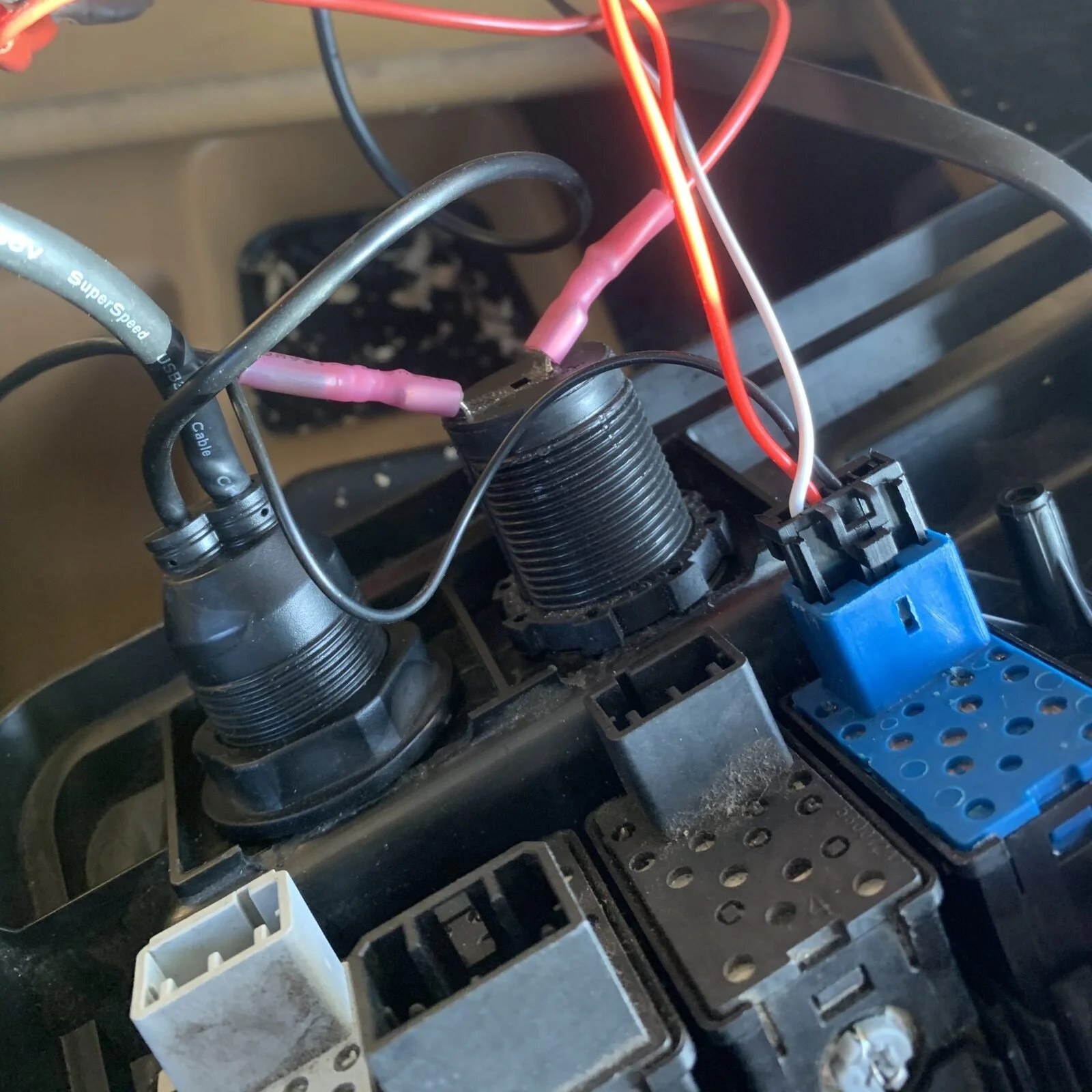

  4. Disconnect the original 12v cigarette lighter outlet. I was not able to remove it from the switch panel without destroying the outlet, so I installed a replacement outlet. You can simply cut the factory harness and solder/crimp to a new outlet.

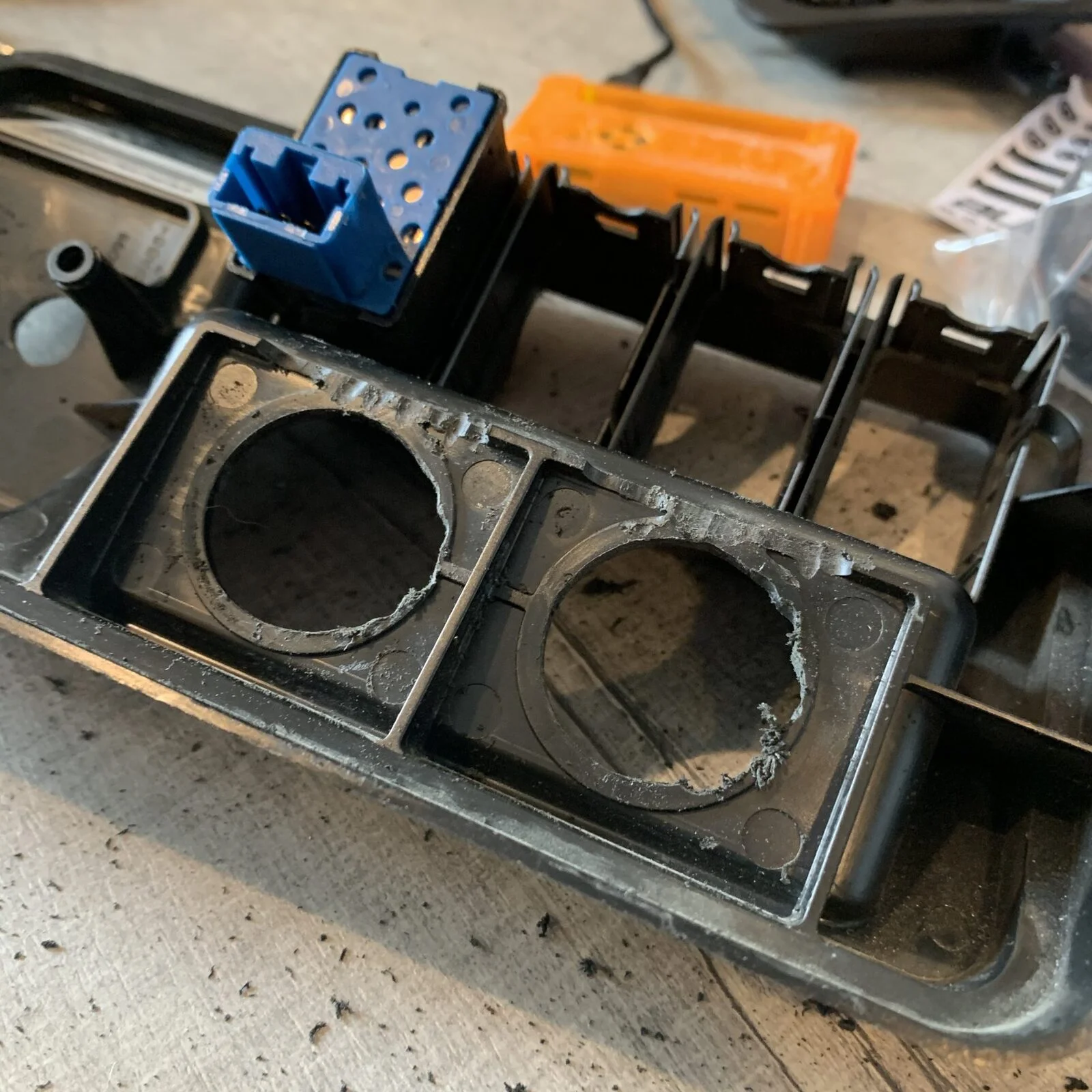

  5. Modify the new 03-06 switch panel: you’ll need to slightly enlarge the 12v outlet holes to fit aftermarket accessories. I used a dremel on one and a utility knife on the other. My panel already had a hole in the flat space on the right, but you’ll need to cut out for whatever you’re mounting there (if anything).
  6. Replace or upgrade the bulbs for the existing rockers (if you wish) and install your 4th rocker switch. Install the 12v outlet(s) as desired, note that the rear space is tight, I had to bend the power tabs on mine. I used a combo USB/Aux outlet and a 12v cigarette lighter outlet which I wired into the original cigarette lighter harness. Its worth noting that these outlets came *very* close to not fitting the space behind the panel, which is why you see my two red terminals bent outward.

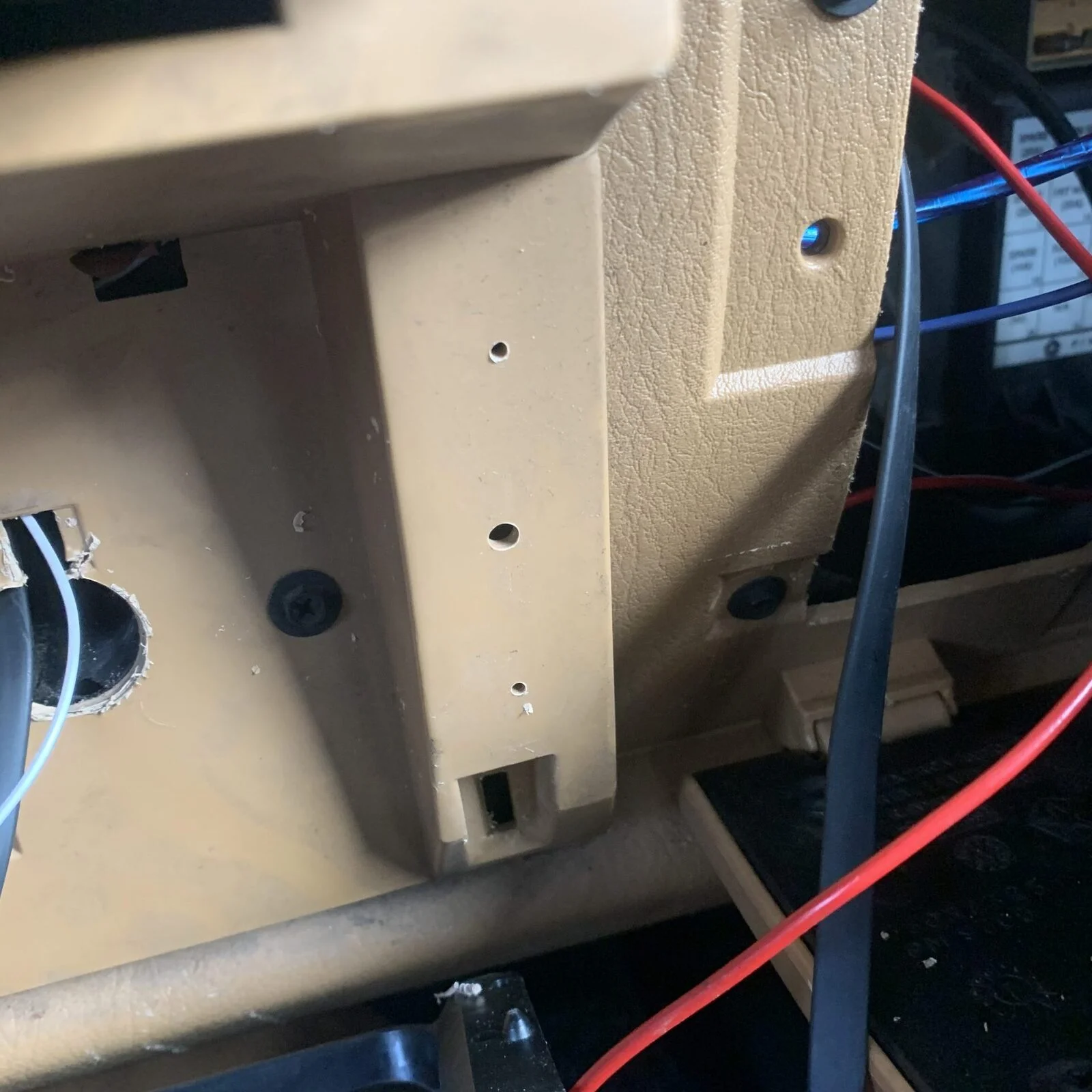

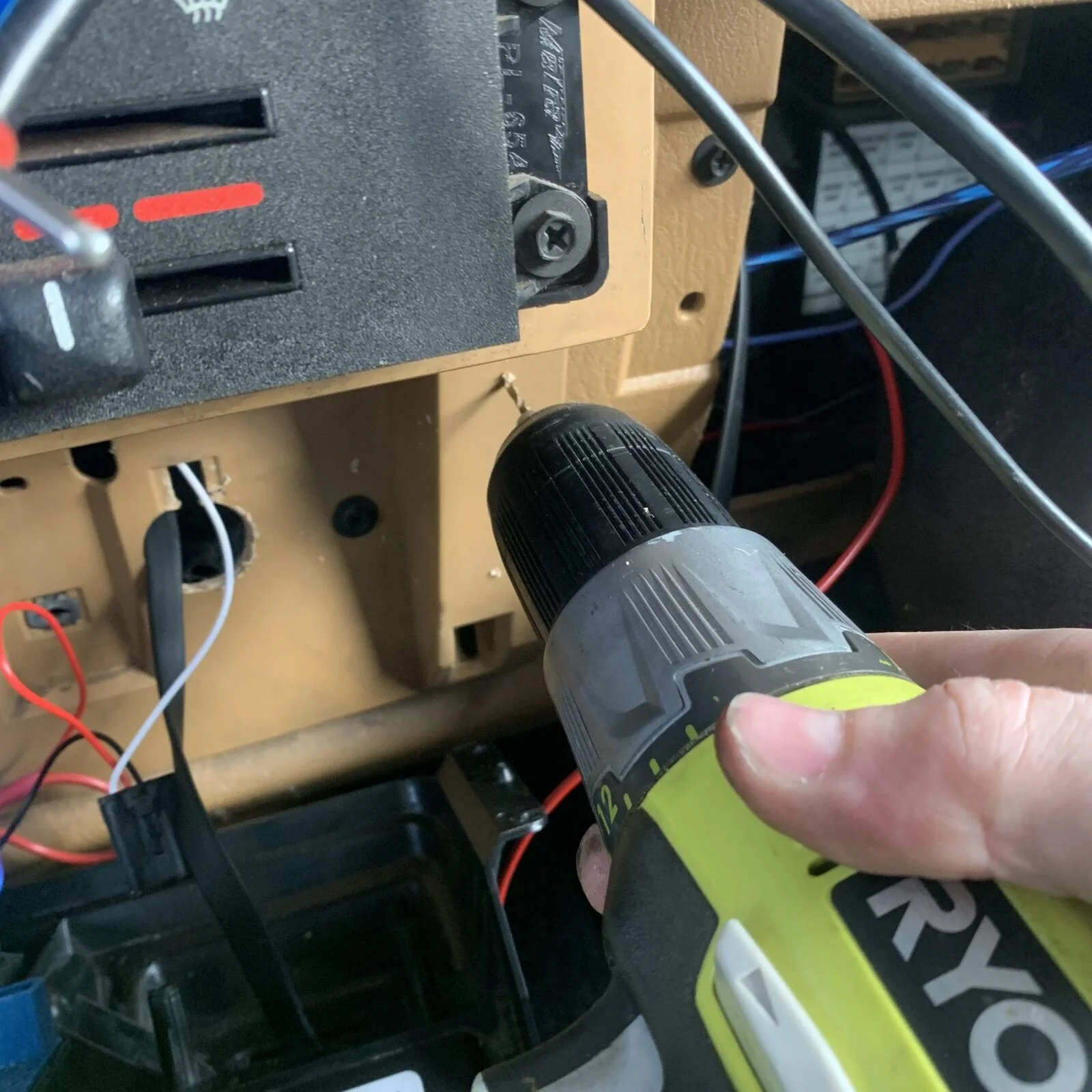

  7. Mock-up the new panel against your dash, the driver side screw holes and peg should fit in the original spots. I used a Sharpie to mark where new holes needed to be drilled in the right side of the plastic.
  8. Drill the two pilot holes for the screws and one larger hole for the center peg.
  9. Install the new switch panel with the 4 original screws.

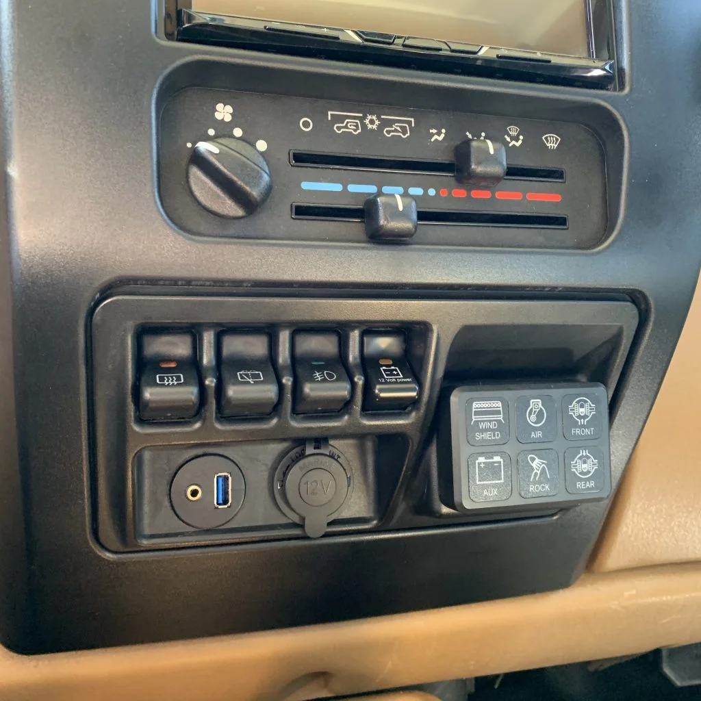

The finished product — the 4th switch controls the accessory panel to the right. The USB and Aux inputs connect to the stereo, and the 12v outlet uses the original cigarette lighter wiring circuit.
