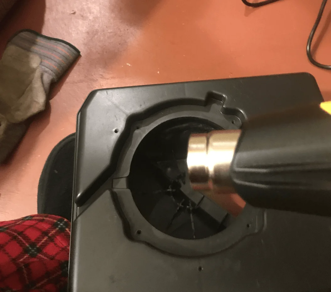

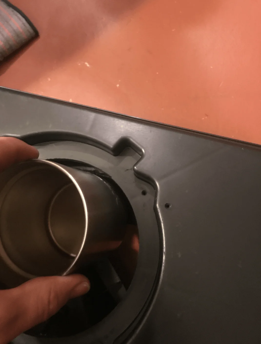

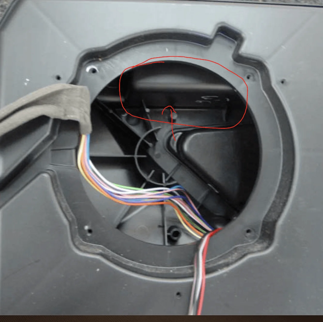

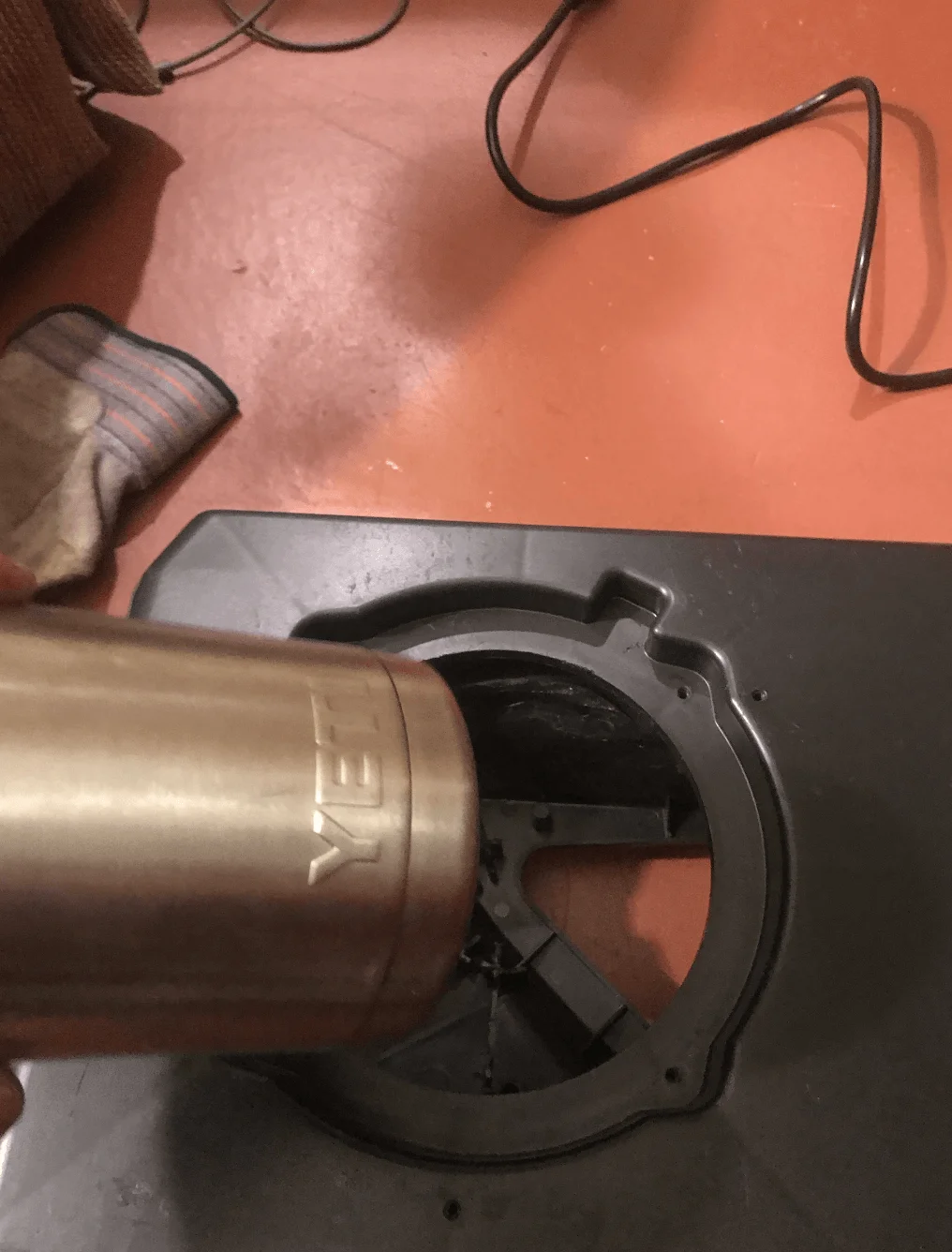

I did run into a hiccup after trimming out the ribbing at the back. The storage in my 04' console dropped down enough that the sub was pressing against it. I wasn't sure who else ran into this. Here was my solution after trimming:
After that, the Kicker dropped in and centered up perfectly!
Fortunately, there is a slight gap (1/2" or so) between top of the Sub enclosure and the bottom of the storage in the console to allow for the modification. All secured back together easily. I was afraid of compromising the enclosure.....I will say, impressed with the ABS response to heat gun and resiliency to be solid and stable once cooled.
