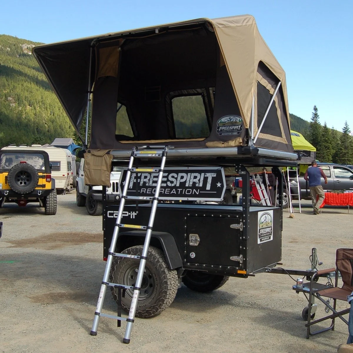

As toximus says, an RTT normally means you are not moving till you break camp. There are some RTTs which can move around set up but still you cannot go for beer without breaking camp.
An RTT might beat the heck out of a tent and are a great choice if you put it on a trailer. BUT keep the TJ stock. Work on refrigeration, shade, cooking, dining. The TJ will be fabulous stock.

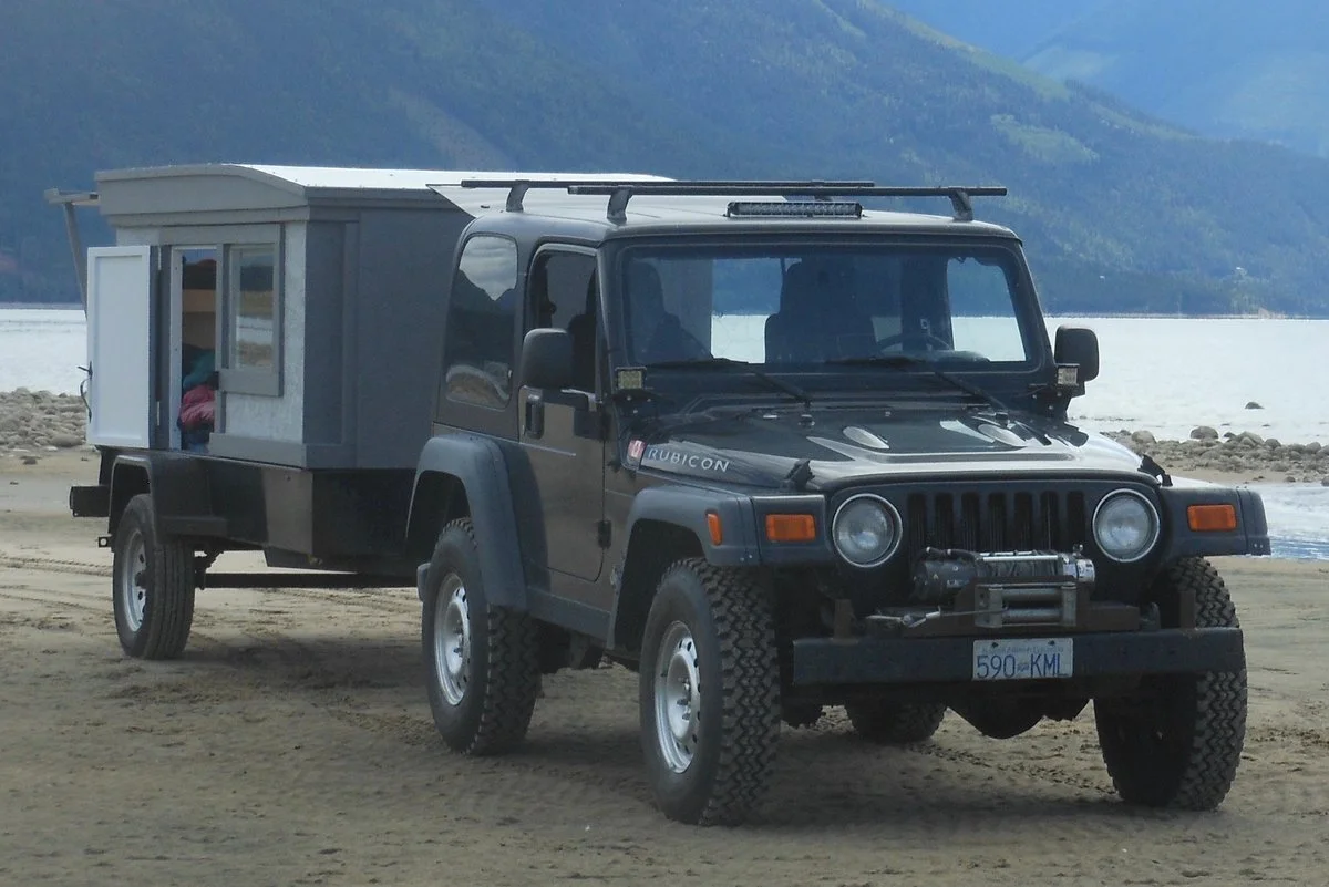

This is my rig. I love the flexibility of a trailer and the comfort of a full double bed mattress.
It took me 40 years to get here.

Heres the best RTT I've seen. You can drive around set up and in 1 minute you can tie it down to go for groceries. PLUS I love how open it is.
