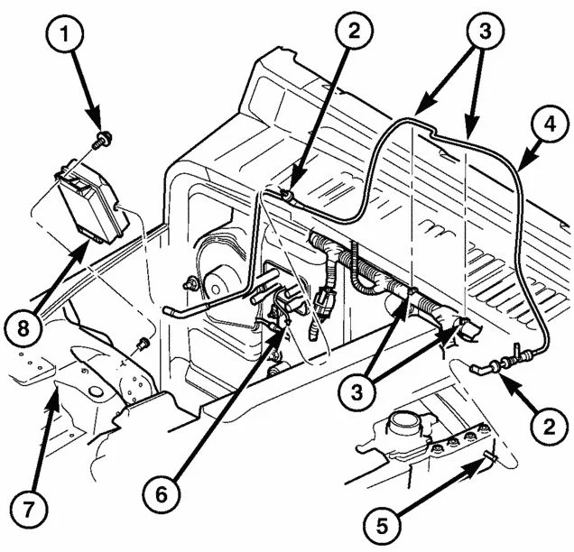

Reactions: SSTJ
I think this one comes up often enough that it would be good to have a resource thread about it. Especially if we could list any most-common locations for vacuum leaks. I'll soon be chasing down one of my own, so will see what I learn in the process.
Those check valves go bad, and I’ve had the under hood vacuum lines crumble at the lightest touch.

I've given the vacume lines in the engine bay a good coat of looking at and nothing is obviously wrong, so my next step is to check the non return valves and reservoir.
