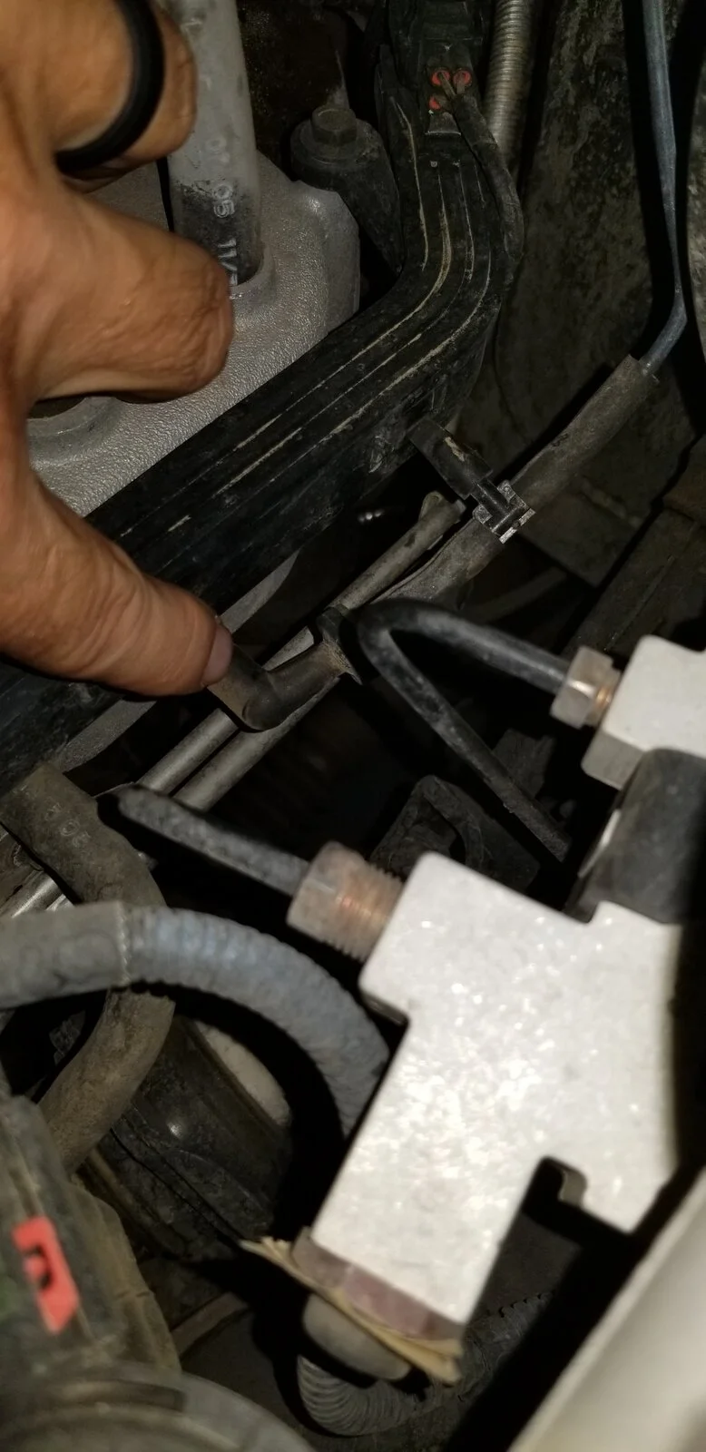

Check this vacuum hose. Make sure it's seated snugly. Same happened to me and that was all it was. The hose had popped off.

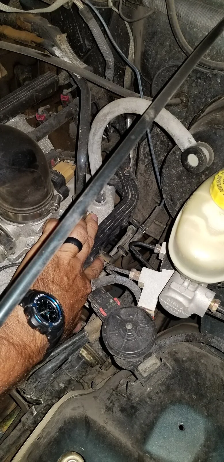

If you still haven’t figured this out there is one last place to look for a vacuum leak. There is a vacuum reservoir under the battery tray you could test that for a leak or the lines that go to it.

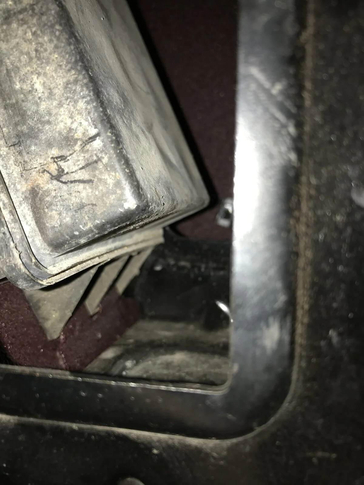

Have you checked the other two door actuators that divert air? They are under the dash and centered. That was my issue. It was broke so the top portion would rotate but the end connected to the door would not. There is a thread about it. If you contort yourself and get your head on the drivers side floor, you’ll see them. Work the function switch while watching to make sure the whole actuator is moving, not just the portion connected to the cable. If it’s broke off in there you can get a wood screw, and screw it into the broken piece and yank it out.
I think that's my next replacement as mine isn't mounted and it's bouncing around under the battery tray, so probably easy to break/leak.
However, I can't find anything as to where its supposed to mount.
