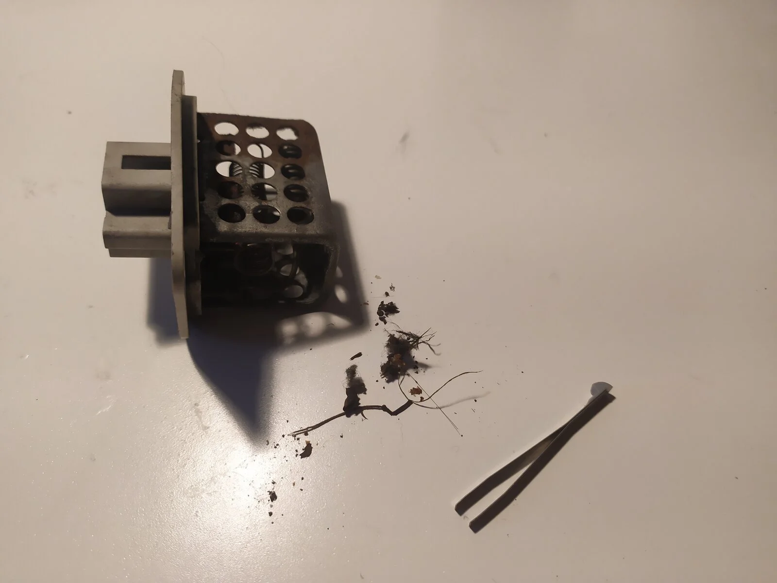

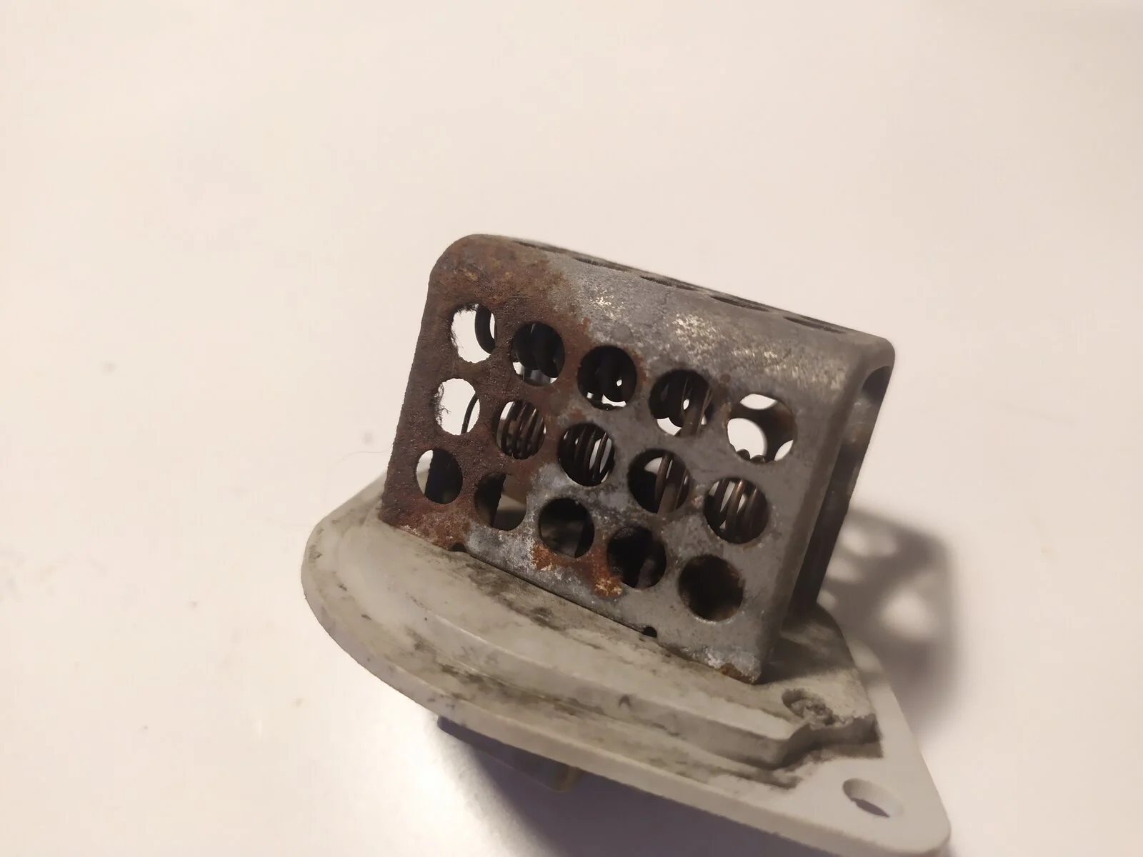

1. The fan blower switch only works on the 4th position. (most likely the resistor?) So i removed the resistor to have an look, and all i could see was a lot of junk stuck in the resistor. (Photo 1&2)

You can verify the condition of the blower resistor by measuring resistance across the windings even though that resistor looks like its seen better days and should be replaced.
