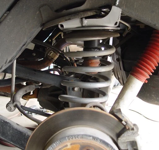

after doing some research looks like I might need to do a relocation on the upper spring bracket from its stock location. Have any of you guys with a 4.5 inch lift done this to your jeeps? Think I will just move the stock bracket and re weld it in place.
Sounds like weld-on would be more appropriate for your application/use.
I have the AEV bolt-on from years back (2008-9?...). Bolt-on fit my needs and matched my lack of welding skill. Downside of bolt-on was it added an 1"-5/8 in back. After some arduous research (10min on Google), I mounted OME 2.5"-3" coils (My front coils are some older Rubicon Express 3.5", they run closer to 4")
Upside- Supper comfy ride loaded, or unloaded, less body roll / less top heavy feeling from rack around corners. Lost some,2 inch maybe, rear articulation, not enough to limit higher moderate trails.

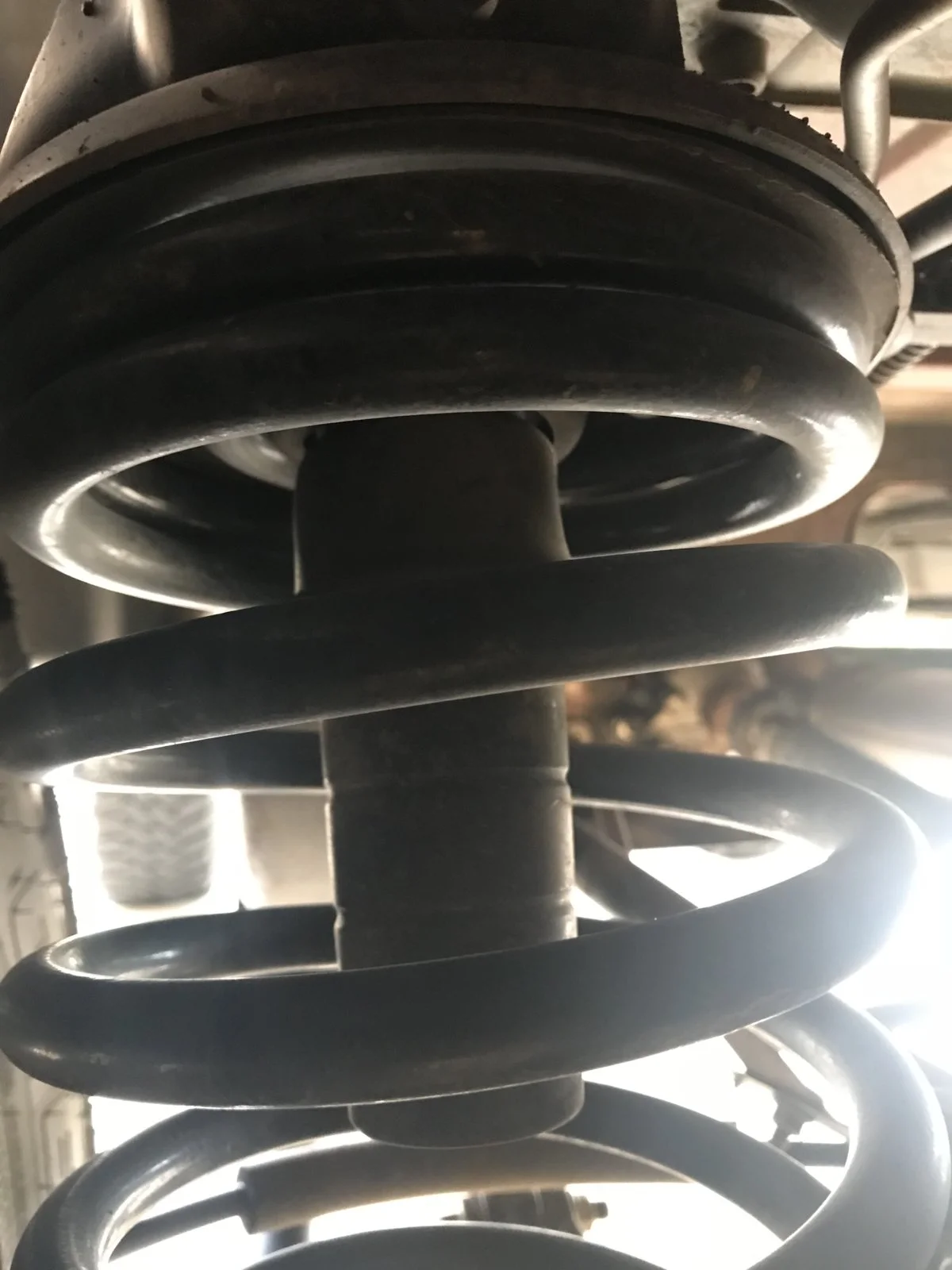

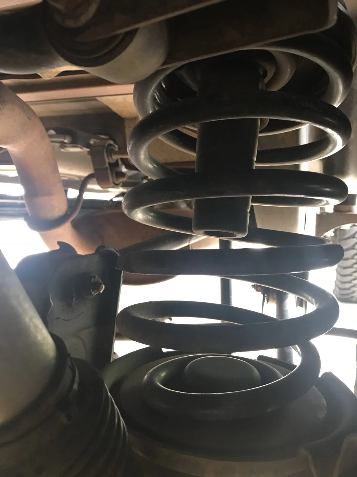

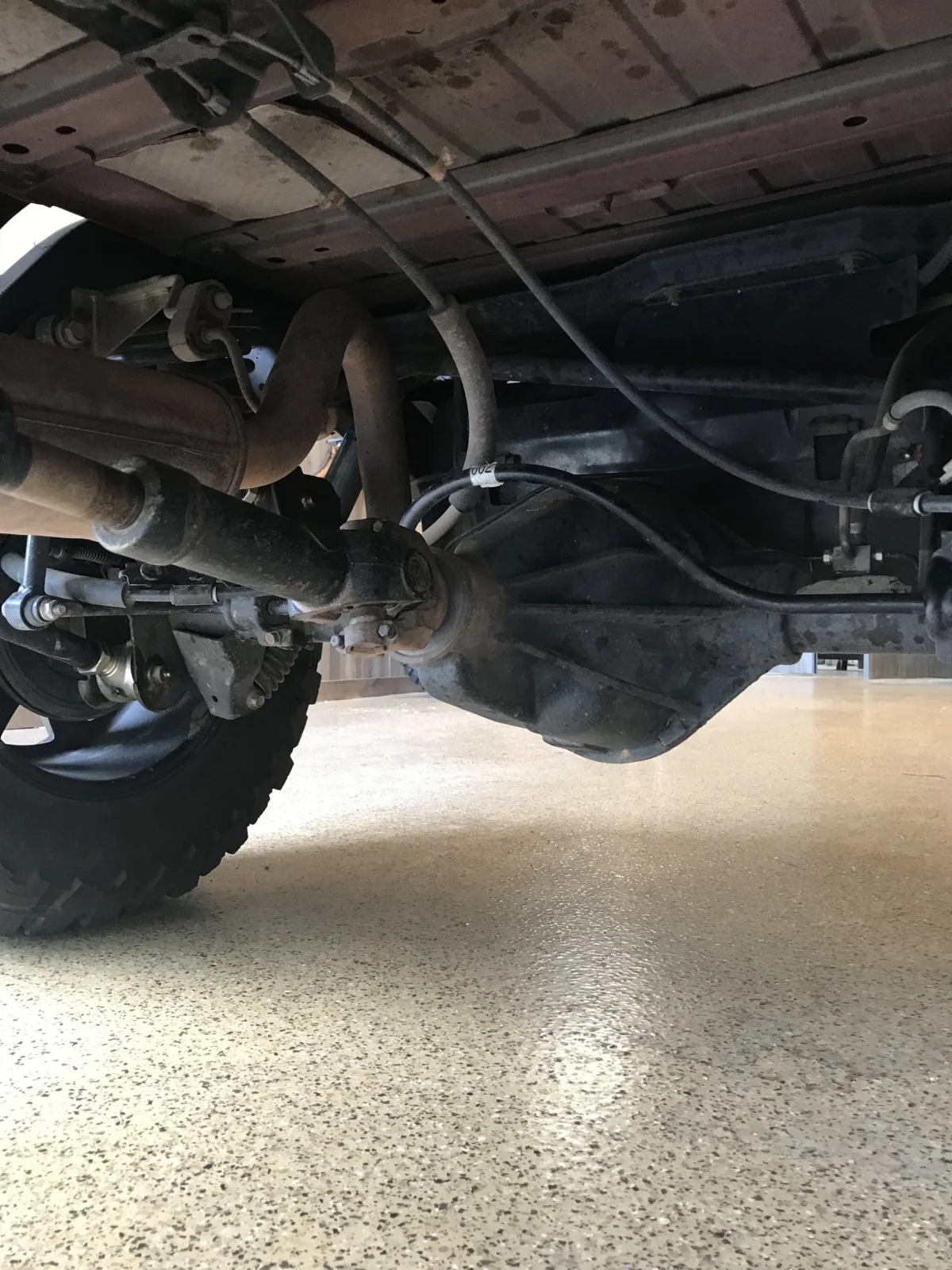

If its not to much trouble can I get a picture of your pinion angle and your spring? I'd like to see how far off mine is compared to yours. I called Full Traction which is the manufacture of my lift and they said a bend in the spring is completely normal and all jeeps with a lift have a bend. They also went on to say if it wasn't suppose to be there they would have made a relocation bracket and sold it with the kit. I'm no expert with suspension so just relying on what the people who make these say. Hopefully adjusting the pinion angle will help a little if anything to ease my mind.
Sure I'd be happy to I won't be back till the weekend and I'll try to remember to reply with a pict.
Thanks for the pictures. hopefully I can get mine a little more like yours.
This is the only correct fix after lifting jeep. See what angles need corrected, cut off the offending mount, weld new one in its place, back to jeepin.
