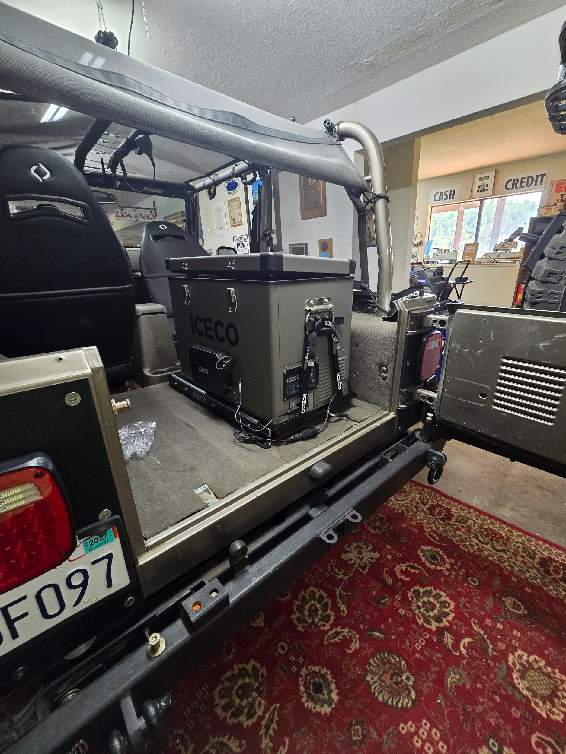

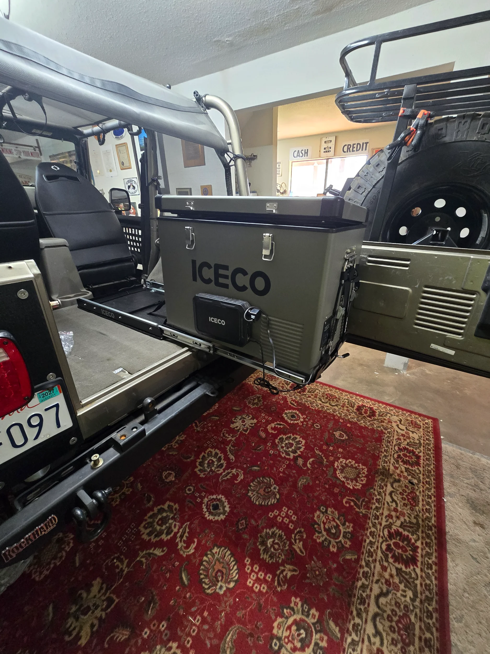

Installed a slide for my refrigerator. I used a piece of 1/2 inch plywood as a base. Mounted the slide to it and through the slide, wood, and tub to secure it. I ran a dedicated fused 10awg power receptacle to the dash for it. I have an SAE connector under the hood to plug the solar in but havent bought that part yet.
