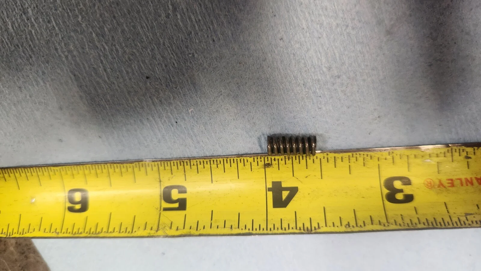

B1Toad TJ Expert Original poster Supporting Member Joined Jan 15, 2023 Messages 3,286 Location Arizona Sep 6, 2023 #1 This was in the bottom of my transmission. A previous owner installed a B&M short throw shifter, is this a spring from the OEM shifter that fell in?

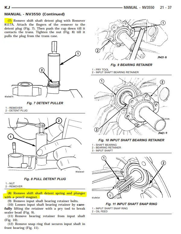

Obi-Wan In my experience, there's no such thing as luck. Supporting Member Joined Apr 6, 2022 Messages 610 Location Tatooine, Outer Rim Sep 7, 2023 #2 That sure looks like a shift shaft detent spring. The only other springs would be buried inside the transmission, and the PO wouldn't have had to go that deep to install a short shifter. Last edited: Sep 7, 2023 Reactions: Daryl and B1Toad
B1Toad TJ Expert Original poster Supporting Member Joined Jan 15, 2023 Messages 3,286 Location Arizona Sep 7, 2023 #3 Well the transmission was supposedly rebuilt 3 years ago and I can believe it as there is evidence of RTV at the seams. I thought the spring looked like it came from the shifter though.
