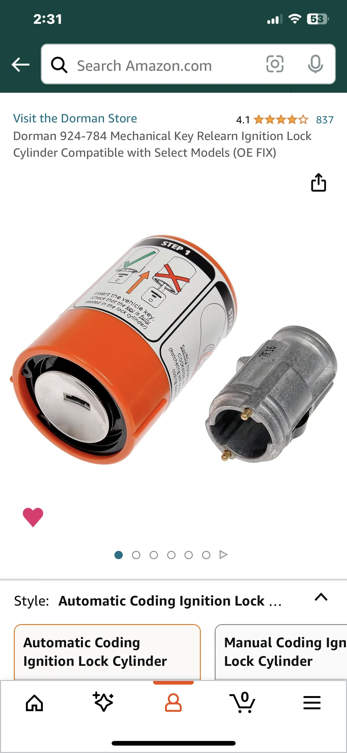

Check out this replacement cylinder from Dorman that supposedly works with your existing key!
https://www.amazon.com/dp/B07D8BKR5M/?tag=wranglerorg-20
