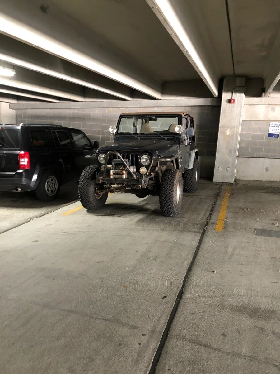

Got some new LED headlights with integrated turn signals, RE monotube shocks, I welded on a new shock bracket to the rear 8.8, and gave her a tune up with Champion plugs and a K&N drop in filter.
The tires are new as well - 35x12.5R15 BFG KM3
She still has a ways to go - I need to get a new dash cluster as the gauges and display are dead, an aluminum radiator, new winch, seats, and need to decide what to do about the grenaded front HP30.
