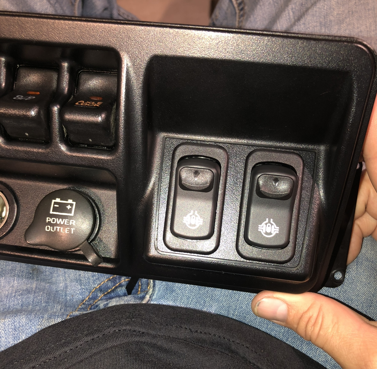

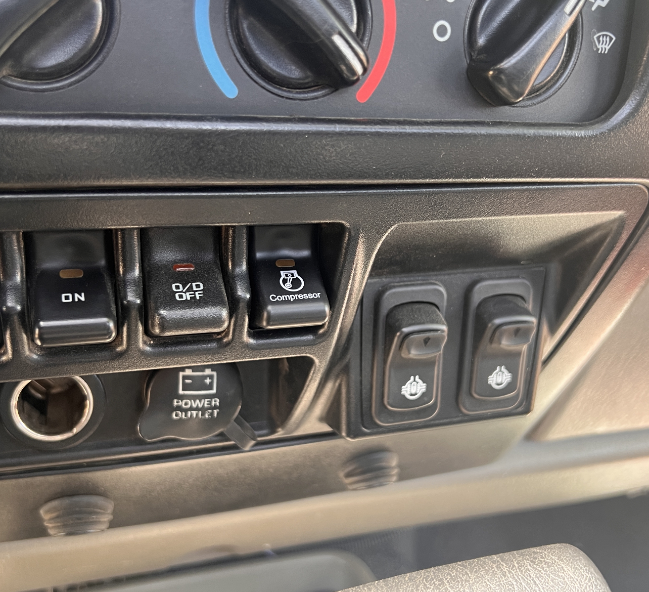

I'm trying to make a bad locker choice, need a voice of reason
The auto locker will work fine most of the time. But that one time when you really wish you were in control, you won't be. I would (and did) go with the E-Locker for Colorado driving.

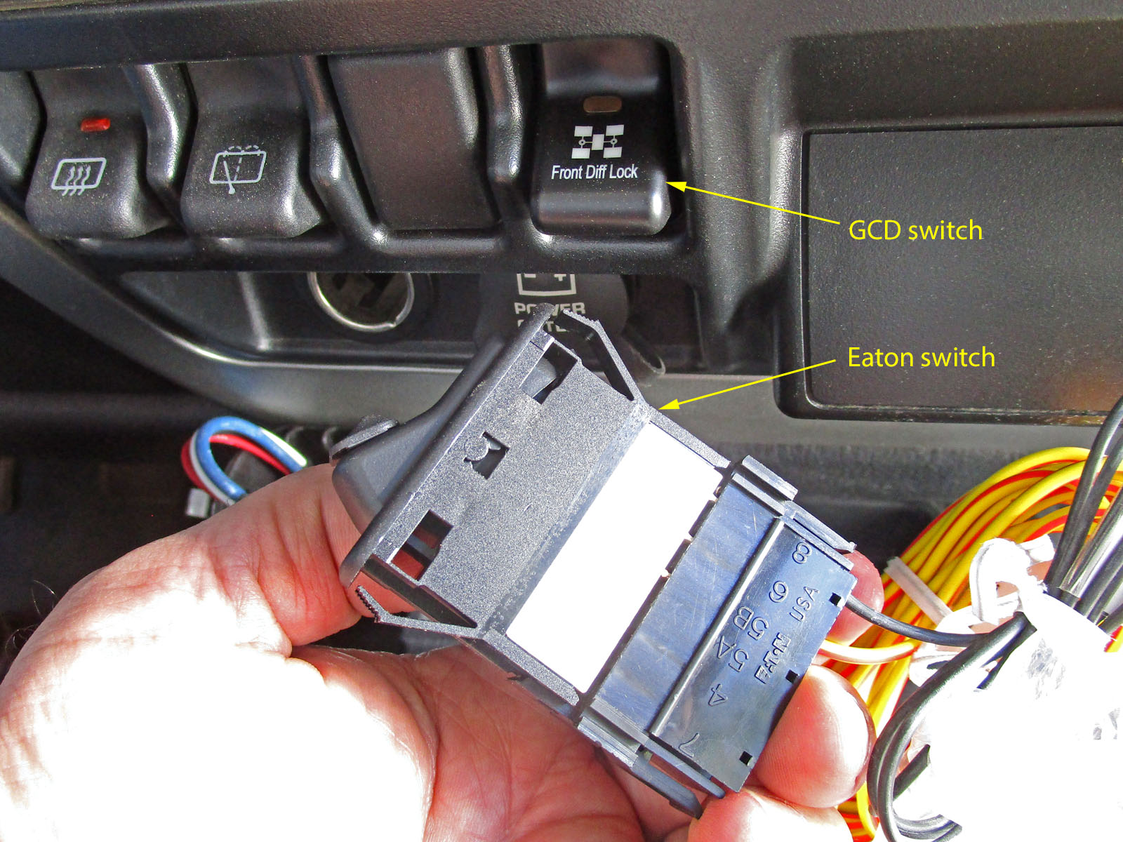

The switch which comes with the E-Locker is enormous. Instead of trying to mount that monster, I used a GCD switch which snaps into the switch bank on the dash:
https://www.amazon.com/dp/B08HM97SW9/?tag=wranglerorg-20
I haven't looked at the Eaton wiring schematic but a simple SPST on-off switch should work well and from your photo it appears that is all the Eaton switch is. At least I only see two wires going into it.
Both the Eaton and the GCD switch are 3-wire: Power in, Locker out, and Ground. The ground is there for the built-in LED. Yes, the switch itself is SPST.
I simply made use of dead space. I prefer the safety switch functionality and reserving the stock switch locations for other items.

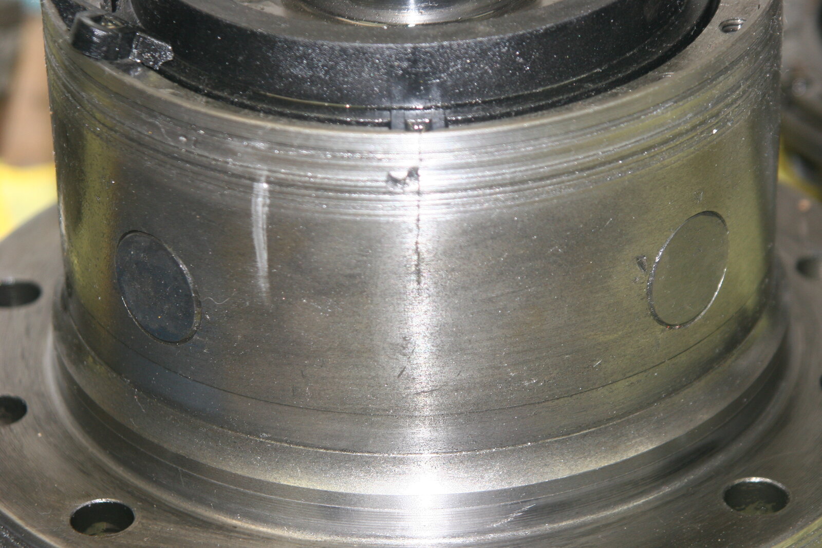

I know ARB improved their case design a few years ago (going from a three-piece case to a two-piece case, or something like that), but I did smoke an old style 60 case. Cracked the case in four places. I guess I would have been OK if I were running an LS...
Could it be the 40s?
