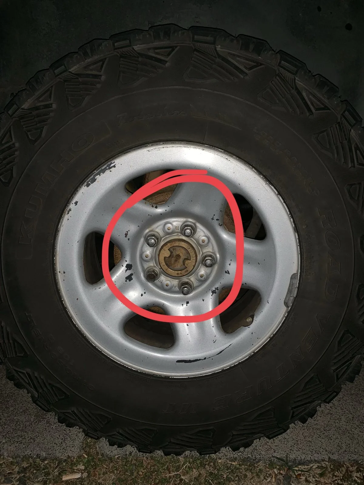

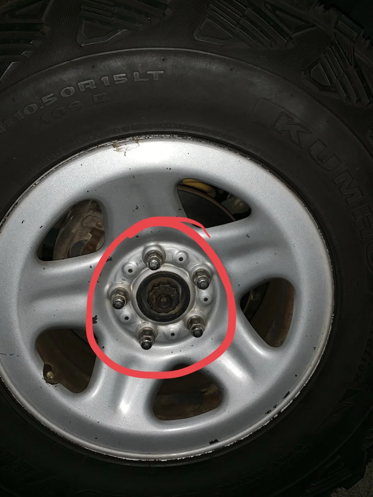

Over the past week, i have noticed the tyre noise has been gradually becoming very loud while driving. This noise only occurs when i am rolling and not accelerating. As soon as i accelerate, the noise stops. It is a similar noise to the noise of loud over size mud tyres driving on the road and howling, though is much louder and has never previously happened with my all terrain tyres. Not sure what it is and how it can be fixed. It sounds like it is coming from the front right tyre. Though could be coming from both the front right and left.
See attached photos.
Would appreciate if someone could tell me the problem.
Same rims as my TJR... same, no caps too. Awesome choice !!
