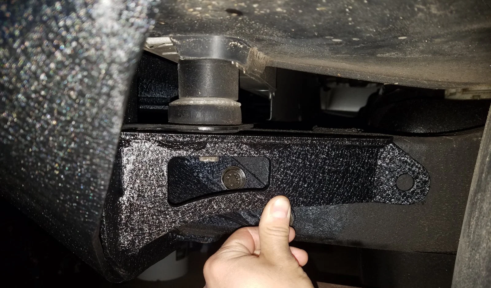

When I put in my current bumper, and a previous Smitty, I had to drill the inside holes, shown below:

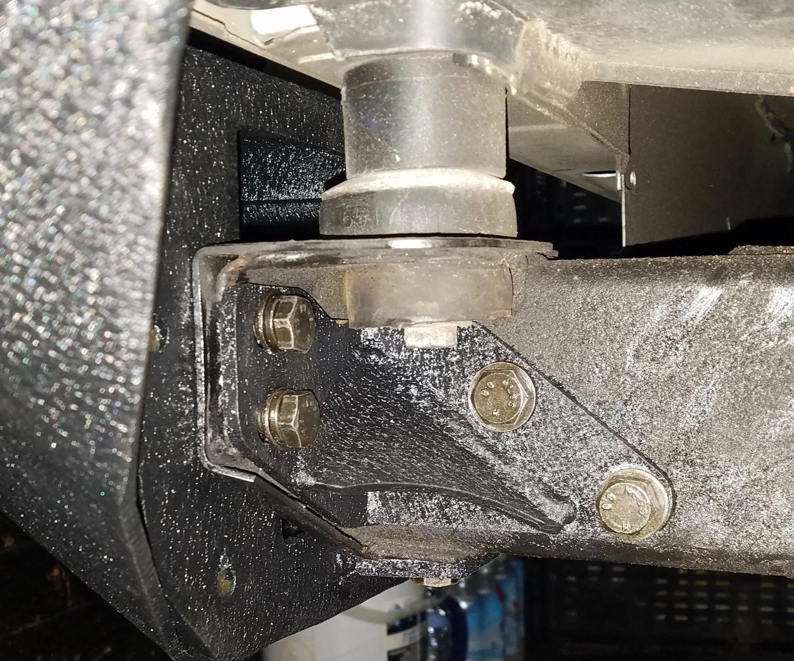

Then I put on these corner tie-in brackets:
If you used the eight rear mounting holes/bolts, and the corner tie-in brackets, that is all you need. Not sure why those are provided, but your Smitty bumper is different...got a photo of these extra brackets?
