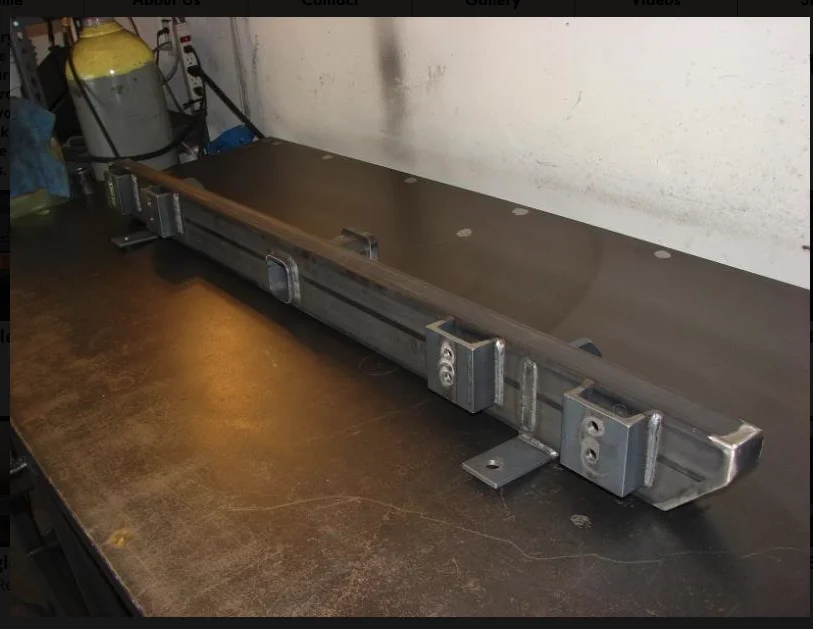

The dirt works bumper has attachment points on the bottom of the frame.
Lot of people here wetting their panties about towing a 2000lb trailer for 25 miles, 1 time. You could do that with a freakin dodge neon if you had to.
Only way that bumper's coming off is if you take a serious hit. Contact dirtworx and see what they recommend. Are they the kind of company that would sell a bumper with receiver that can't be used? The lawyers would sue the crap out of them.
Well technically he could tow with a strap wrapped through the tongue tied to the frame.
Legally you need lights and safety chains. If he stays below the tow limit by 20% it will probably be fine.
But why not add what's needed for next time?
Wiring harness, frame mount, and a way to hook safety chains to the bumper or frame. Then if you never need them again, you saved $250 this time instead of $300.
Get a ticket and your savings go out the window. That's why I do tire and light checks before every tow.
