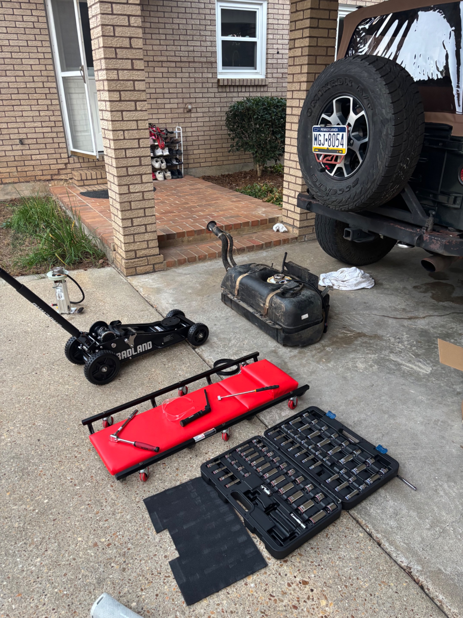

When I installed the Delphi FG1353, I struggled with getting the pump module and the rubber gasket/o-ring seated correctly. I eventually got it to look right and the locking ring went on, but it took some work and I wasn’t 100% confident during the process. The gasket looked properly seated when I finished — just mentioning this in case a slightly misaligned seal could cause intermittent pressure loss or the pump picking up air under certain conditions.
Before I drop the tank again or return the pump, I wanted to see if anyone else has experienced similar issues with the Delphi FG1353 on a TJ, or if a tricky gasket/seal could actually cause these symptoms even if it appeared correct.

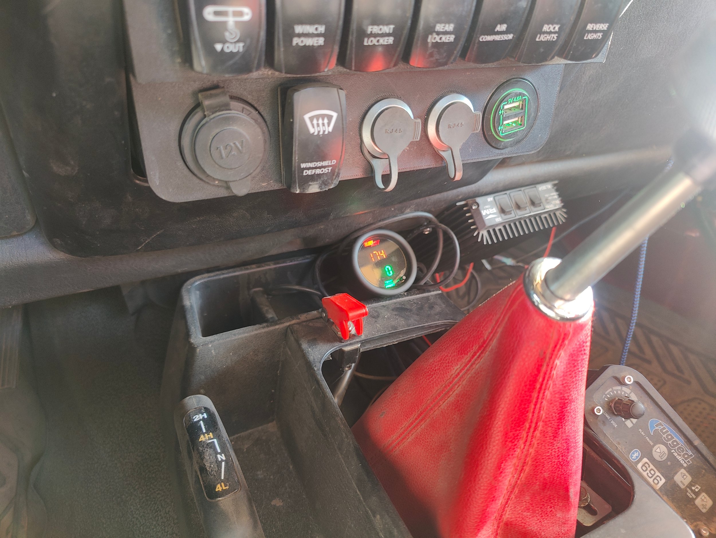

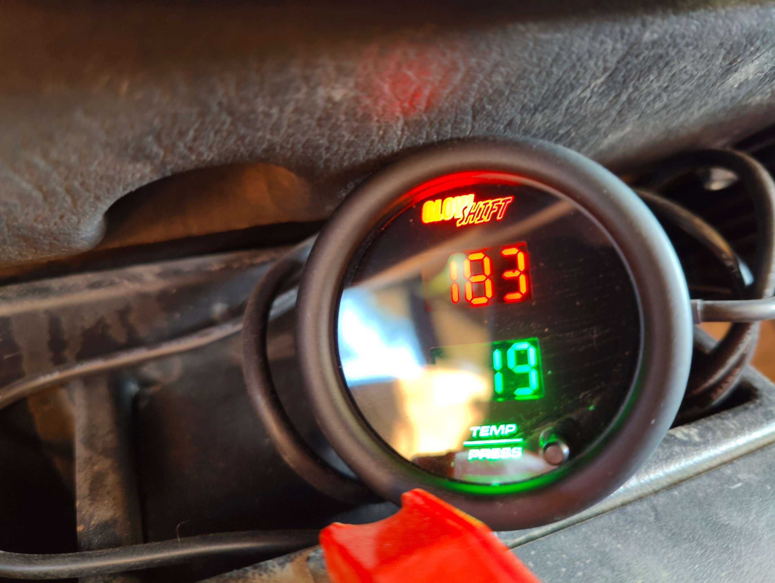

Glowshift makes a pressure and temp gauge. Currently using one for my oil pressure and temperature.
I want to 3d scan this spot and 3d print a gauge pod. Room for two gauges and a couple switches. Then I could add a fuel pressure and temp gauge.
What don't like about the Glowshift is the pressure and temp probes are seperate 1/8" sensors...not a single...this was a PIA for oil and I still haven't gotten that to stop seeping oil.
I also wish it would log or could be incorporated into the PCM. Ultimately to that end I'd like to replace my PCM with a Haltech.
-Mac

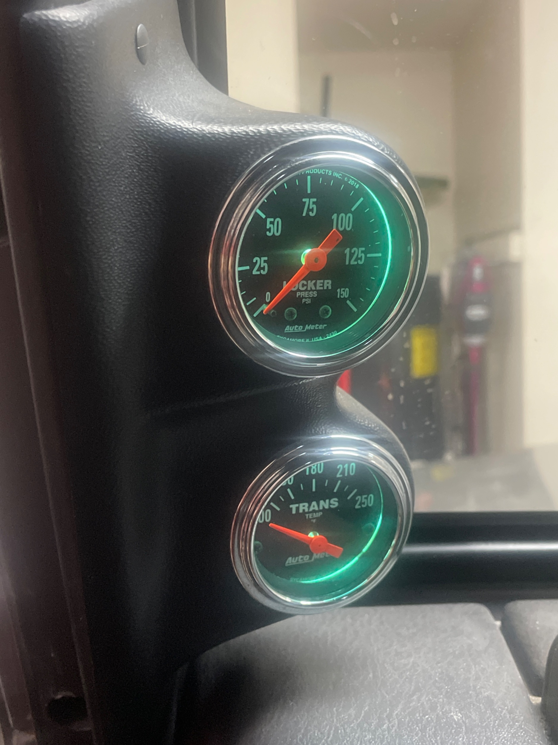

oh,i was going stepper motor from auto meter.your not having fuel into the cab?I was going to move my locker gauge somewhere else and do fuel pressure above the trans temp.
