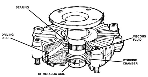

Also, taken from the FSM:
DIAGNOSIS AND TESTING VISCOUS FAN DRIVE
If the fan assembly free-wheels without drag (the fan blades will revolve more than five turns when spun by hand), replace the fan drive. This spin test must be performed when the engine is cool.
