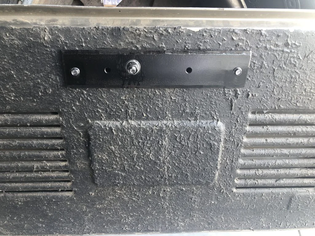

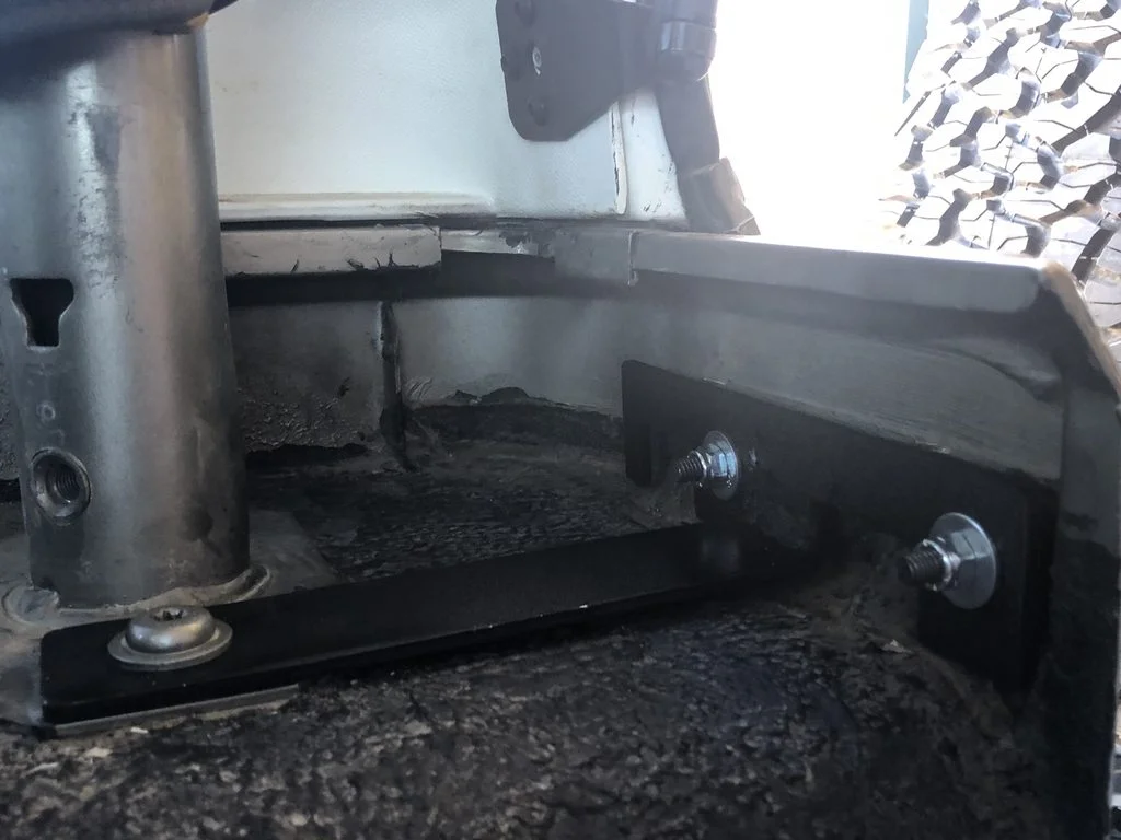

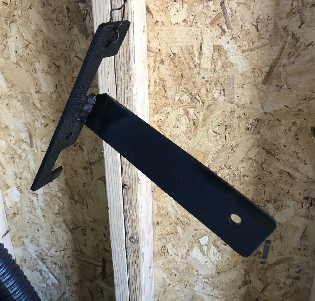

You have to take the weight off the tailgate. This one was good with a 35" spare for 7 years until the Jeep was sold. I use various methods. You want to have to slightly lift the tire to close the tailgate so there's no weight dragging it down. My Rubicon 35" spare has been on for 3 years and the hinges are smooth as "butta".
Thanks for the pics @TheBoogieman . Looks like this creates upward force countering some, if not most of the tire weight. If I do this, does this mean I can run my stock hinges for some extended time?
Thanks for the pics @TheBoogieman . Looks like this creates upwards force countering some, if not most of the tire weight. If I do this, does this mean I can run my stock hinges for some extended time?
Yes. The top pic was the support that was used for 7 years. I run 35" spares on the stock carrier on almost all of my Jeeps and never had any problems with the stock hinges.
Yes. The top pic was the support that was used for 7 years. I run 35" spares on the stock carrier on almost all of my Jeeps and never had any problems with the stock hinges.View attachment 200236
