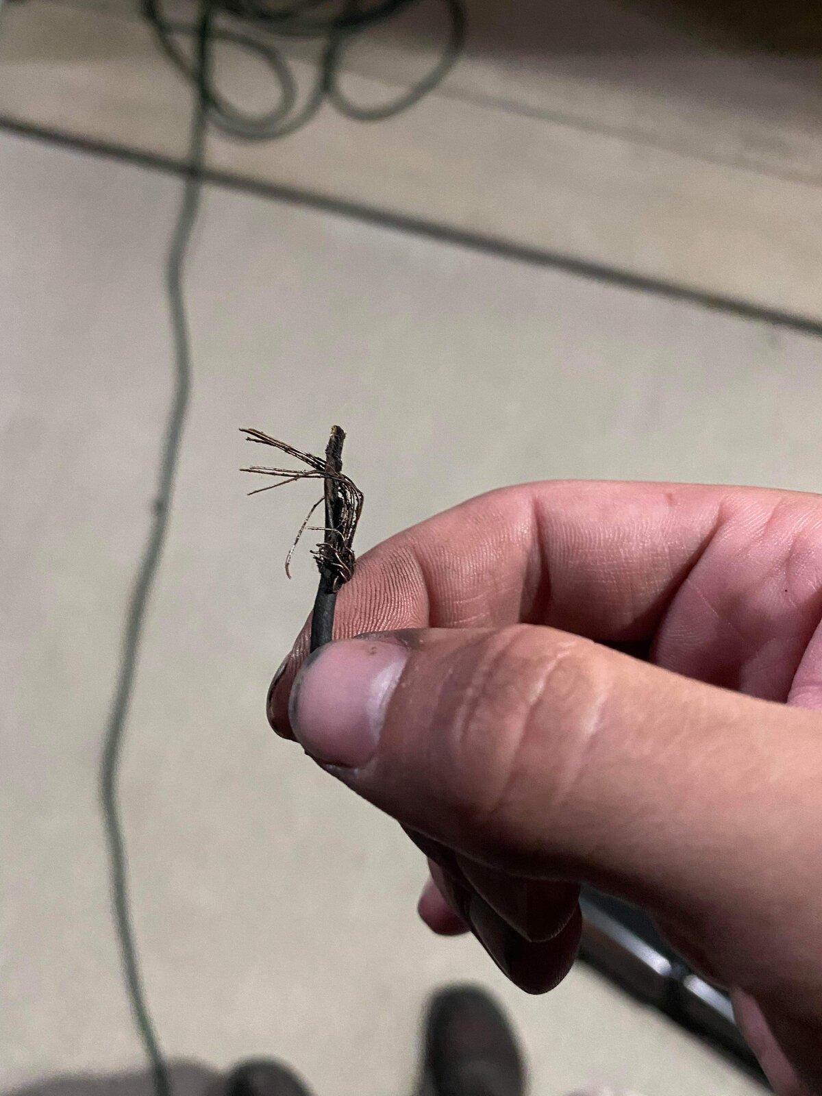

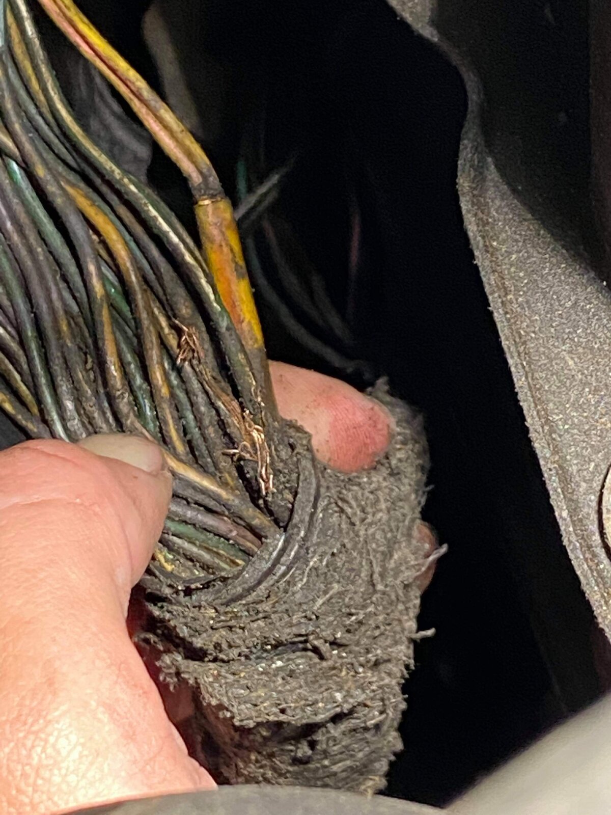

@lafittejeep Are there any codes present? Limp mode usually brings a 0700 and an underlying code. Check the black connector on your Jeep as that controls the shifting. Spray some contact cleaner and make sure the red clips are firmly clipped in. I have enclosed a few photos of some common wiring gremlins on the Lee’s years.
