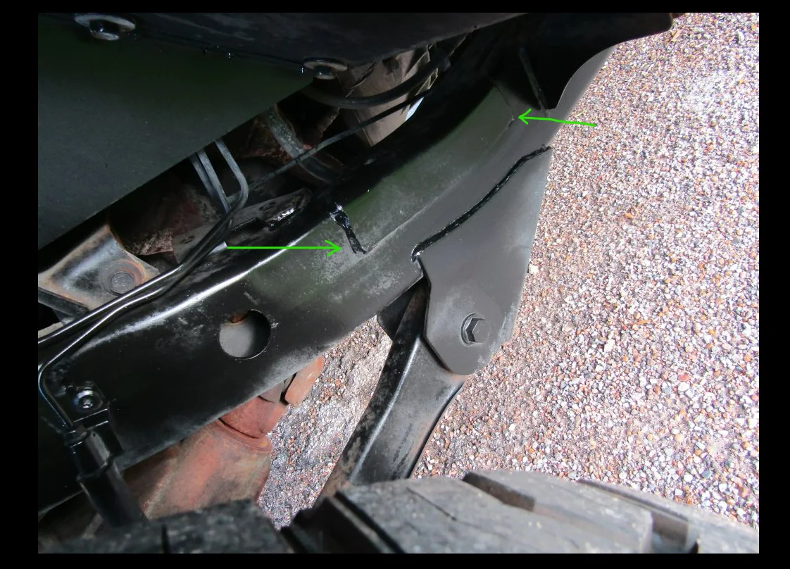

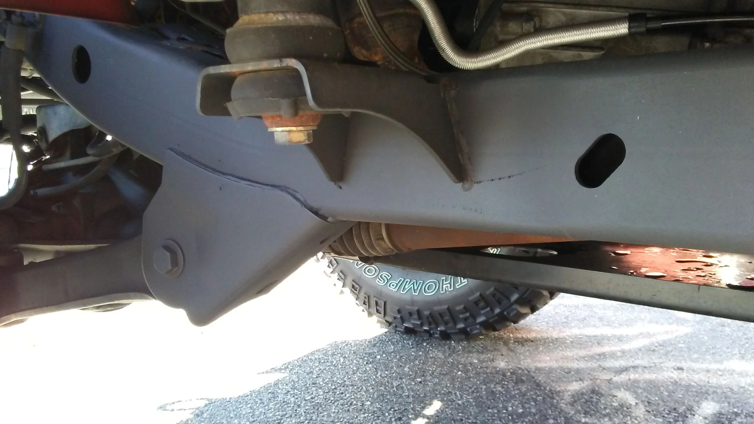

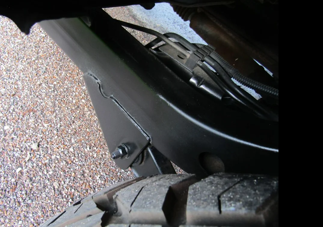

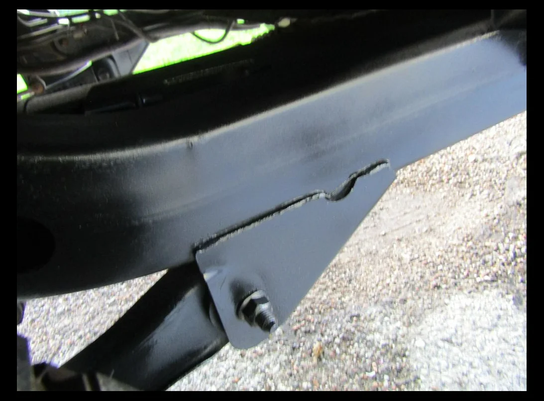

My friend is trying to get a TJ and this was the picture he send me. The frame is little wired. There is a velding or some sort of additional clamping. Could one of you take a sneekpeak and tell me what is that, a broken frame welded with a metal. Looks like the frame is repainted with black to me. Any help would be greatly appriciated.
No - not necessarily, this is on all LJs.
Super thanks brother, thats very helpfull..you are absolutyly right, it's an LJ unlimited. With you experience, is this a good frame ( I know it's a dumb question to ask), just looking at it

From those pictures it looks like the frame was spray painted. Could be no big deal, but if I was buying I’d be curious about what they were trying to cover.
Put fingers in those frame openings and feel for rust flakes. Better yet use a bore scope and take a look inside
Like these guys said, the devil is in the details. It looks oddly clean - but that isn't impossible, I do not see any obvious signs of rust issues that would make the texture poor; however a look inside will tell you everything you need to know about that frame.
Painting makes them look a lot better. I actually use a bit of high heat grill paint on mine. It’s not a shiny paint like that is. The dull finish looks more natural.
Like they say above, stick your finger in the frame holes and feel for flaking or take a wrench, screwdriver and tap on the sides and look for weak spots.
