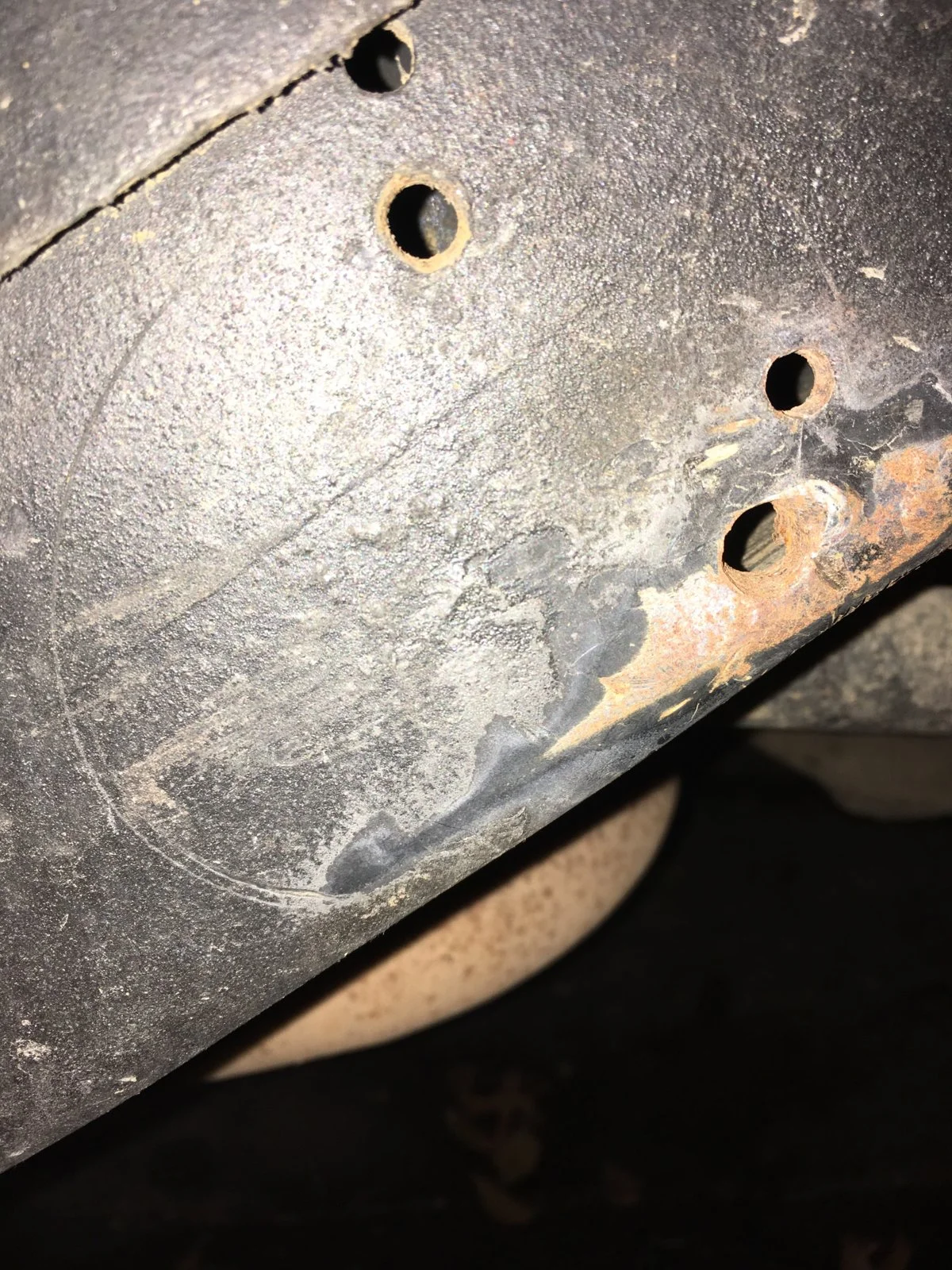

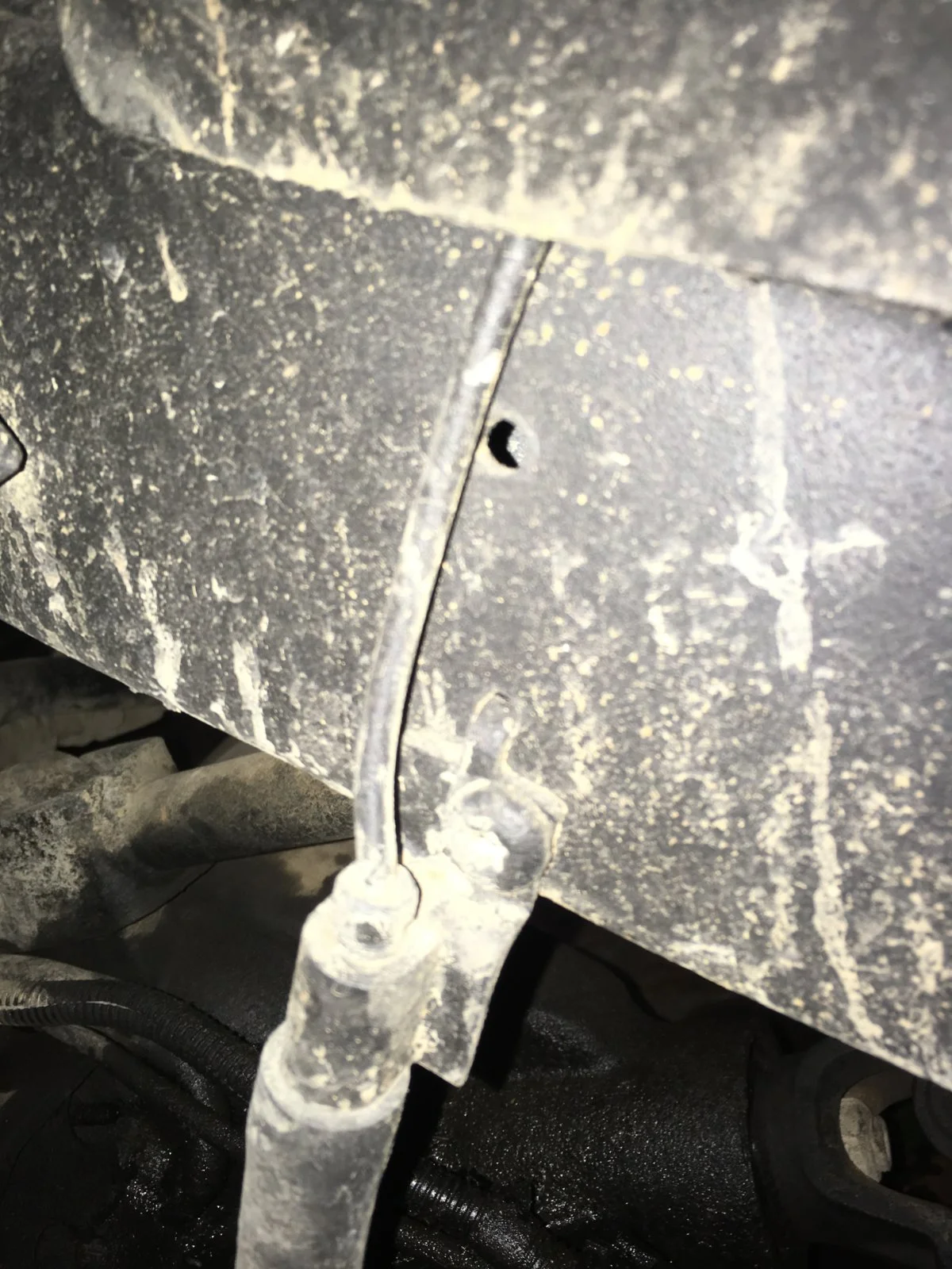

After much delay I am now in a position to do something about this problem.
Here are the pictures and one from the driver side.
I don’t have much confidence in my tapping ability so I’m looking to have a shop retap the hole thus making it larger.
From there I can either widen the hole for the bolt on the brake hose bracket or I could get a threaded insert and bring it back the the original size.
I would prefer the threaded insert simply so I don’t have to alter the bracket.
Ignoring the bolt hole all together I could reroute the brackets to the original positions. I would want to do the same on both sides so that would mean some real work to reroute the metal brake lines to match up with the other holes.
That frame screw hole is meant for a sheet metal screw, not a threaded bolt. I'd just step the sheet metal screw up by one or two sizes. You could also insert a nutsert and use a bolt but it's just holding the brake line bracket on.

If I could just drill in a self tapping screw that would be too easy! That hole is almost 3/8 when I’m looking against my drill bits and seems to be a very big size for self tapping screw.
I’m having a hard time finding the right size without digital calipers.
That said any tips for sizing, a recommended head type, etc ?
