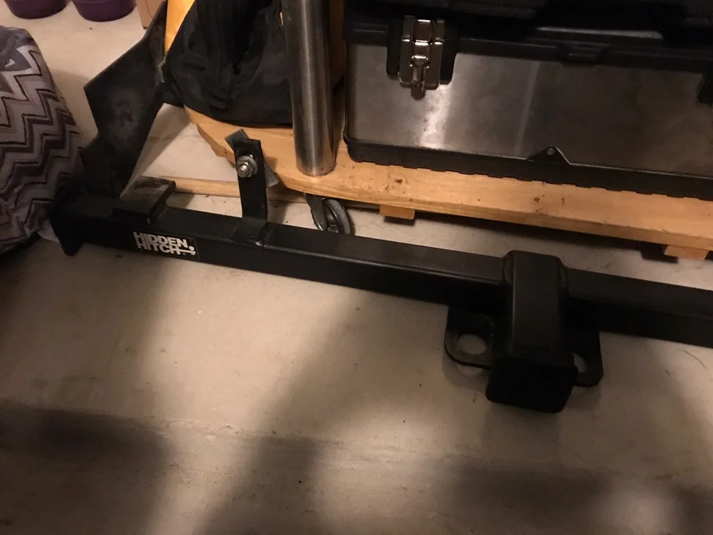

"Problem" #2 isn't exactly a problem but I do need some help. A friend gave me this:
It's a hitch that came off of his earlier year model TJ... I believe it's a 2000 or 2001. I can't figure out how to install the damn thing. It seems to have all the hardware and he said it will also use my existing bolts and that it should just "bolt right up". I consider myself pretty damn mechanically inclined and am embarrassed to say I can't figure it out.
Thanks in advance guys.
