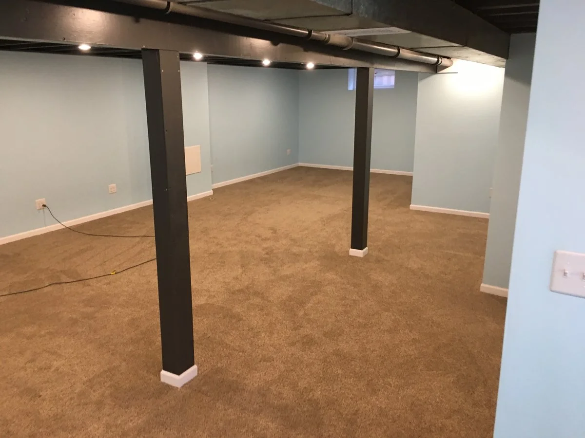

I haven’t decided if the drop ceiling will cover the beams or if we’ll use a wood facade to cover them, similar to what I did in our last basement:
Painting the ceiling joists and hiding the beam was mostly function: the ceiling was a little under 7’ high. I taped off pipes and HVAC ducts to retail their silver and copper colors. It turned out looking fantastic.

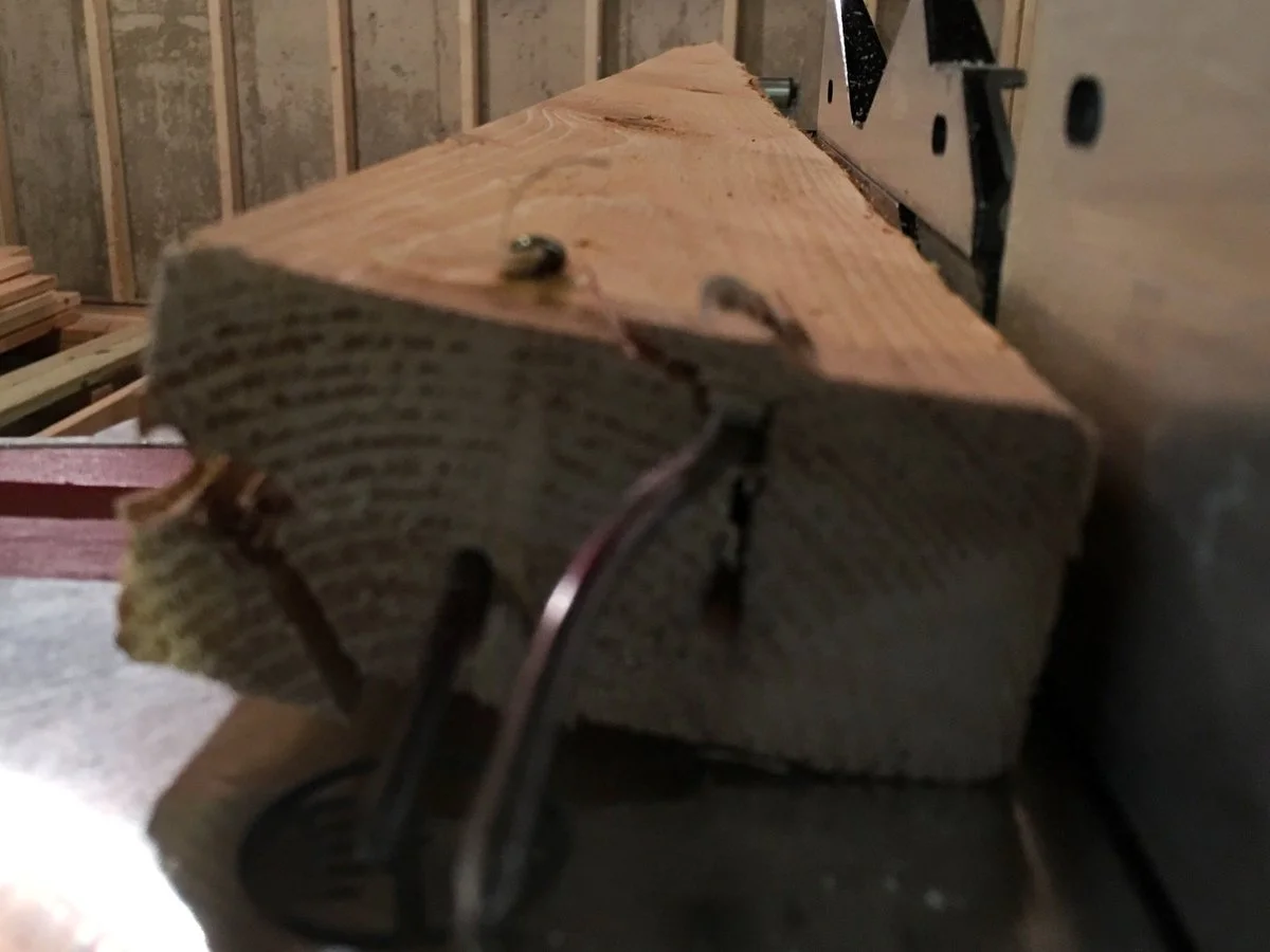

Warped, twisted wood sucks. This plank was part of the frame surrounding the staircase. I ended up burning a perfectly good stud on replacing this piece of crap.
The ends were useless; the stud had been toe-nailed into place. I cut them off and ended up using it as scrap. The shorter you cut it, the less the warp/twist will have an adverse effect. This specific piece had to be cut pretty small, but I was still able to make use of most of it.

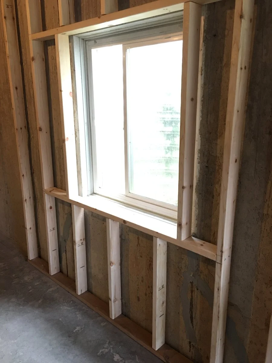

This was the last of three windows I had to frame out.
I thought framing windows would be the toughest part. As strange as it sounds, I actually enjoyed this part of the process — probably because framing a window was a process in and of itself. There's a beginning and an end. Being a gamer, I liken it to a “side quest”. I’m a little bummed I don’t have more of them to frame.
The speed square was a huge help in window framing. When you cut out the window frame, the studs you're cutting swing or sway out of position. Lining up the segments of studs that are left is vital. In holding the square in the corner between the frame and the stud, it's easy to ensure you have a properly adjusted frame, aside from the speed square's very many other assorted uses.

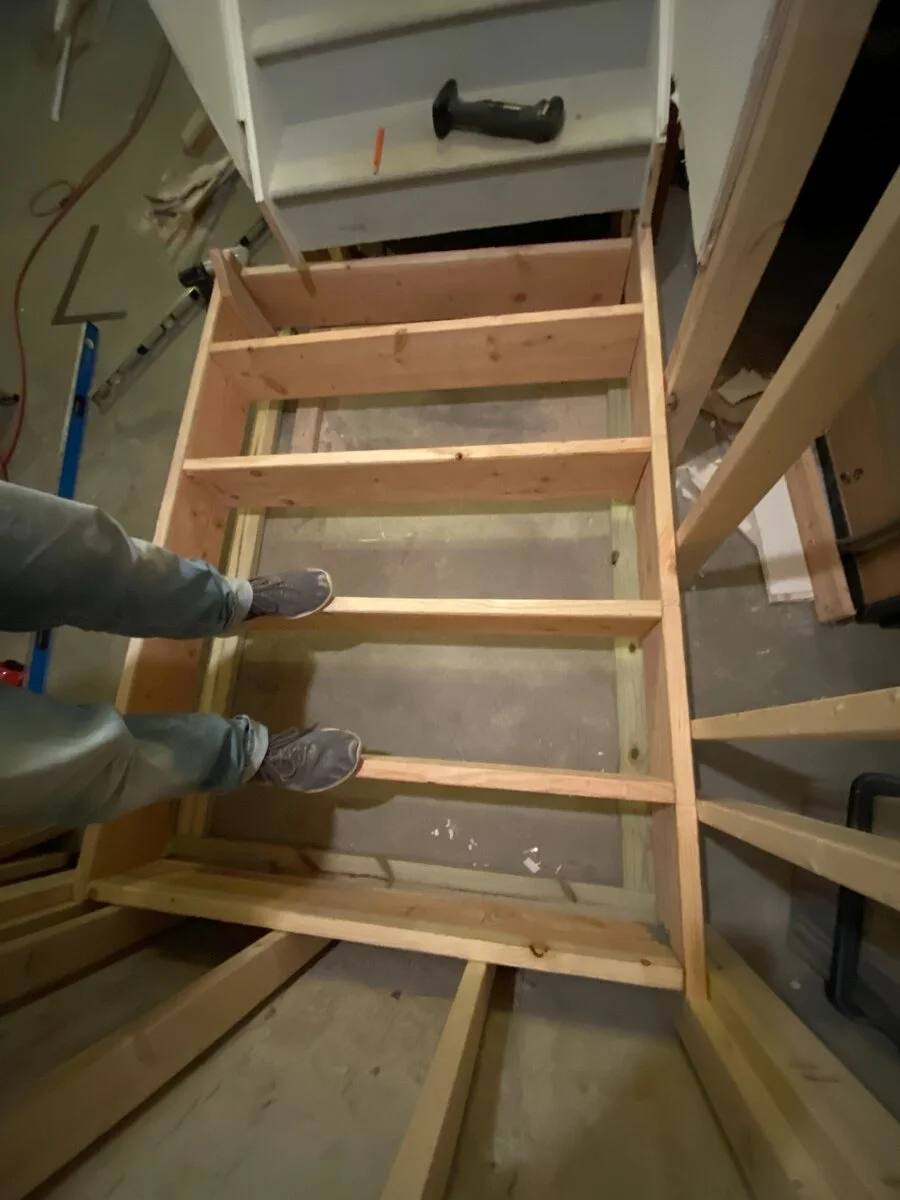

At long last, an update!
After lots and lots (and lots) of research, often followed by a disappointing lack of information, I found help in adding a landing to the basement stairs.
I have an above-ground sewer line running from inside the house through the foundation wall (this is a design that helps prevent flooding problems from the city sewer line).
The problem here is that framing out the pipe and the stairs only leaves a 30” opening between both. Additionally, the stairs exited towards an external wall; there’s a 180° turn to actually get into the basement from the bottom of the stairs.
This makes moving furniture and other large objects into and out of the basement extremely difficult, if not impossible.

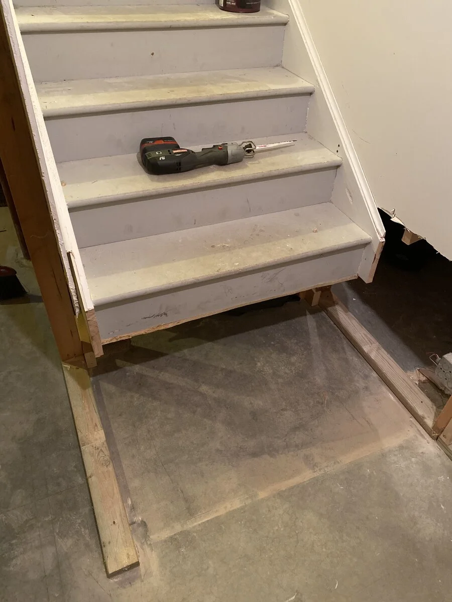

So I decided to add a landing level with the second step from the bottom.
I used my laser level to transfer the surface of the second step’s tread to the studs surrounding the landing. From there, I used my speed square to measure down 1”. Those lines would serve as the mark for the top of the landing’s frame. The inch space above it will be the landing’s surface.

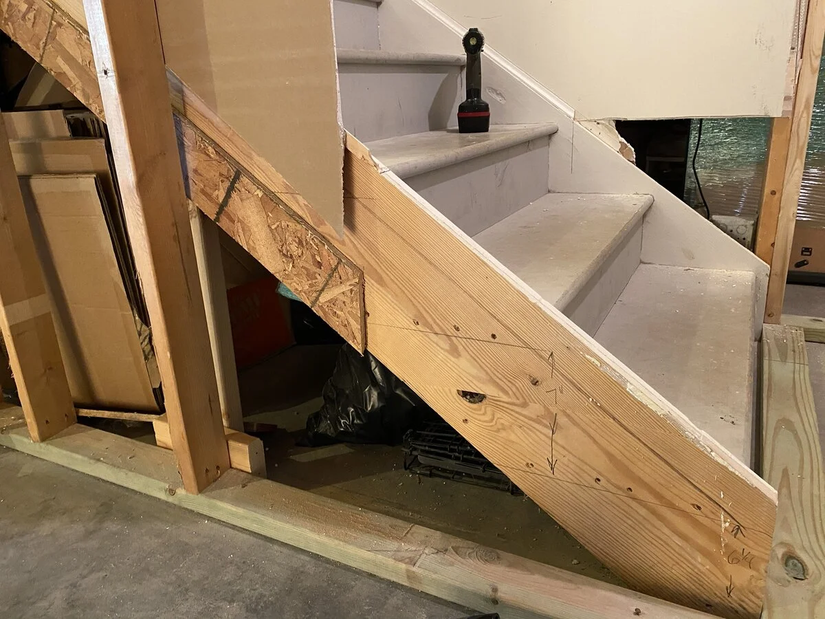

I transferred measurements from the inside of the stringers to the outside using a two foot level and speed square. In a nutshell:
1. The horizontal cut is at the same level as the top of the second step’s tread.
2. The vertical cut is 1 1/2” in front of the nose of the third step’s tread.
I had to clear out the drywall up to the third step in order to have room for my circular saw. I marked half an inch forward from the nose of the third step’s tread on both sides.
I added two sets of 2x4 studs for some additional support: two directly under the third step’s tread, two more about halfway up the stairs. All were secured to the staircase at the stringers: three construction screws at each contact point.
Unfortunately, I had a little more work to do.

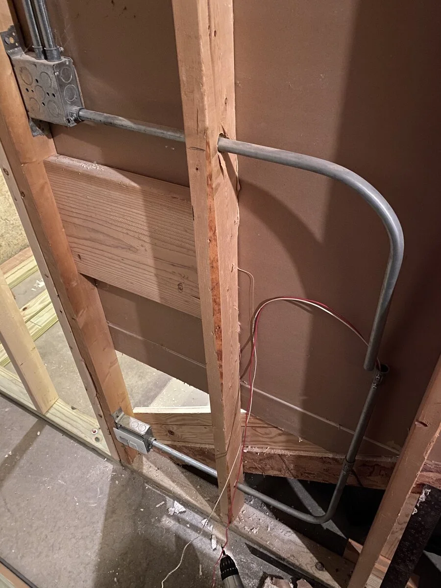

An outlet on the other side of the staircase would prevent me from making the appropriate cut.
After about 30 minutes, I was able to remove the wiring and conduit. I made a cut along the stud in the way, removed the bottom, cleared out a little more drywall (right at the joint), and was cleared to cut.
VICTORY!
The circular saw chewed right through the stringers with no issues. The second step’s tread was nailed to the third step’s riser with several nails. I used a sawzall with a wood/nails blade to cut through the nails.
Since the stringers w rest on the landing, I had to make a cut along the bottom of the third step’s riser in order to even it out. I used my Dremel Saw-Max to make that cut.
Finally, some landing joists going in. The only joist I haven’t attached yet is under the stringers. I was able to level out the landing framing pretty easily. It made attaching the joists a lot easier and faster. I squared up the contact points using my speed square and attached everything using 2 1/2” construction screws.
The landing passed the 225 lb. Irish Jeeper test with nary a creak! Success!
