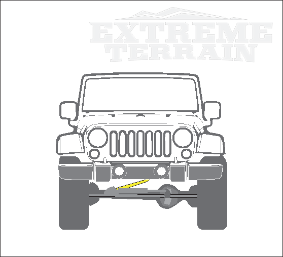

Ever notice a pick-up or any vehicle going down the road and the body is not in line with their momentum of travel, or maybe they're experiencing the death wobble which looks like the wheels and axle are about to shimmy their way from the vehicle? This typically means that something is up with the track bar; worn bushings, poor installation, damage, age, wrong length, etc. The Wrangler's track bar is what maintains the axle’s perpendicular alignment with your Wrangler when viewed from the front or rear. Without it, your axle will not be tame and may drift off to one side or the other, causing steering issues.
If you feel like your Wrangler is “drifting” while going down the road “straight” it’s a good idea to check out the track bar. Get under your rig and inspect the bar which is attached to your axle and is parallel to your axle shafts. Check for cracked bushings, physical damage, looseness, etc. Maybe you installed a lift and you now realize your Jeep looks laterally offset when looking at it from the front or rear. A longer track bar is necessary to fix this.

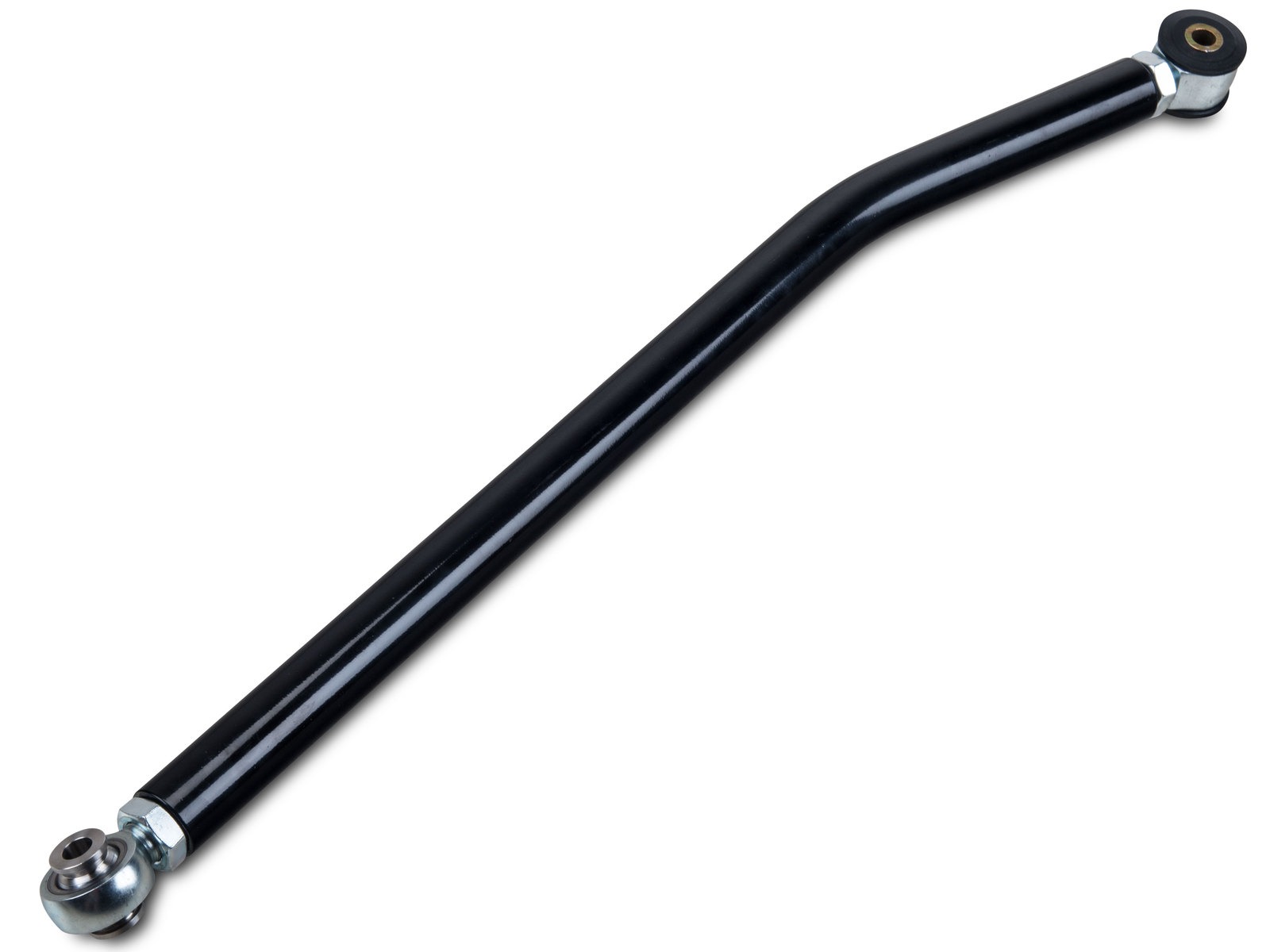

Are Wrangler Track Bars Adjustable?
The factory track bar on a Jeep Wrangler TJ is not adjustable. Almost all aftermarket track bars however are adjustable. Adjustability is almost a necessity, especially on lifted Wranglers, to finely tune in the track bar length to perfection and get your axle centered. Lifted Jeeps require longer track bars while normal Wranglers can stick to the shorter regular bars. Make sure you get the right track bar length/adjuster that is compatible for your lift size.
Adjusting and Measuring Made Simple
After removing the old track bar and before installing the new one, you need to center the axle. It helps installation a ton. Shove your rig to the side that you need it to move, again usually push towards the driver side from the passenger side. If necessary rachet strap it, disconnect the sway bar links, and lift the axle or carefully have a buddy steer the wheel for you in order to temporarily get everything lined up. If you choose to use the steering wheel trick, your wheel might be off center when final assembly is done. Don't forget the torque specs and grease everything up when you’re done.

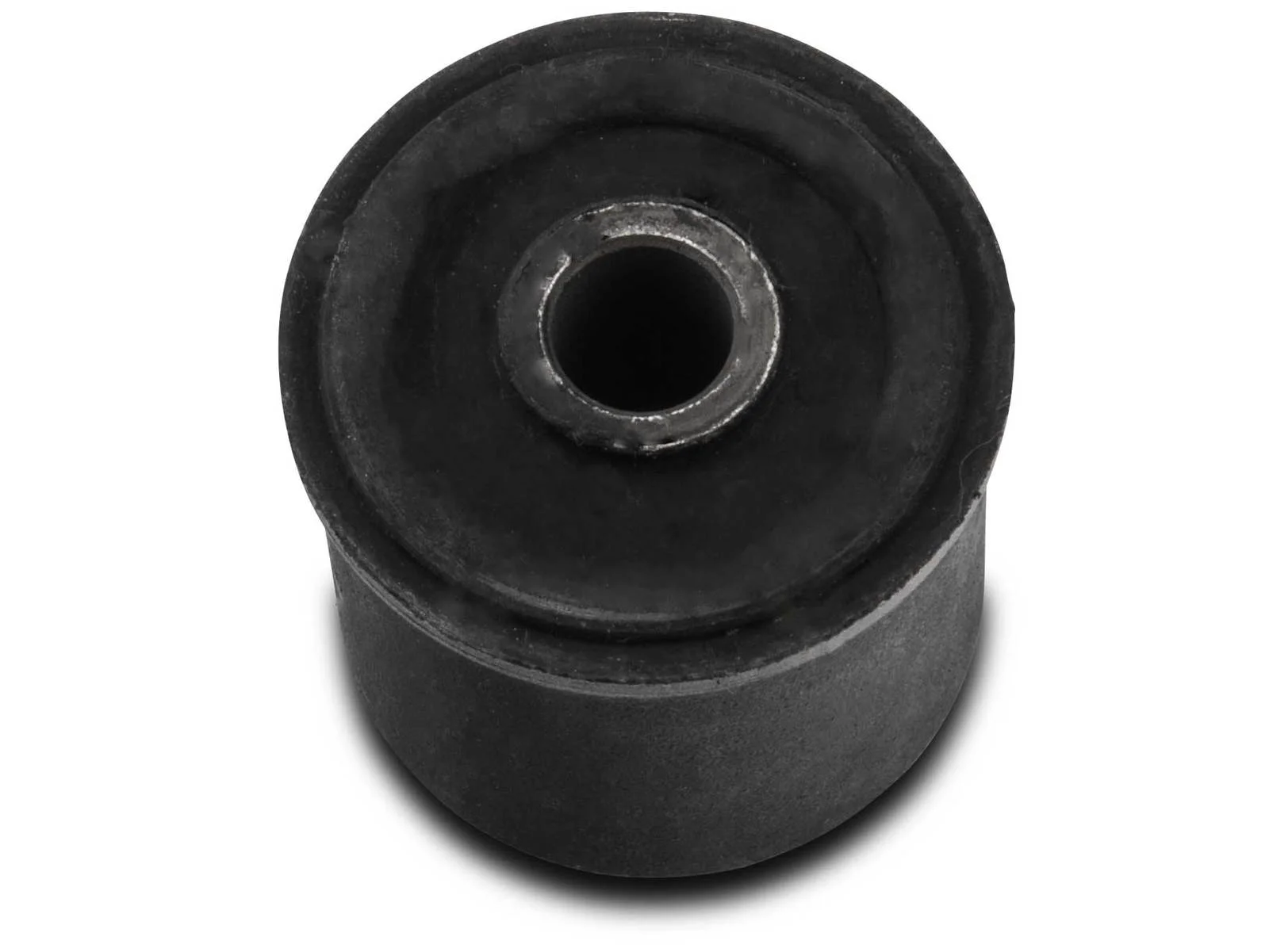

Wrangler Bushings
The bushings, usually polyurethane, are made to preserve the track bar, allowing some flex between the collar and the track bar. If your bushings are old and dry rotted, they will not be doing any good. The bushings may provide excessive flexing of the track bar and cause the dreaded death wobble.
Preventing Wrangler Death Wobble
The Jeep Wrangler death wobble refers to a vibration that can be caused by your track bar bushings, collars, or brackets which makes the axle want to free itself from your Wrangler. Check out the track bar bushings. If they are in poor condition, replace them. If your bracket is loose, tighten it to the suggested specs. Now if both are in perfect condition, check out your lug nuts and studs. It’s a possibility that the lugs have come loose and have given you a similar concern.
