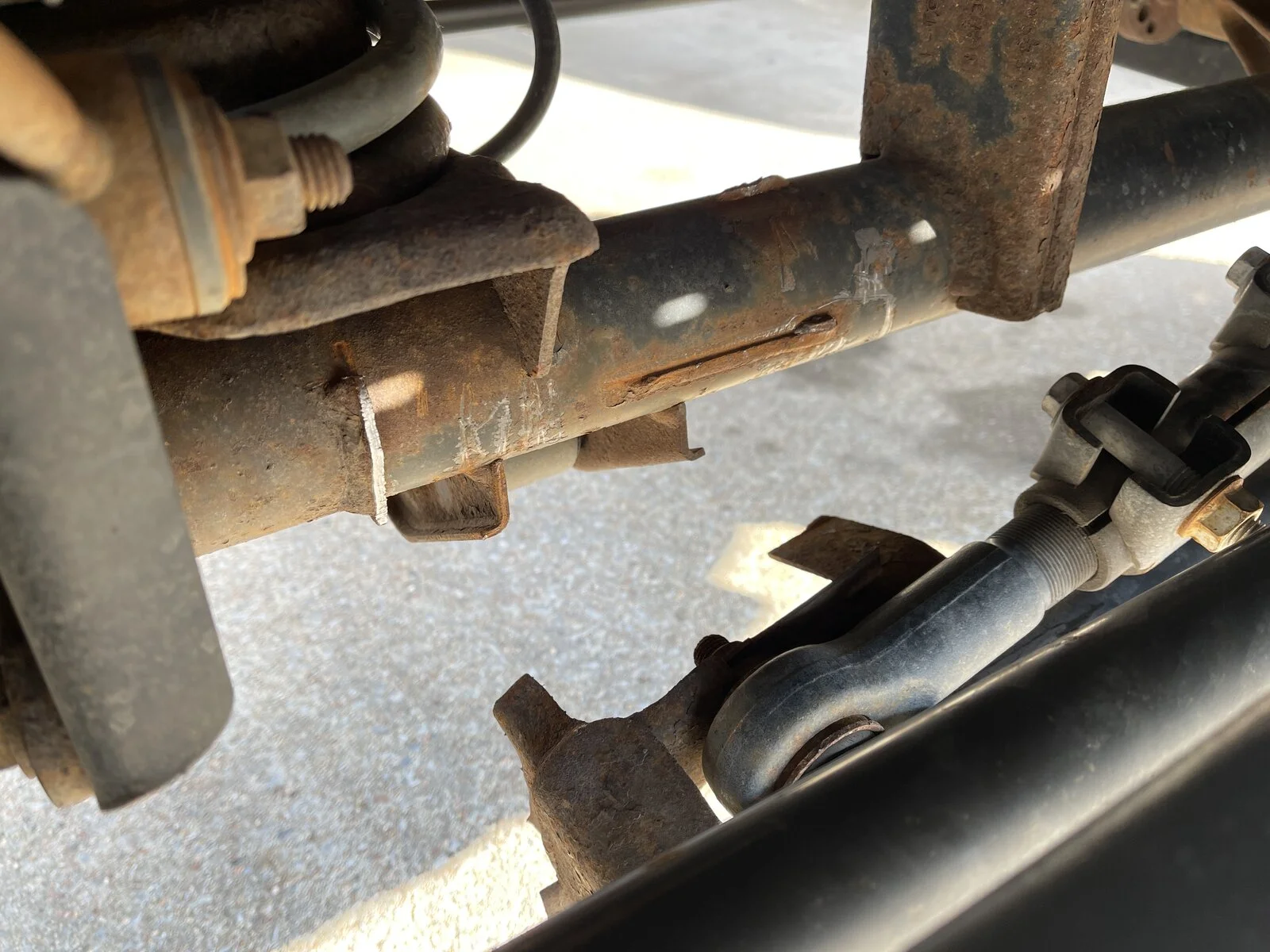

Jeepr89 Member Joined Nov 16, 2020 Messages 67 Location Lincoln, NE Feb 16, 2022 #1 What is the best replacement bracket for a broken axle side track bar bracket on a JK. I measured the front springs to be about a 4in lift. Thanks

B00mb00m The Church of Cutting Brakes of Atlas-Front Digs Supporting Member Ride of the Month Winner Joined Jul 26, 2019 Messages 3,498 Location Washington Feb 16, 2022 #3 Jeepr89 said: What is the best replacement bracket for a broken axle side track bar bracket on a JK. I measured the front springs to be about a 4in lift. Thanks View attachment 310047 Click to expand... Cut some flat bar with and angle grinder and use a welder to glue it back on.

CharlesHS TJ Expert Supporting Member Lifetime Supporting Member Joined Mar 10, 2020 Messages 5,586 Location Jacksonville FL, Quezon Philippines Feb 16, 2022 #4 Jeepr89 said: What is the best replacement bracket for a broken axle side track bar bracket on a JK. I measured the front springs to be about a 4in lift. Thanks View attachment 310047 Click to expand... Doubt it's the best, but in these times of parts availability; this one is available. https://www.4wheelparts.com/p/2014-...wOWOYaLF6iZ9u4IetLrzlCuRQSEA-kNUaApg1EALw_wcB

CharlesHS TJ Expert Supporting Member Lifetime Supporting Member Joined Mar 10, 2020 Messages 5,586 Location Jacksonville FL, Quezon Philippines Feb 16, 2022 #6 Jeepr89 said: I’m not a JK owner it is in our shop for repair just hoping someone had an answer without joining a forum for a platform I don’t own. Click to expand... https://www.extremeterrain.com/arte...HDrf5RBumSuqZL2YJ5kaAmWCEALw_wcB&gclsrc=aw.ds Welding to the existing broken pieces on the axle tube; you may crystalize and harden the surrounding metal causing to break off again at a later time. Probably better off replacing the mount.

B00mb00m The Church of Cutting Brakes of Atlas-Front Digs Supporting Member Ride of the Month Winner Joined Jul 26, 2019 Messages 3,498 Location Washington Feb 16, 2022 #7 Jeepr89 said: I’m not a JK owner it is in our shop for repair just hoping someone had an answer without joining a forum for a platform I don’t own. Click to expand... I wasn't being facetious, just mimic the OEM mount but with 3/16" mild steel, you probably have it in the shop?
