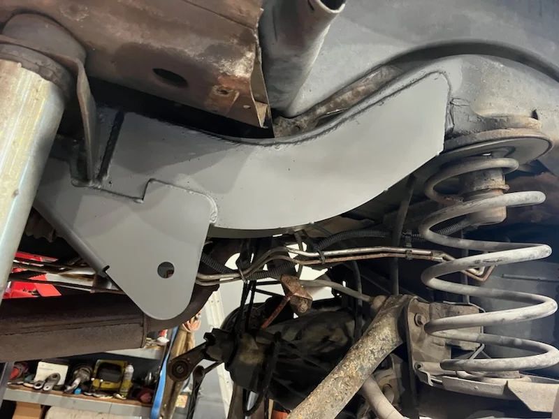

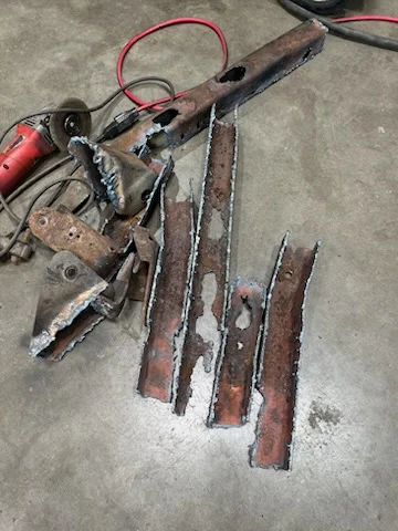

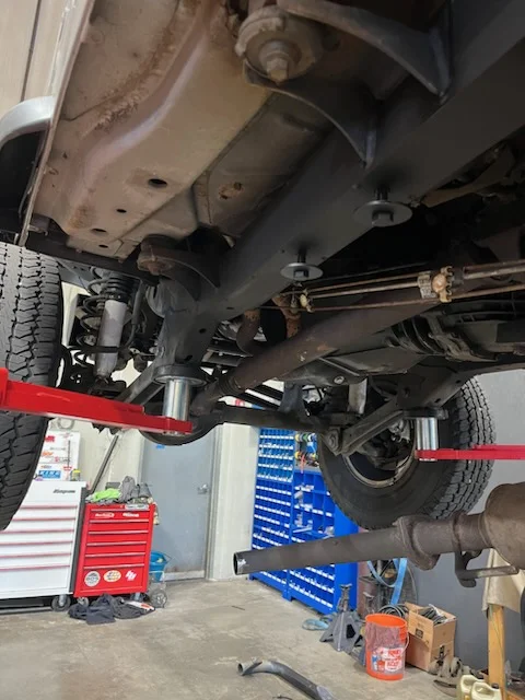

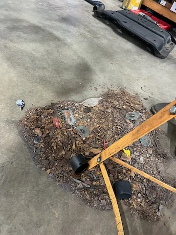

I have issues with the body mount rails to work out. Both sides under the doors are rather rotted away. For now I just wanted to freshen up the springs and shocks. I am not able to get into the serious lift until I can get the body mount issues corrected. I just had the framework done and that was a good chunk of change.
