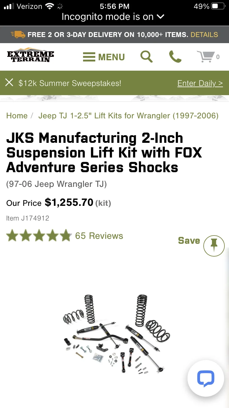

Does anyone have experience or input on the JKS 2" inch lift kit with fox adventure shocks? I am looking to install this kit with 31 inch tires on stock 15" wheels.
I might add that I want to try & maintain the good ride that it has right now. I am thinking about going with the Firestone destination X/T. No off roading.
