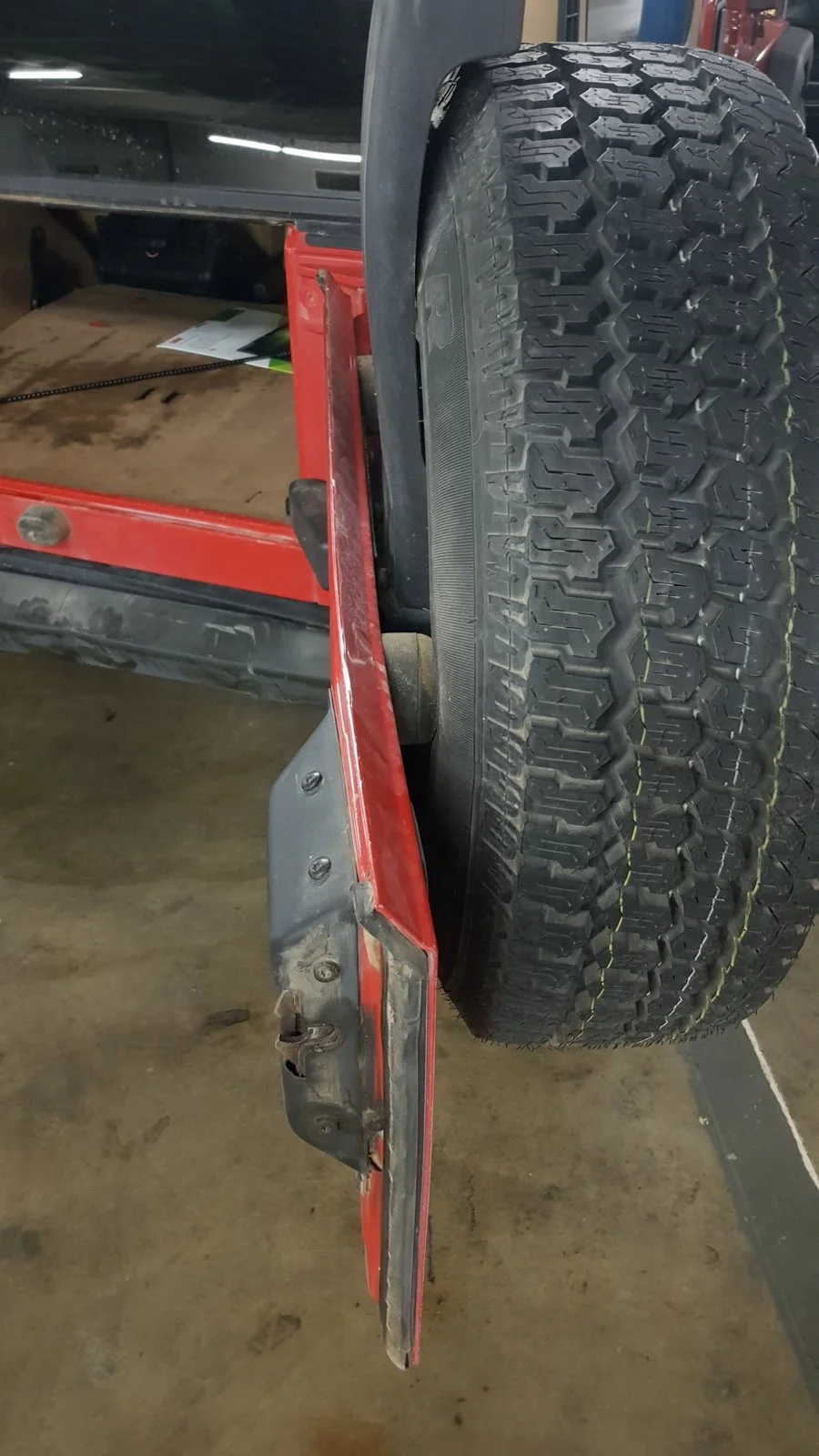

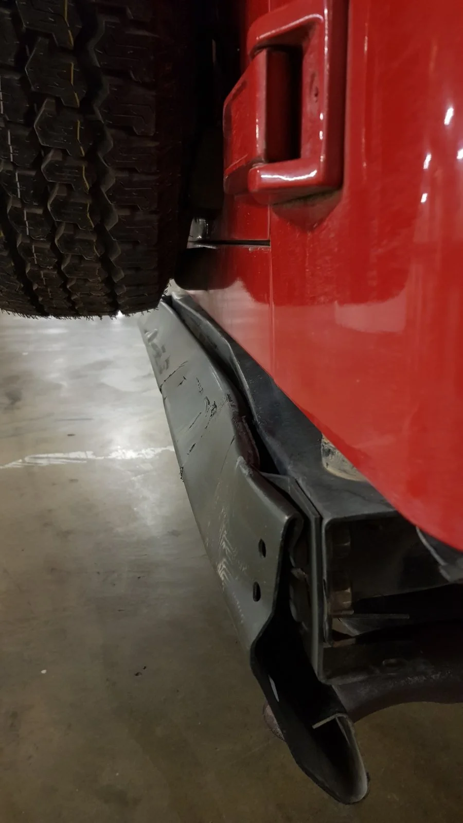

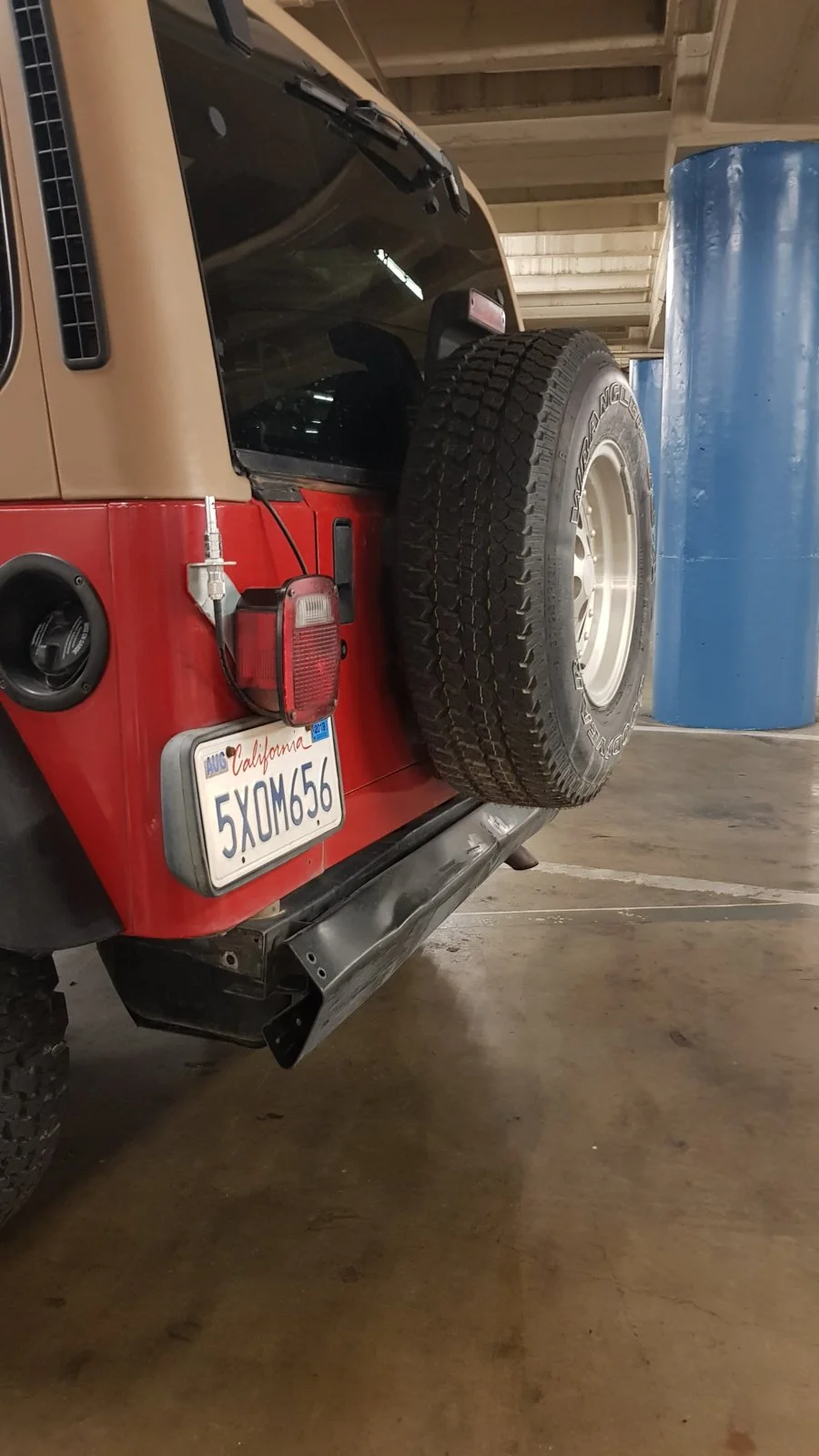

Hey Guys and Gals,
I just got rear-ended on the freeway going to work. It was a pretty strong blow. The girl was probably texting since she was coming in hard at me when I and all the lanes were already at a full stop and not just stopped... but that is for the insurance companies to talk about. I took a couple of pictures of the damage to my TJ. Take a look and tell me what you think. It drove OK after the impact, though I now have what it sounds like control arm bushing noise from the back or maybe the sway bar links in the back...not sure.

That's not terrible. You'll need a new tailgate and a little bit of work on the rear frame, but it's not bad.
A body shop should be able to fix that pretty easily.

Looks like you need a new tailgate, bumper, and some rear frame work. In terms of frame work, make sure you go to the absolute best body shop you can. When it comes to frame straightening, you definitely don't want some joker yanking on your frame with no prior experience.
Before you do anything, make sure the frame is straight. If it is diamonded or tweaked, you need to make sure that is fixable before you do anything else.

OPINION*******I highly doubt that the side rails of the frame are bent. The rear frame cap will need to be replaced along with the rear gate. And possibly the rear tire hanger. And some paint.
FACTS***** use the body shop YOU want. Insurance companies CANNOT make you use their preferred shops.
Let the body shop tell you the damage. That is their job.
Tell them you want the alignment checked. They should already be doing it. But not always.
