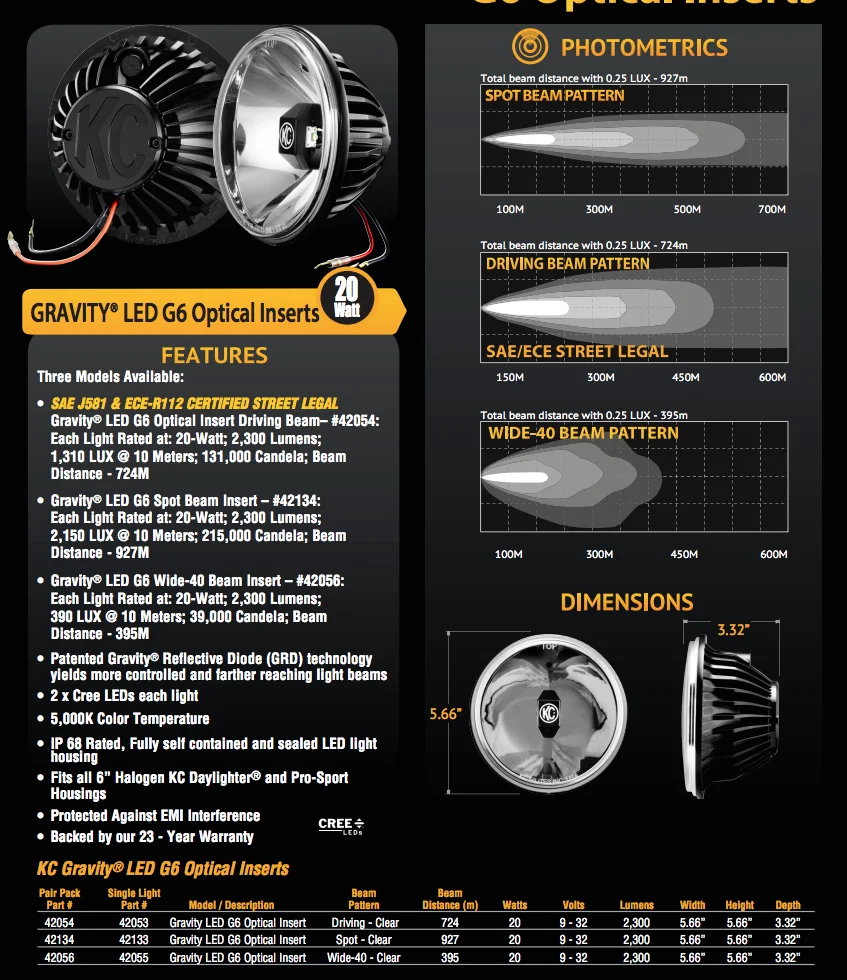

One of my KC Daylighter Halogen lens cracked so I was interested in replacing with the Gravity LED inserts. I was curious if anyone had any experience with the Wide 40 beam vs the Driving beam. I use them mainly for country backroads and dirt roads. On paper the Wide 40 seems to be a good mix of the distance of the Driving beam and the width of the Fog beam, but I have not really been able to find much in Googleland to compare them. The only video I've found so far show the driving beam had pretty bright hot spots, but I couldn't really tell if they had good fill.
Thanks
