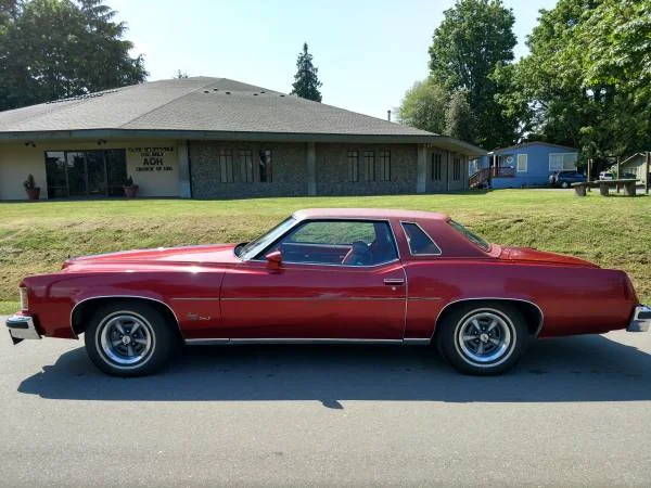

I had a '77 GP, too. Dark silver/gray with black leather interior, and T-tops. Fun car! But I digress. I never though about the "smaller target", as I believe the law here in Washington says they have to have covers on them when not in use off road (that is to say, must be covered when being driven on public roads). I'm not absolutely certain that's true, but it's what I've been told for years. Also, I like round lights better, though KC does make some round LED lights, as well. Thus far, my only experience with LED headlights was on my Mazda, and I loathed them. $100 for two "bulbs", and I swear my eyes never got used to them. I'd be afraid to spend the coin on some off road lights, only to hate them.

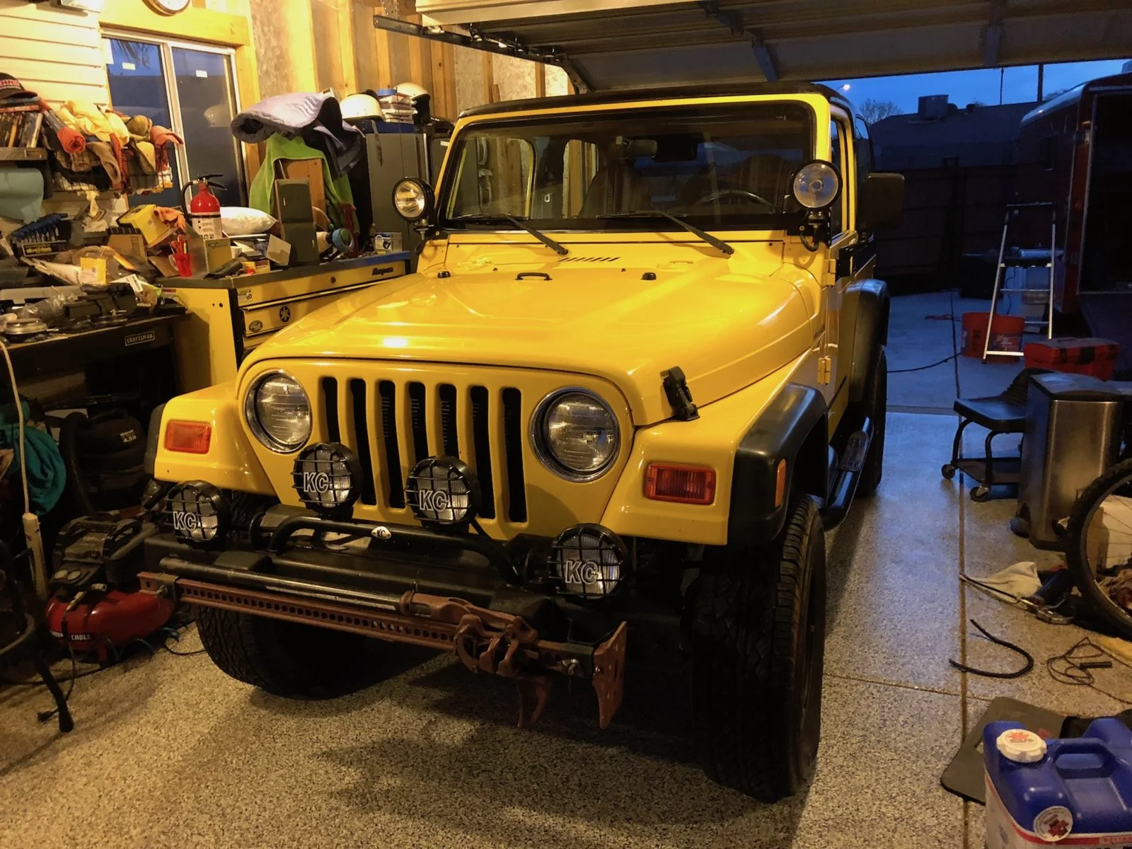

Judging from the massive mounts, I'd surmise that Zombicon has Daylighters, and the ones mounted on the yellow one's windshield frame are also Daylighters. But what are the one's on it's bumper? Are they Slimlights? Also, do you know what brand the windshield frame bracket mounts are? Are they also KC, or something else?
I think you guessed all of the lights right, I will look tomorrow, and see if I can find anything on the brackets her Jeep came like that.

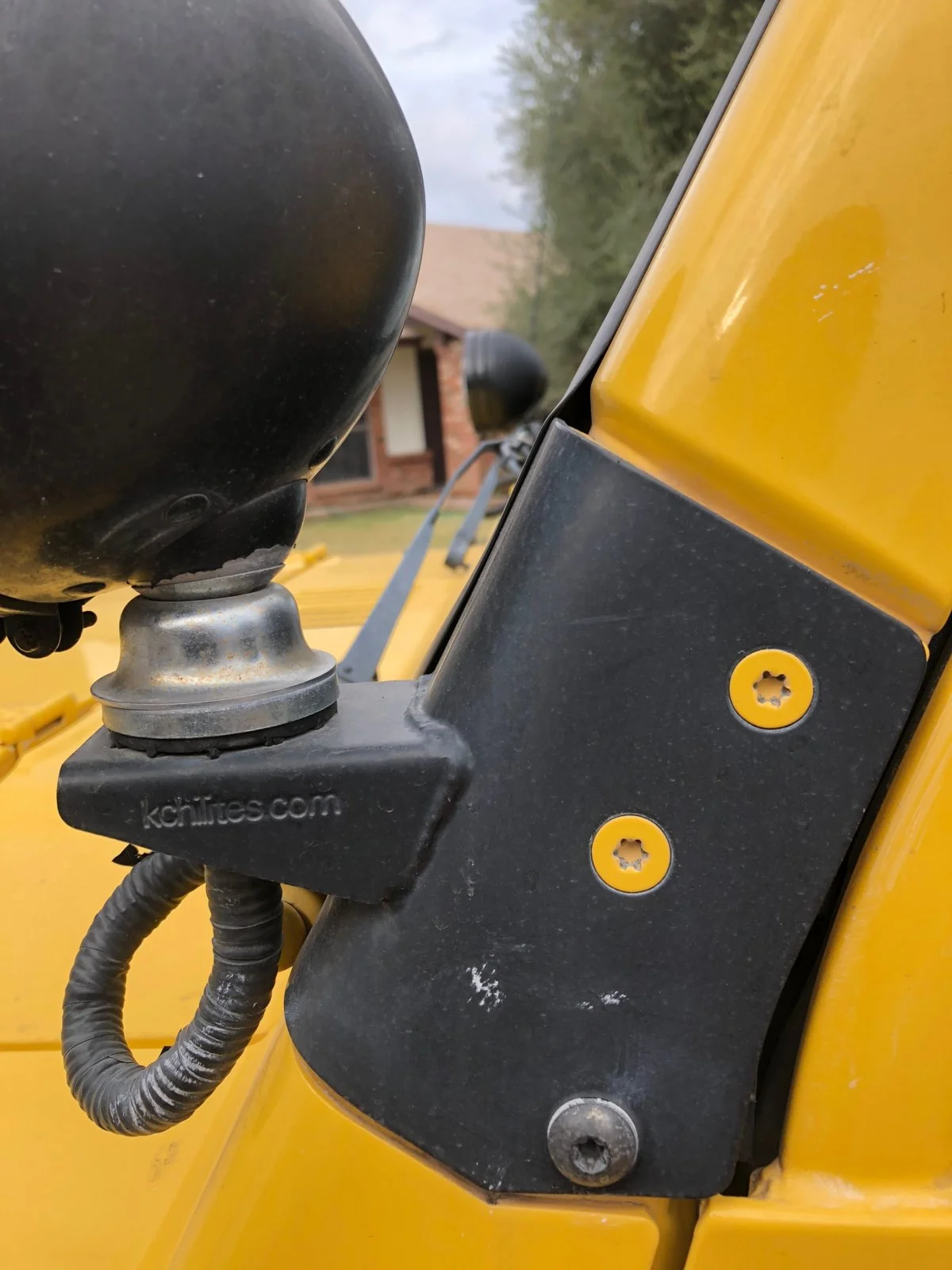

I found this on the bracket.
75648
Looks like these are them:
http://www.kchilites.com/tj-light-mount-brackets-97-06-jeep-wrangler-7311-black.html
Reactions: Squatch

Cool. Thanks, Chief! KC's description never says which lights could be used with those brackets, and I was uncertain if the Daylighters had a larger mounting system that wouldn't allow them to be used on those brackets. Guess I should have known better. Thanks again!
