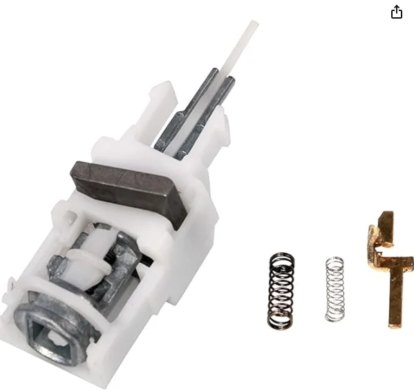

I'm a little confused as to what I need to actually replace. The ignition lock cylinder or the ignition switch, or should I do both while I'm in there? It's a 97 automatic, never given me the tiniest bit of trouble starting up before now.

I hadn't tried it the other way I don't think, but I have a new tumbler (and actuator) on the way.
Matching a new tumbler to the old key is pretty simple.
Reactions: freedom_in_4low
Only three parts to it. Take off the electrical switch and turn,then the actuator,then the lock. My money is on worn out key and tumbler assembly

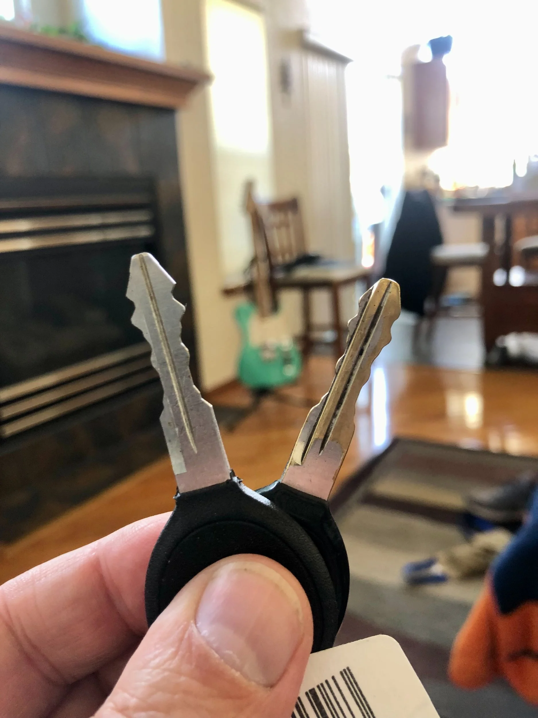

I had a similar problem. Key would need to be jiggled occasionally to start. I thought it was the tumbler assembly because my spare key (which I thought was an original) didn't work either. I went to the dealer and had a key cut from the VIN and it works remarkably well. The spare key wasn't an original and was a copy from a worn original and when I compared the key I used everyday to the new one, I was shocked at how the key was worn down.
FWIW: It happened to me before a few years ago. A stop-gap hack until you install the new components: with the key in, hit the end of the key with the palm of your hand once or twice. At the time I was absolutely convinced I needed a new lock cylinder. I never did replace the cylinder (but have one on standby just in case) Hasn't done it again since. 🤷🏻

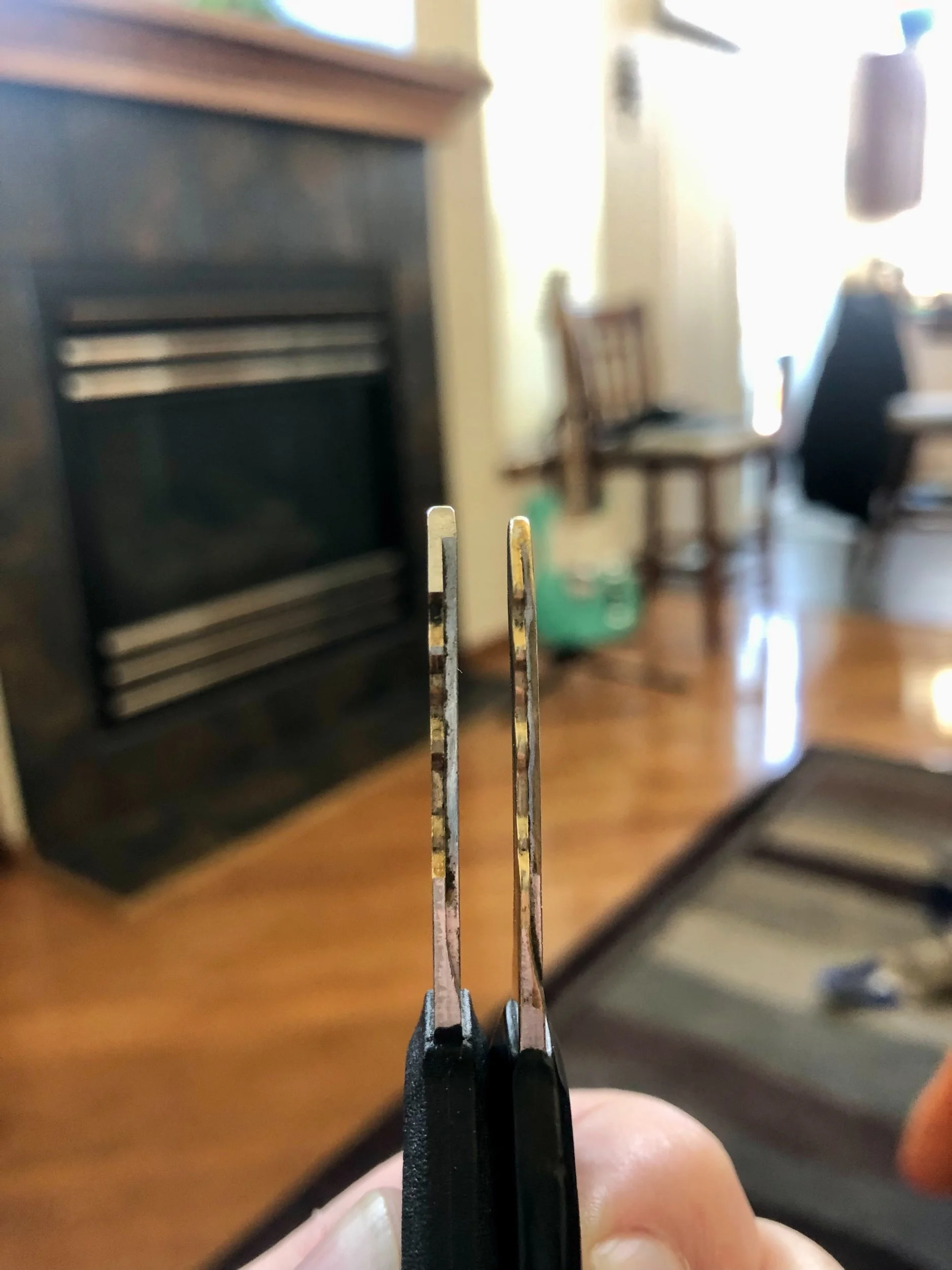

I had the exact same situation. Starting my Jeep was getting trickier and trickier over the past several months. Then, it dawned on me that I've been using the same key for 20 years. Having bought my Jeep new, I still had the other original key, so I compared them.
Mine was also totally worn. I was most surprised at how much thinner the used key was than the unused key. I tried the unused key and the starting issues completely went away.
I immediately drove to my local Ace hardware and had 2 keys made off of the unused original. I am now using one of the newly made keys without issue. I figure I'll always use a copy going forward, saving the good original to make additional copies if necessary.
My keys are all worn way down, a new one cut from the vin would be awesome. I think mine actually look worse than @Murf926's.
