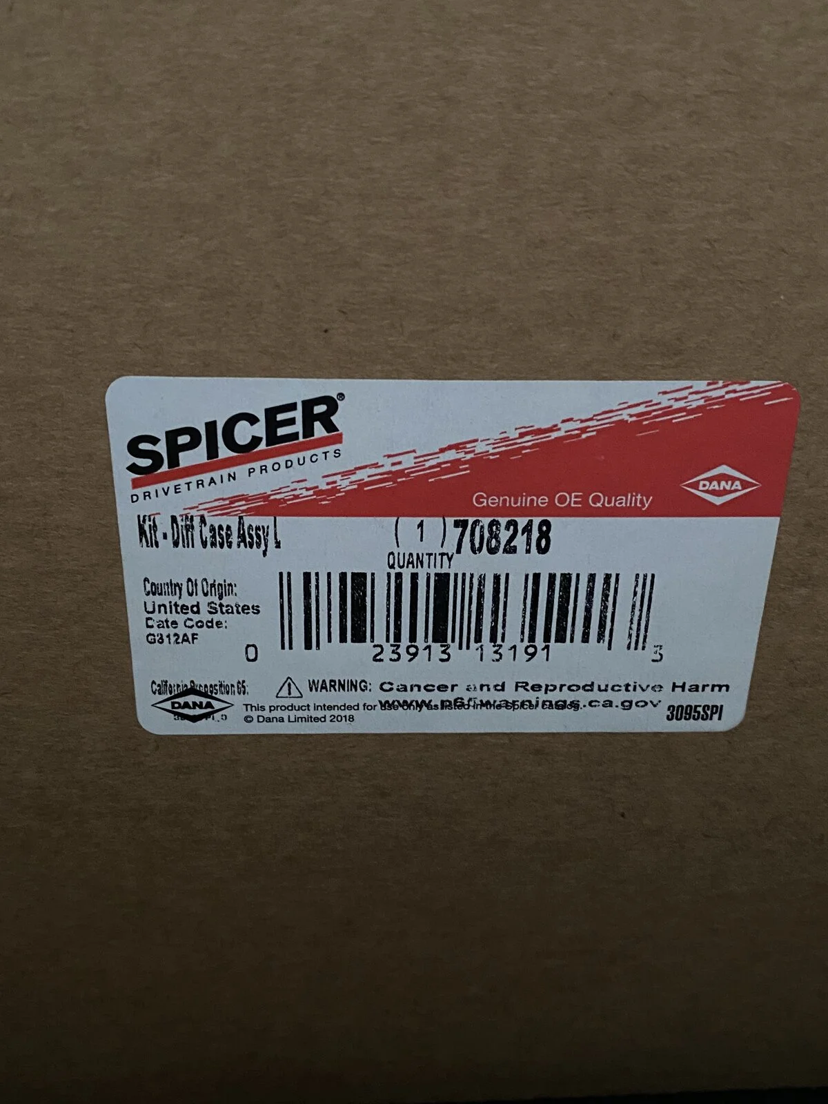

I had the same issue months back. I chased it for a long time and would hear it at low speeds and especially while turning left. It ended up being the clutch packs in the LSD were bad. I ended up just swapping out the whole unit itself instead of just replacing the clutch packs. It was a little more expensive replacing the whole LSD but it saved a huge headache by trying to get all the clutch packs stacked together properly and installed correctly. It was an easy swap out because I used a Spicer unit, which is what came from factory.
I bought it from Summit Racing but it looks like the price has gone up by almost $100 since I bought mine 6 months ago.
Wait... So you replaced the entire carrier? Did you set the gear backlash or just bolt in and go?
It wasn’t too bad but I had the pleasure of doing it at my buddies house who is a CJD master mechanic and has all the tools and know-how. Like mentioned above, checking and resetting (if needed) the backlash once the unit is installed is one of the most important processes. I suggest if you are looking to replace the whole LSD, do plenty of research on the process.
